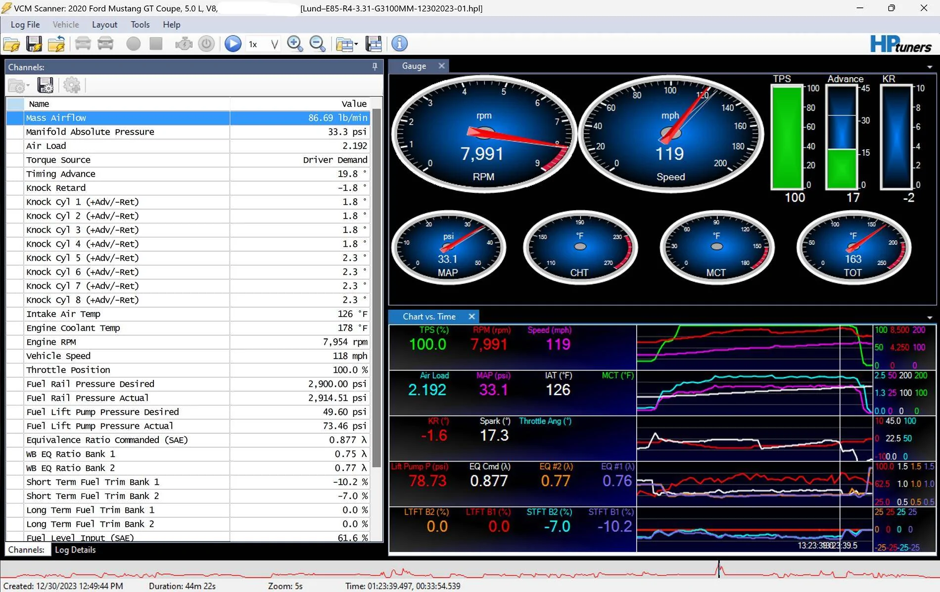

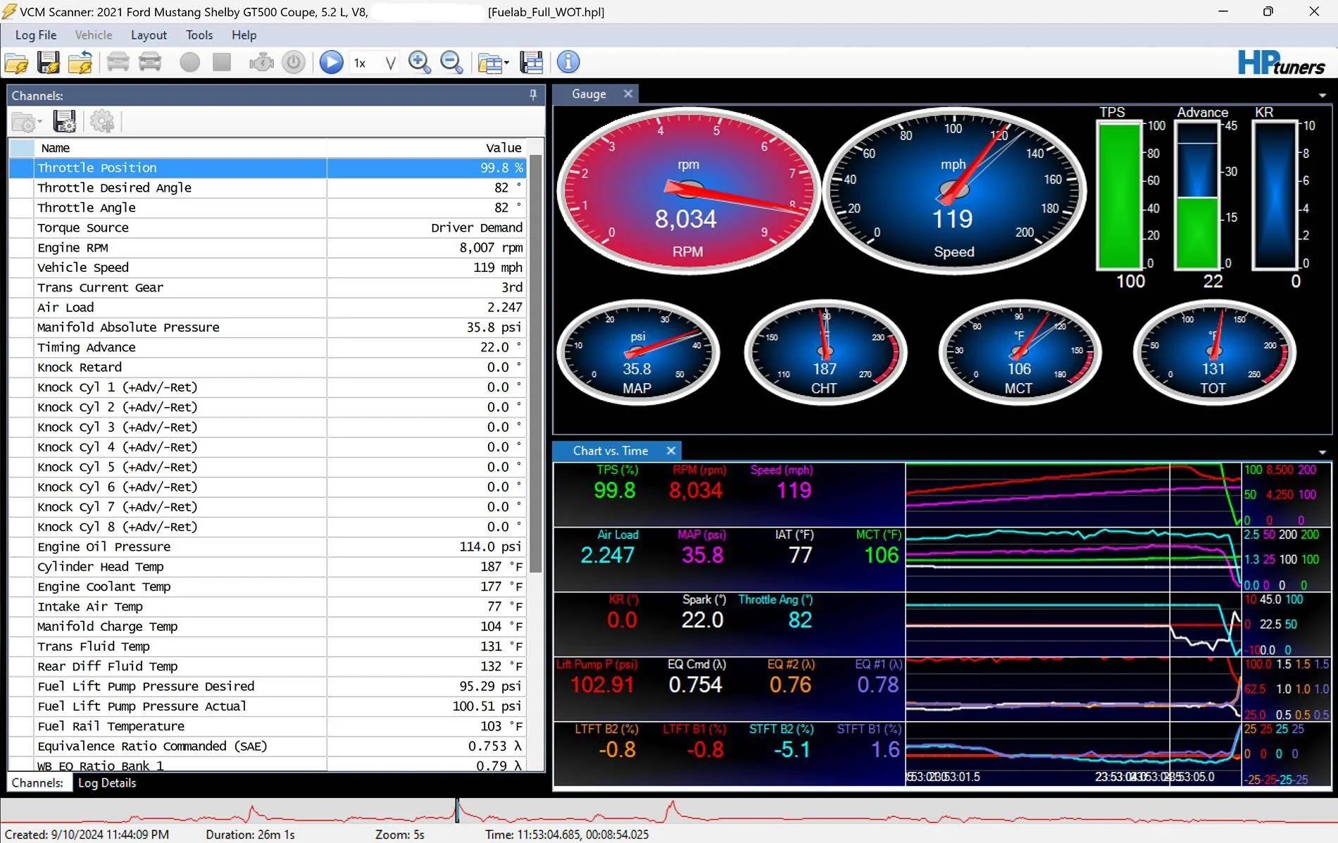

@Wolfys11 I can corroborate the logs from @engineermike
I had an ESS G3 with the 100mm pulley on E85 making 15 psi at 7700rpm at about 870whp.
Currently have a GT500 on E85 making 21 psi @ 8000rpm at close to 1000whp.
This is a log for the G3 with G3 intercooler and opened up grille. 60F ambient, 30% humidity (December in Texas)
Start - end speed: 70 - 120 mph
Start - end charge temp (IAT): 86 - 126 F

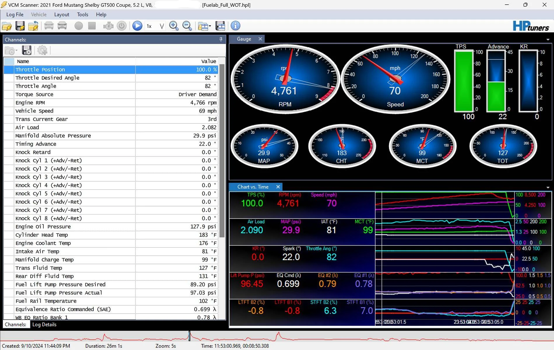

This is a log for the GT500 with the stock TVS2650 supercharger and VMP intercooler. 77F ambient, 88% humidity (Summer in Texas)
Start - end charge temp (MCT): 99 - 106 F

G3 at 870whp on a g3 intercooler is a huge cause for the issues, meanwhile the gt500 has an upgraded intercooler for the stock supercharger. I can look at a log for wengered at some point this week to see for myself what my system is running, but a g3 to a g4 intercoolee is a substantial difference for air to air cooling
if its 20 degrees above ambient from the start of the log, your log already is showing a lot of heat for the temperature in my opinion
So my ESS was heat soaked? I thought they don't heat soak? Lol
The point was to show the rise in temperature over a similar pull 70 - 120 pull for PD vs Centri and show that you can setup your cooling to handle your heat output irrespective of Centri vs PD.
The G4 intercooler has better cooling capacity than the G3 but no, it is not a "substantial" increase over the G3.
