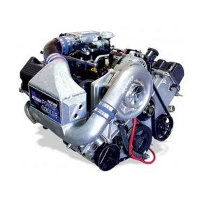

Also, Vortech has used air to water in their 4.6/5.0 centrifugal Mustang kits for YEARS
Centri setups dont commonly use water cooled. Keyword commonly, one example hardly makes your argument

If thats the case, and the pd is more thermally effecient, then how come every single pd system today uses a water cooled system, usually paired with ice boxes built in, which you claim is in every way better than air to air, and all our 3 centri options dont even consider a water system?

That's actually a pretty common setup for those cars. Ya ain't seen many Mustangs have ya?
The 2 generations of one car, 👏🏻
You have proved it is a common setup compared to every other centri setup using air to air, especially the car this post is for

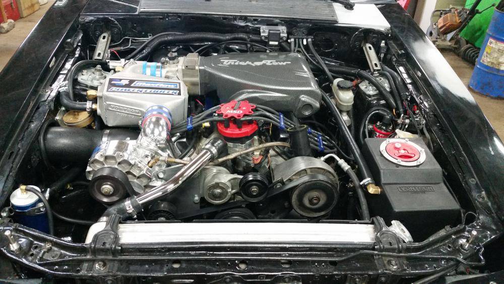

One word, packaging.
