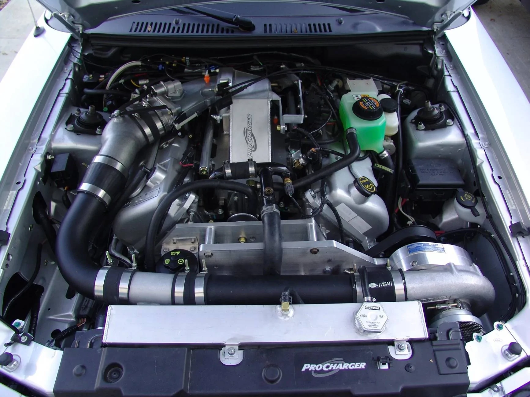

You have proved it is a common setup compared to every other centri setup using air to air, especially the car this post is for
Procharger re-used the 2003/2004 Cobra air to water setup for their kit as well

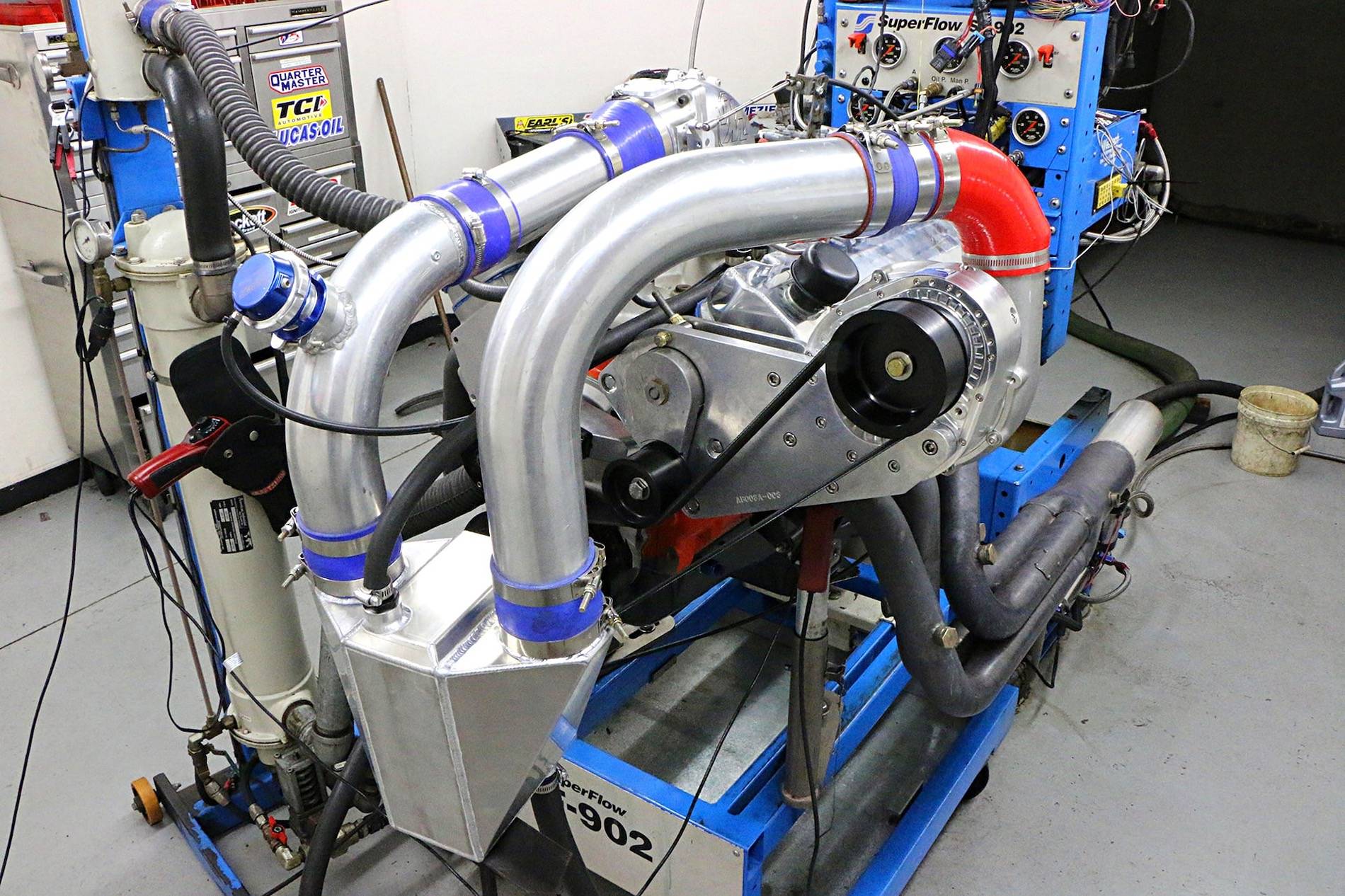

Also if you go to the drag strip, most of the big power centrifugal cars are running air to water as well
