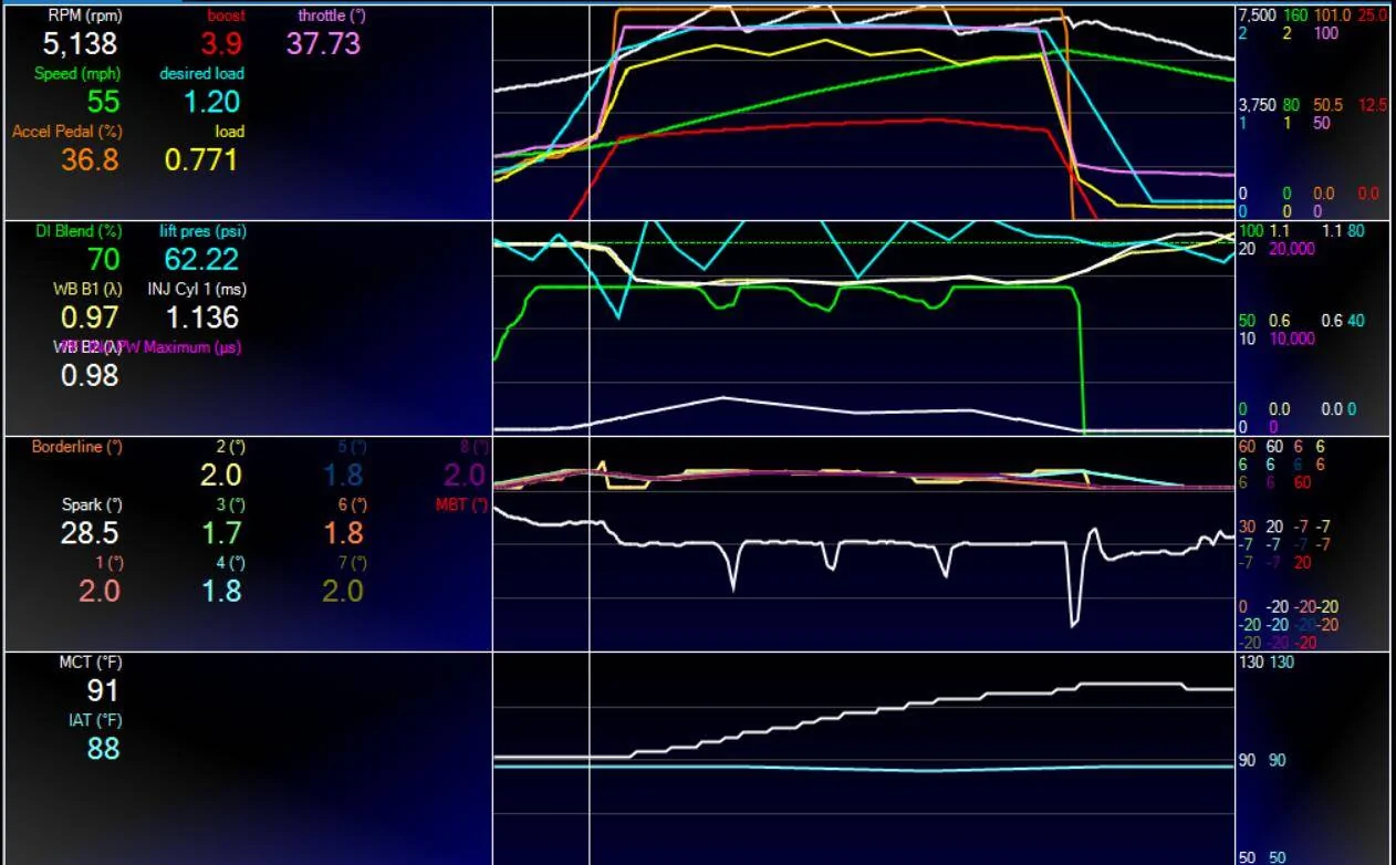

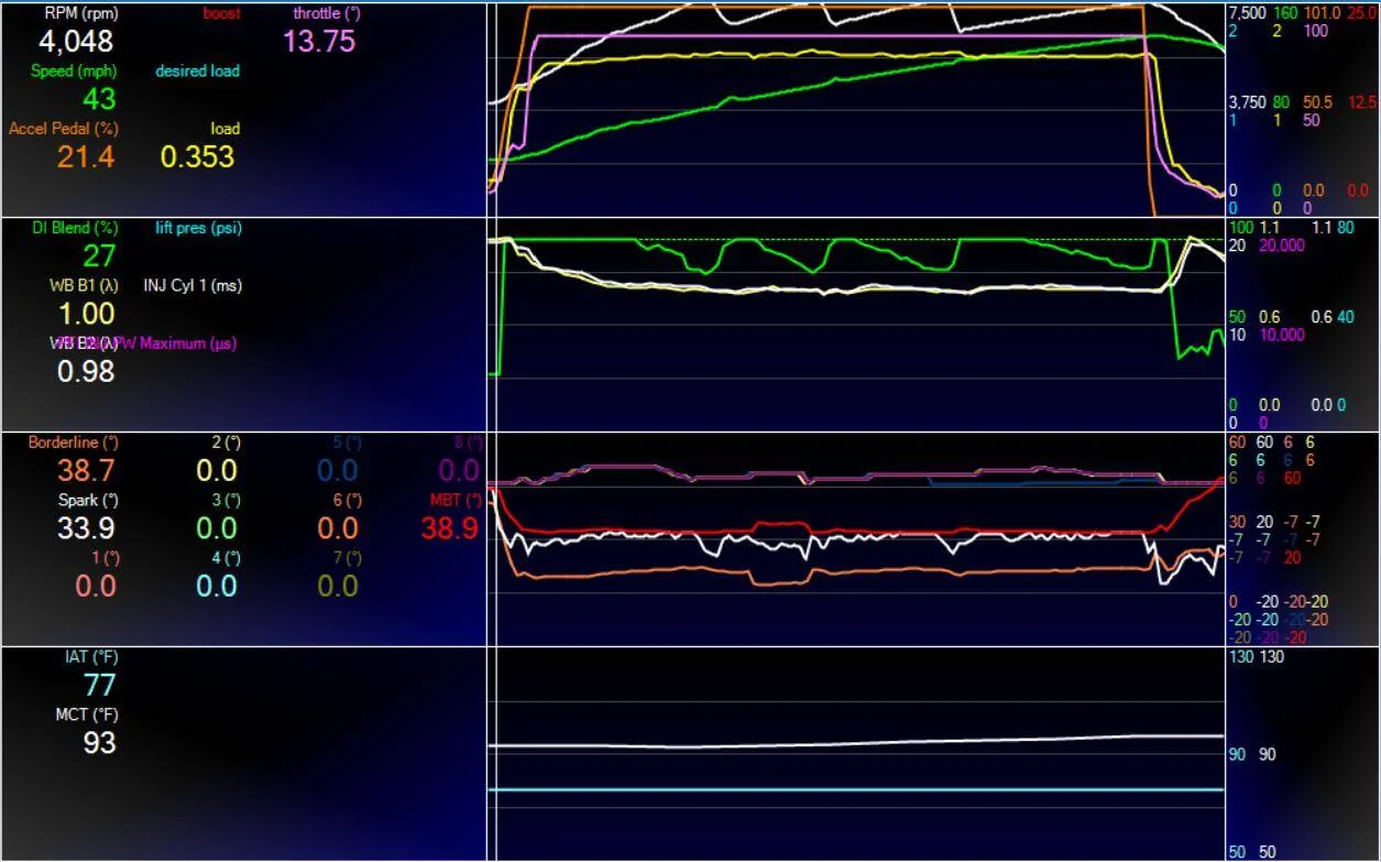

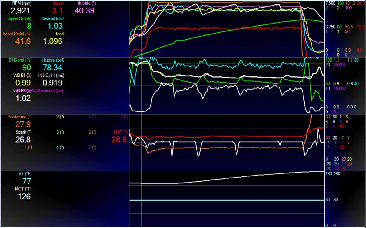

Ah, yes, I forgot to discuss the intercooler differences. I've done extensive logging and comparisons here.
With a water/air in a PD blower, it is true that the water temp rises during normal driving to around 20-30 deg over ambient (40-50 for Roush) and there's just no bringing it back down. The MCT rises to the same temp to match. People see that and shout "heat soak!". However, at WOT, the air temp just doesn't rise much more than that (Whipple, not Roush). It's hard to believe but I have log after log showing that at WOT the MCT stays almost constant. I'm looking at a log now that includes two 60-130 pulls with 2 minutes of driving in between. The first pull started at 90 charge temp and ended at 97, while the second pull started at 97 finished at 99 deg. I actually didn't believe the readings, so I tested the sensor using ice water and boiling water while it was plugged into the PCM and it turns out it was accurate.
Conversely, logs have been posted here showing temp rise with air/air intercoolers and quite the opposite story was true. They stay very cool while driving around normally, but once you go WOT the temp rises rapidly. If you're only seeing <15 over ambient over a long pull then you are likely pulling data from the wrong temp sensor. It's an easy mistake to make.
All that said, a PD blower airflow will not decline as the charge temp rises because it's an inlet volumetric flow device. There is basically no power loss if you're on E85, but some due to knock limits if you're on gasoline. A centrif will actually reduce airflow as a result of higher charge temp because it backs up on the compressor curve.

These logs tell the intercooler story well.
This is an ESS on the 125 mm pulley, 60-130 pull. As I described, the initial charge temp is very close to ambient, but rises rapidly:
This is a Whipple on the 4" pulley. The initial charge temp is 16 deg over ambient due to "heat soak", but barely rises over the course of the pull:
And for good measure, here's the sad Roush intercooler. This is an 1/8 mile pull, but you get the idea. It's like the worst of both worlds, starting high and rapidly rising. Note that I had to extend the scale vs the others above.
