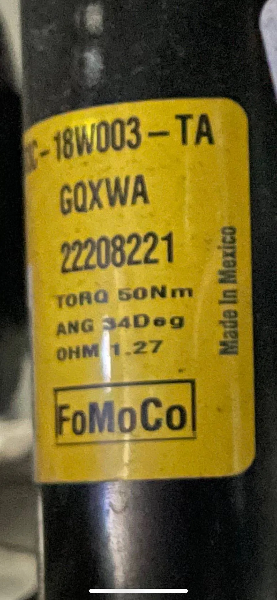

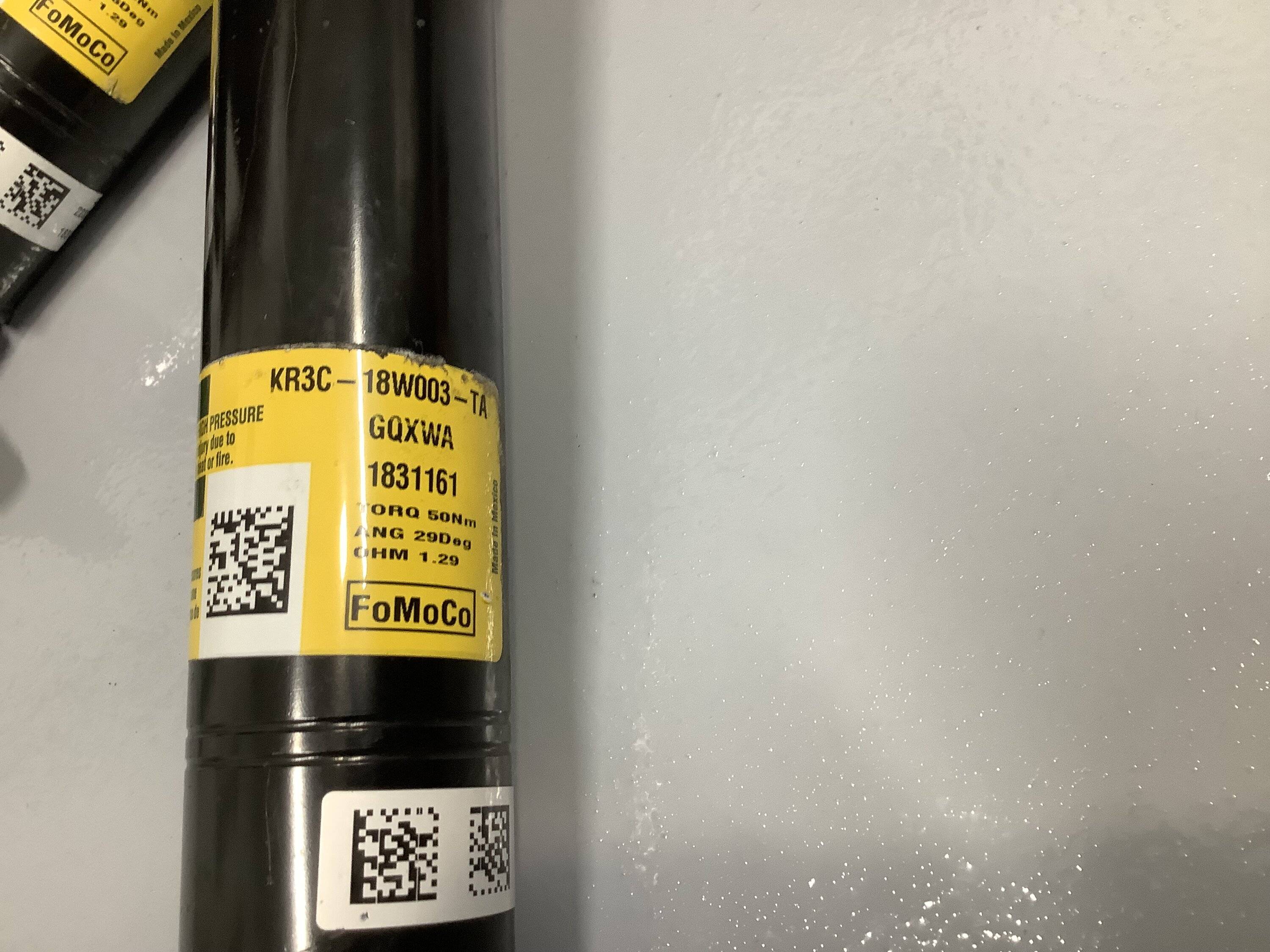

I just had my buddy take a pic of his rear MR shock on his M1. I can see the ohms rating is different than the ohms rating on my Bullitt rear MR shock.
M1 shock
Bullitt shock
