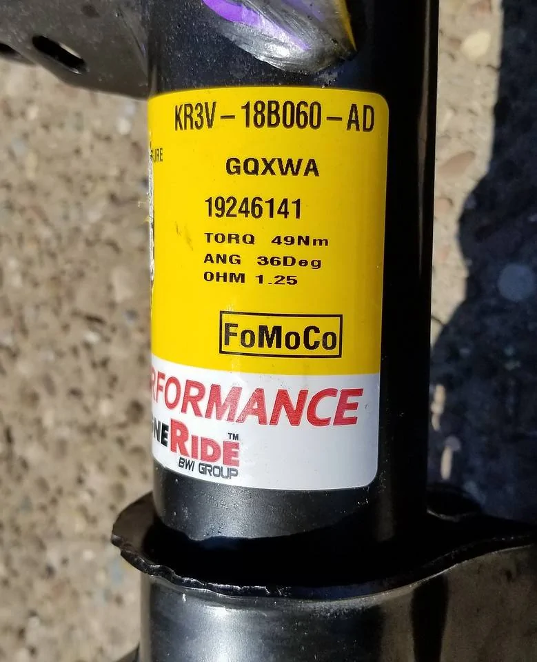

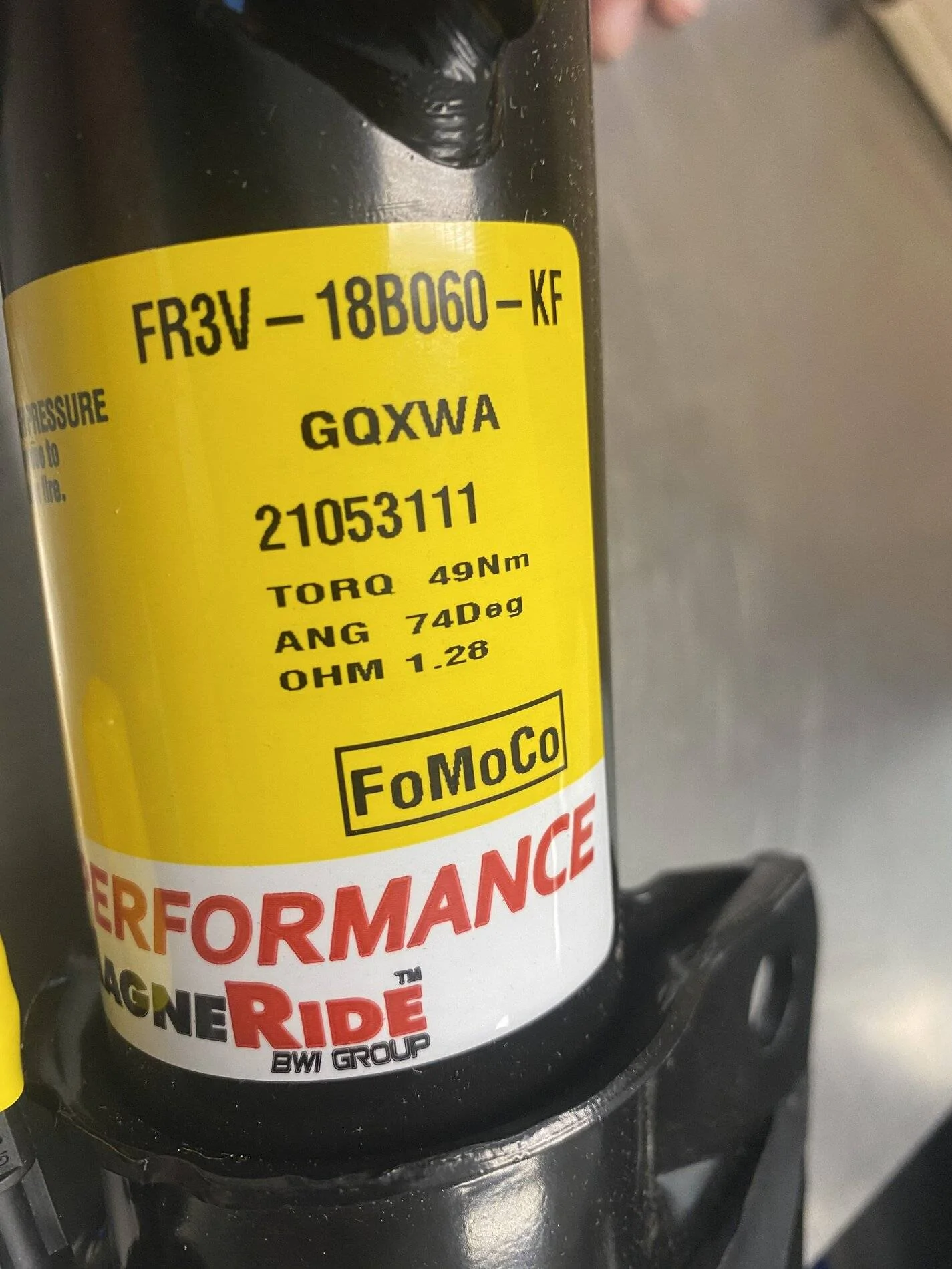

I’ve been looking at CFTP springs and front struts. Do the numbers on the struts reflect different damping for the magneride?
OHM - magneride damping?
ANG - ???
My local dealership seems to be stumped.
The one missing some of the label is a base strut.
Looking the car up by VIN and part number they cannot find one they feel confident it’s the one I’m looking for.

OHM is probably the Magnaride setting
ANG must be angle

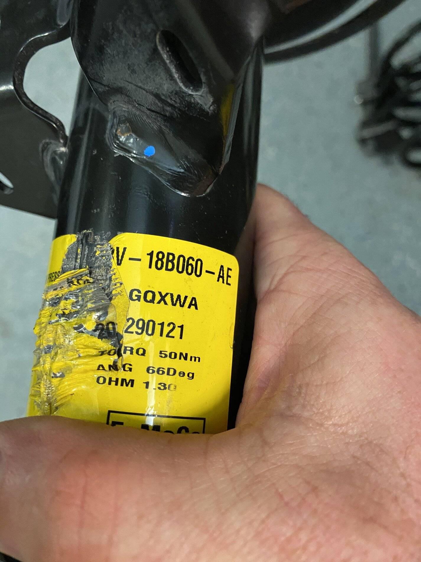

What is interesting is that my Base numbers are different than yours. And my (earlier revision?) engineering number ends in AD and yours ends in AE...
ON EDIT:
I just got through to somebody at BWI Group in Kettering, Ohio. Nobody answers the phone at the number listed online so I had to do some sleuthing to get another number which led me to somebody at BWI's human resources department in Kettering. They are all working from their cell phone, remotely, so I was told there is likely nobody there to answer that particular phone. I was given a contact number for somebody who happens to currently be in Mexico at a plant they have down there so I tried contacting him. He doesn't answer his phone and his mailbox is full so I left a text message explaining what I was looking for. We'll see and I hope to get an informative response.
I'd also assume Billy could get an answer from any of the engineers he worked with on this program, that is, if they answer their phone either.:)
ON EDIT:
I appreciate the effort. It would be nice to know why the numbers are different and if it makes a difference in application.

I need to look at the other side and see what it says. The base one in the pic is passenger side.
Epiphany
Oct 11, 2015
78
7,994
13,662
Global
I like to disassemble things.
Neither side gives you an explanation.

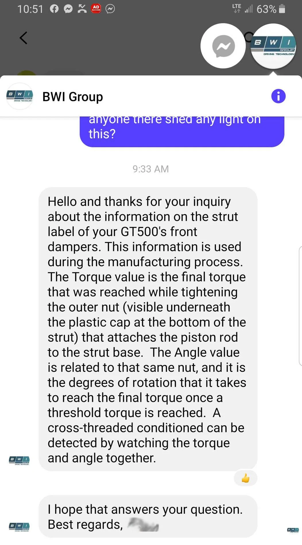

BWI got back to me regarding the data on the mag dampers...
My dealership arrived at the same conclusion. Those are manufacturing specs and have nothing to do with the performance of the shock itself.
