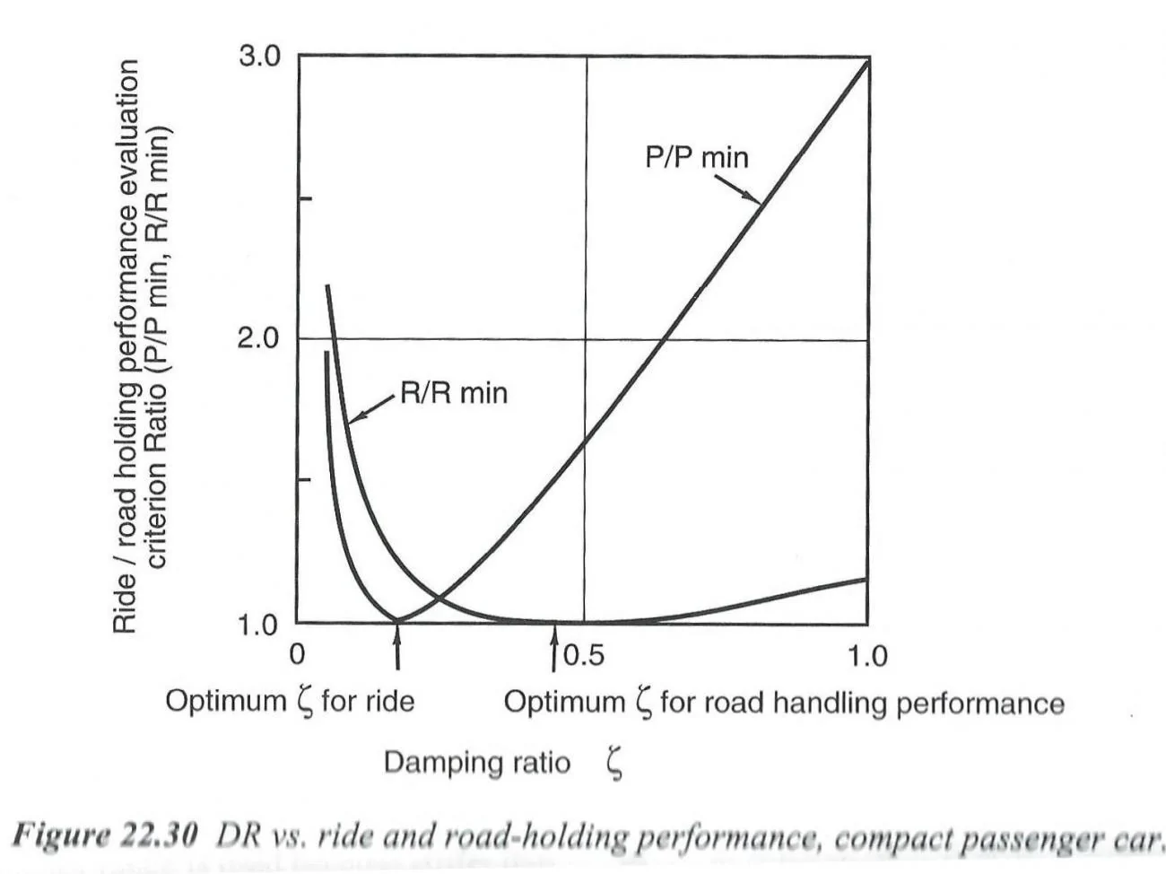

Here's a plot about the amount of damping vs ride and vs performance that comes out of the Millikens' book. These curves would be slightly different for a S550 Mustang, but they'd follow the same general shapes. Conventional dampers only let you use one point on the horizontal axis at a time (one point on the ride curve and the one point on the performance curve directly above or below it), which is what you're changing with adjustable dampers by stopping, getting out, and turning a screw or two at each corner. Magneride could give you every single X-axis condition (percent critical damping) as required in real time without you having to do a thing. Incidentally, damping ratios above 1.0 are possible, just not plotted.
I suppose it's at least theoretically possible to come up with a fluid that might approach infinite viscosity, in which case the damper would effectively stop being a damper and start trying to be a solid link instead. You wouldn't get much roll (the suspension wouldn't be very compliant), but you would start breaking things, like inside the damper itself or in and around the brackets that they're attached at.

I agree that the programming and construction will be limited to shock stiffness that provides a safety factor to avoid bending shock mounts or other suspension components. I also agree a magneride shock won't provide lift like a gas shock.
I'm sure you've already considered how long a car typically is in a corner (not very). To reduce the amount of body roll, the shocks only have to be stiff enough to require more than a few seconds to compress/extend under cornering loads.
It's also interesting to consider that a conventional shock contributes significantly to the functional stiffness of the suspension, whereas a magneride shock could potentially have a much lower contribution during normal driving. I would think the designer could choose a stiffer spring as a result, which would help to limit body roll as well.
Yes. I do have some idea about the effect that damping has on vibration frequency (natural frequency drops with increased damping, meaning for one thing that the speed with which roll develops slows down but doesn't stop until the true equilibrium positions are reached). It takes a lot of damping to cut the frequency in half (roughly doubling the time it takes to reach the equilibrium position "the first time" in an undamped system), and that's doubling a length of time that's well under half a second. A few seconds is more than sufficient for the damping to have done all it's going to do when roll (with no noise coming up from the road being added) is the only thing being considered.
A system overdamped in rebound would jack down, overdamped in bump would probably be intolerably harsh.
