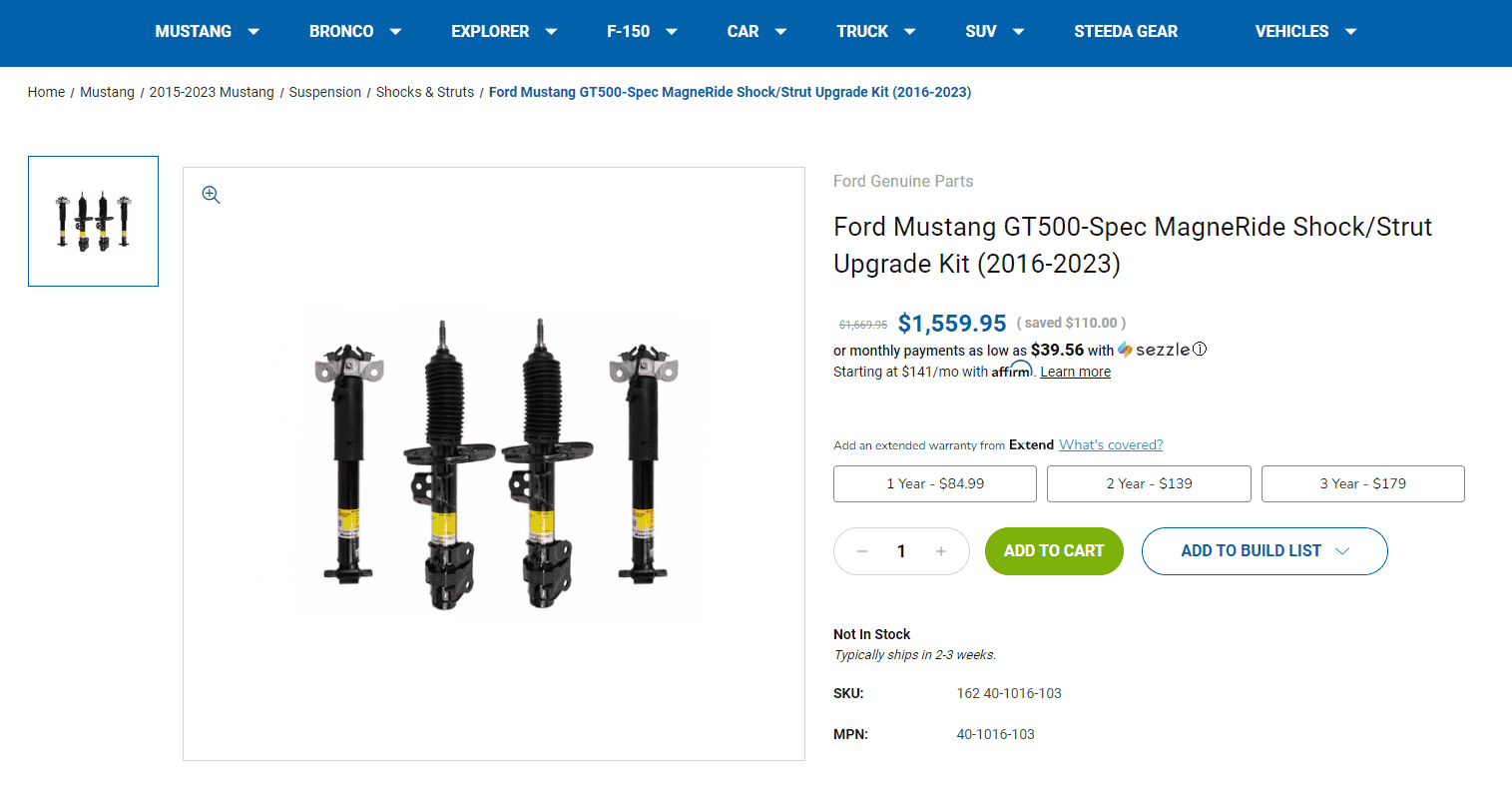

For PP1/PP2/Bullitt/Mach1s? It doesn't mention anything about software???
https://www.steeda.com/ford-genuine-40-1016-103-mustang-magneride-kit
What questions do you have ? They're OEM GT350/GT500 dampers, you can probably buy them from Rock Auto if they're in stock (or from Levittown).
@TeeLew will know more but they're capable of higher damping forces for stiffer springs and issue you're going to run into with stock VDM is that their current vs. force curve is different than stock and not exactly (AFAIK) publicly available.
It's a damper - it works exactly as stock PP1/PP2/Mach 1 one and the only way you can really take advantage of it is by driving them differently with an aftermarket controller.

1. Don't buy anything until those words do have some meaning.
The Shelby GT500 & GT350R both used Magneride dampers that made more force than those for all the other cars. This price is a little high, but not crazy for the set. As far as I'm concerned, these are the dampers *ALL* the cars should have been delivered.
These struts/shocks are plug and play with any Magneride cars and it will tighten things up significantly.

The cut rate Mr shocks the eco and gt wit pp1 and pp2 got are under damped. Yes it's a function of the software to an extent but also the actual hardware used in the m1/gt350r/gt500 builds. If you have a gt/eco then yes replacing the front dampers in particular is a decent return on investment.
But as mentioned previously, the controller programming is the other half of the equation. If Steeda were selling their locked tuner for like 600 bucks that would be a very compelling path forward.
I haven't been able to find proof the rear shocks are different in the new batch vs previous. I waste a lot of money, but not having a Mr car myself, haven't bought a damper to take apart.
Tim might have a sacrificial unit. Otherwise I'd try to wheedle it out of Steeda tech department. Or vorschlag.

You're not the guinea pig. I've been using the high damping struts for 25k miles with 450 #/in front springs. I'm using the standard rear dampers.

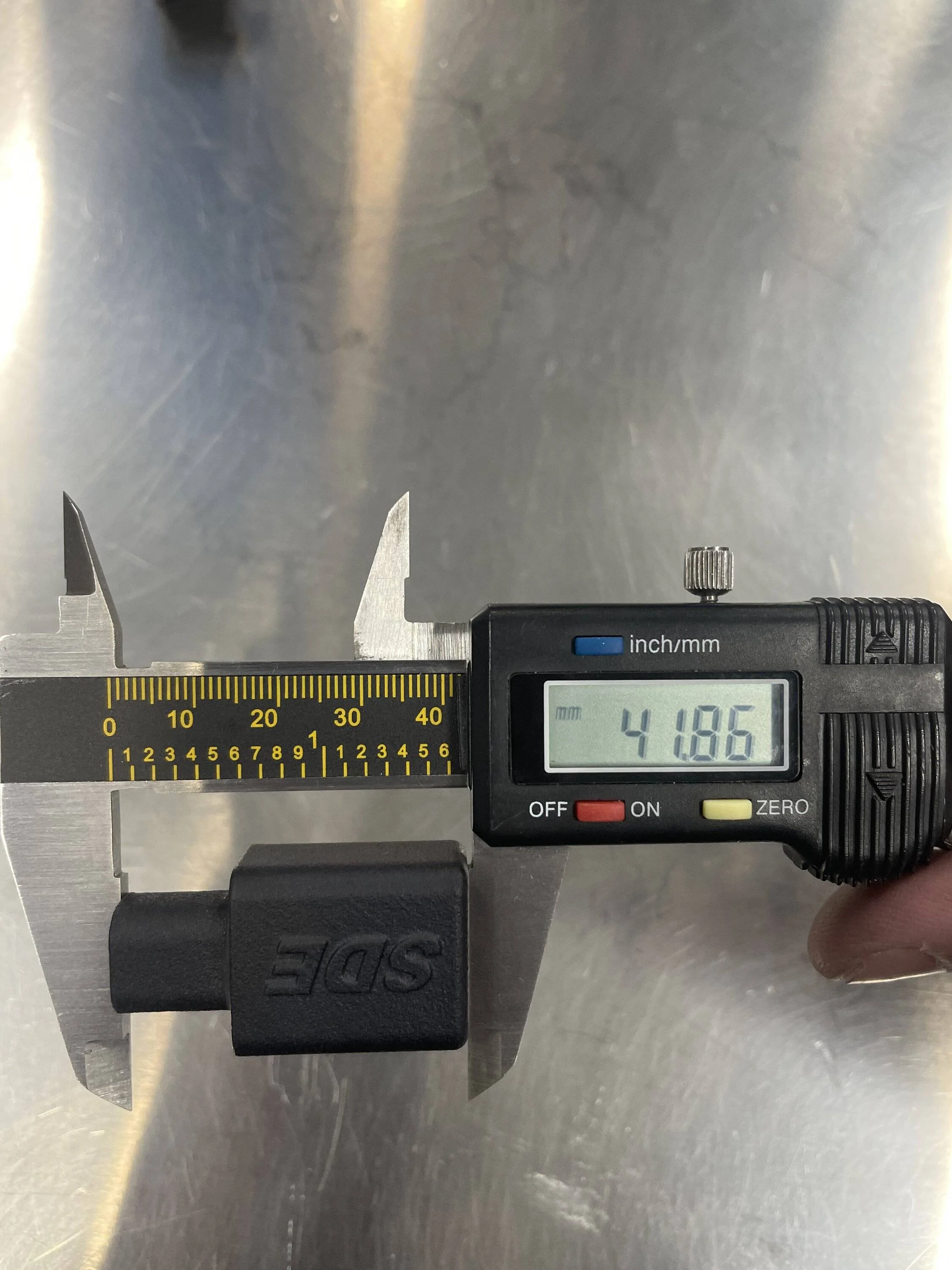

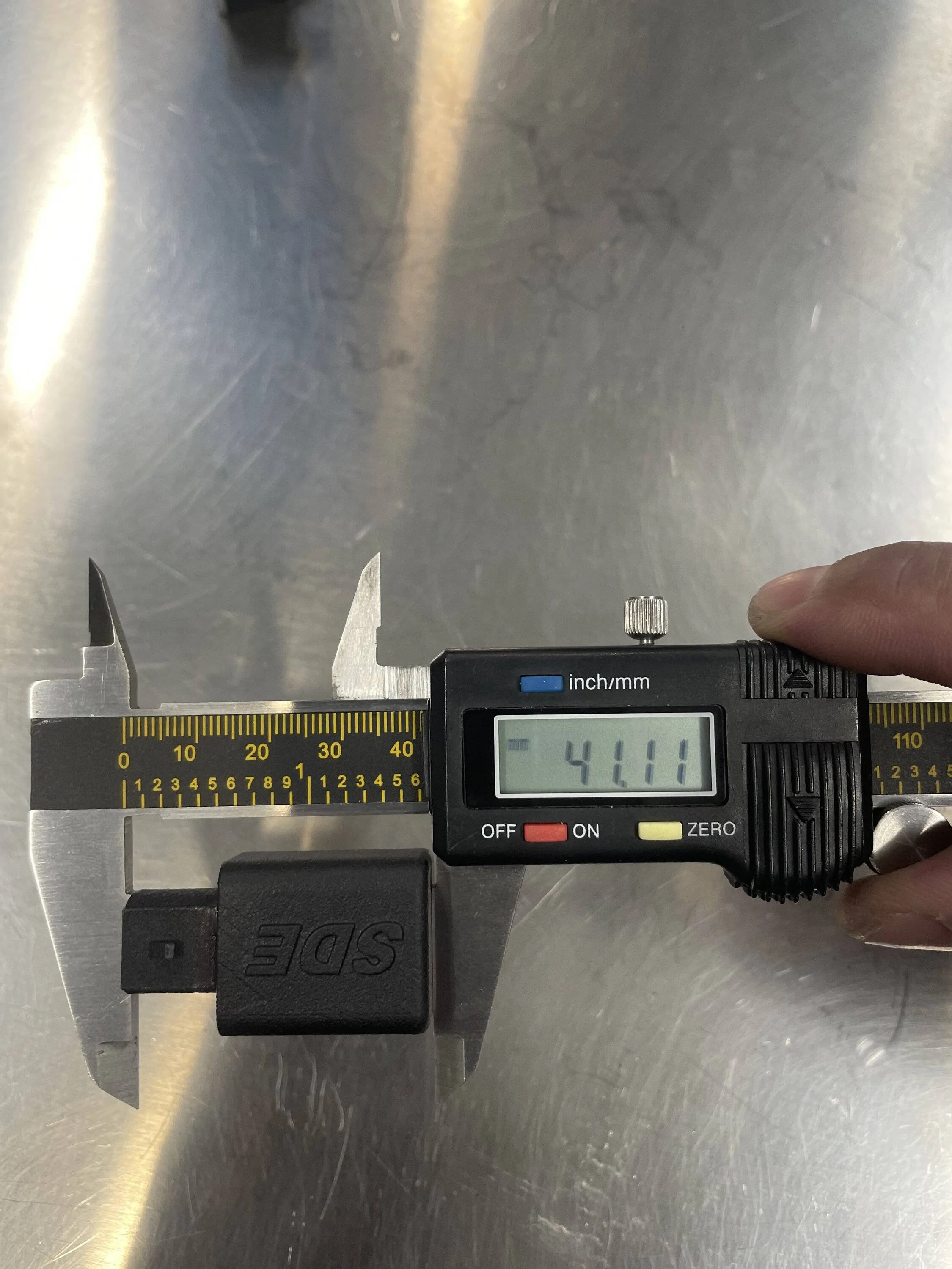

@Proshop here’s some more info. for you. I went to install the SDE ride height sensors today and couldn’t get one of them to lock into place. I took measurements with my digital calipers and found the issue right away. One is slightly longer than the other. Upon making this discovery, I scrubbed installing them and plugged the wiring harness back up to the factory ride height sensors. The last thing needed would be to have the one that didn‘t lock into place fall off while driving.

The dampers themselves are not 'smart' devices. They just have 2 wires going to them which energizes a magnet. The difference is in the actual piston flow restriction. The good thing about these is that they've had to survive the entire Ford durability cycle, so you know they'll last quite a while.
I think the stock Ford Vehicle Dynamics Module (VDM) with the high damping struts is a pretty good combination. On average, you're probably doubling the damping forces which I think the car loves. It gives it much more of BMW M-car ride *without* going to the aftermarket controller.
