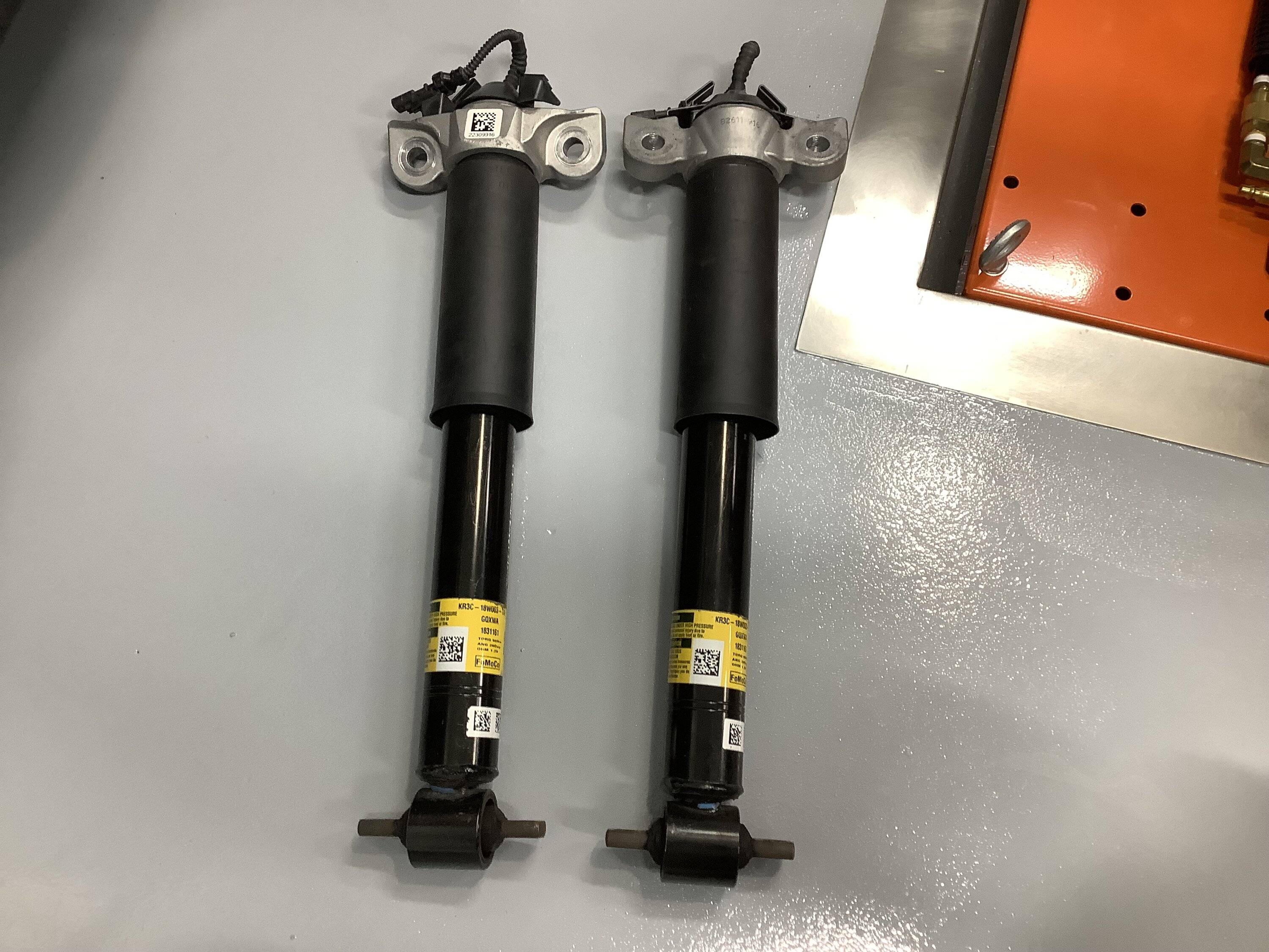

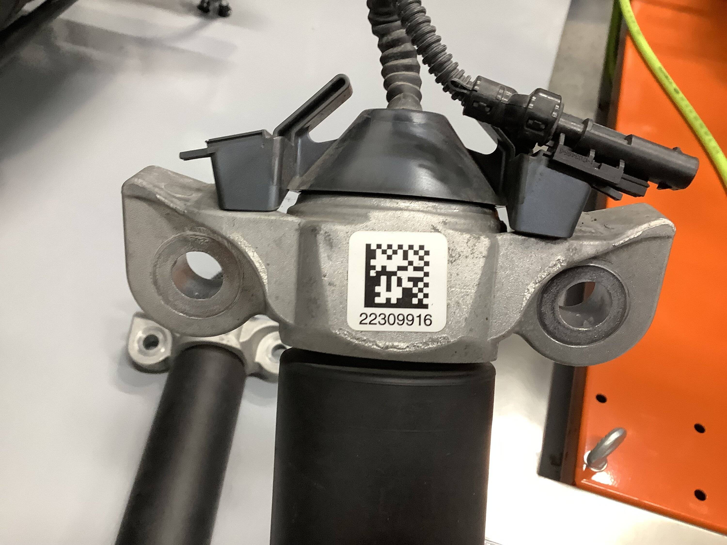

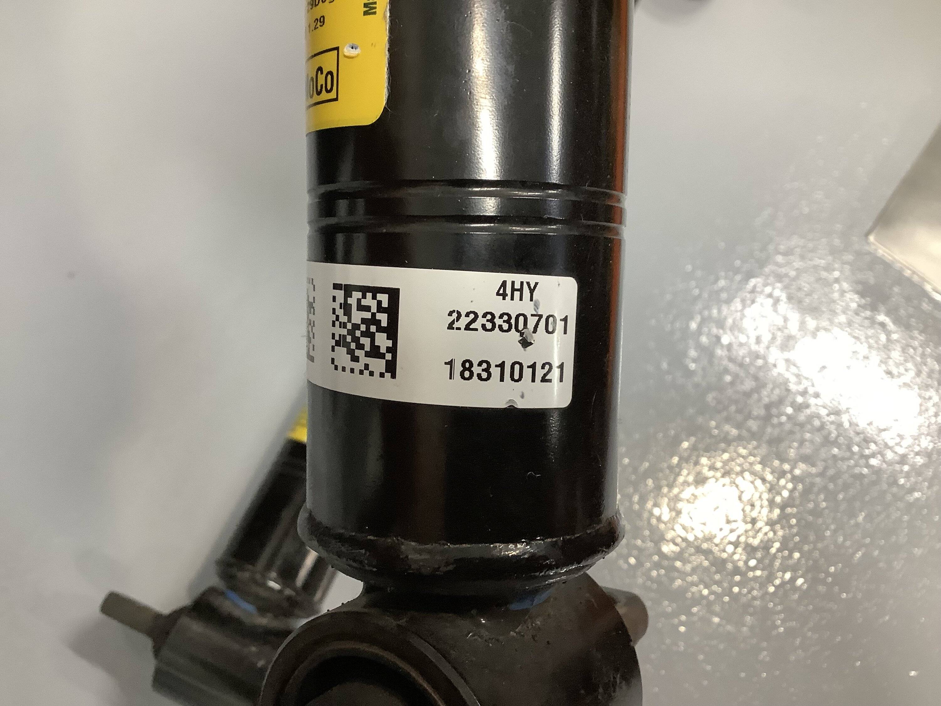

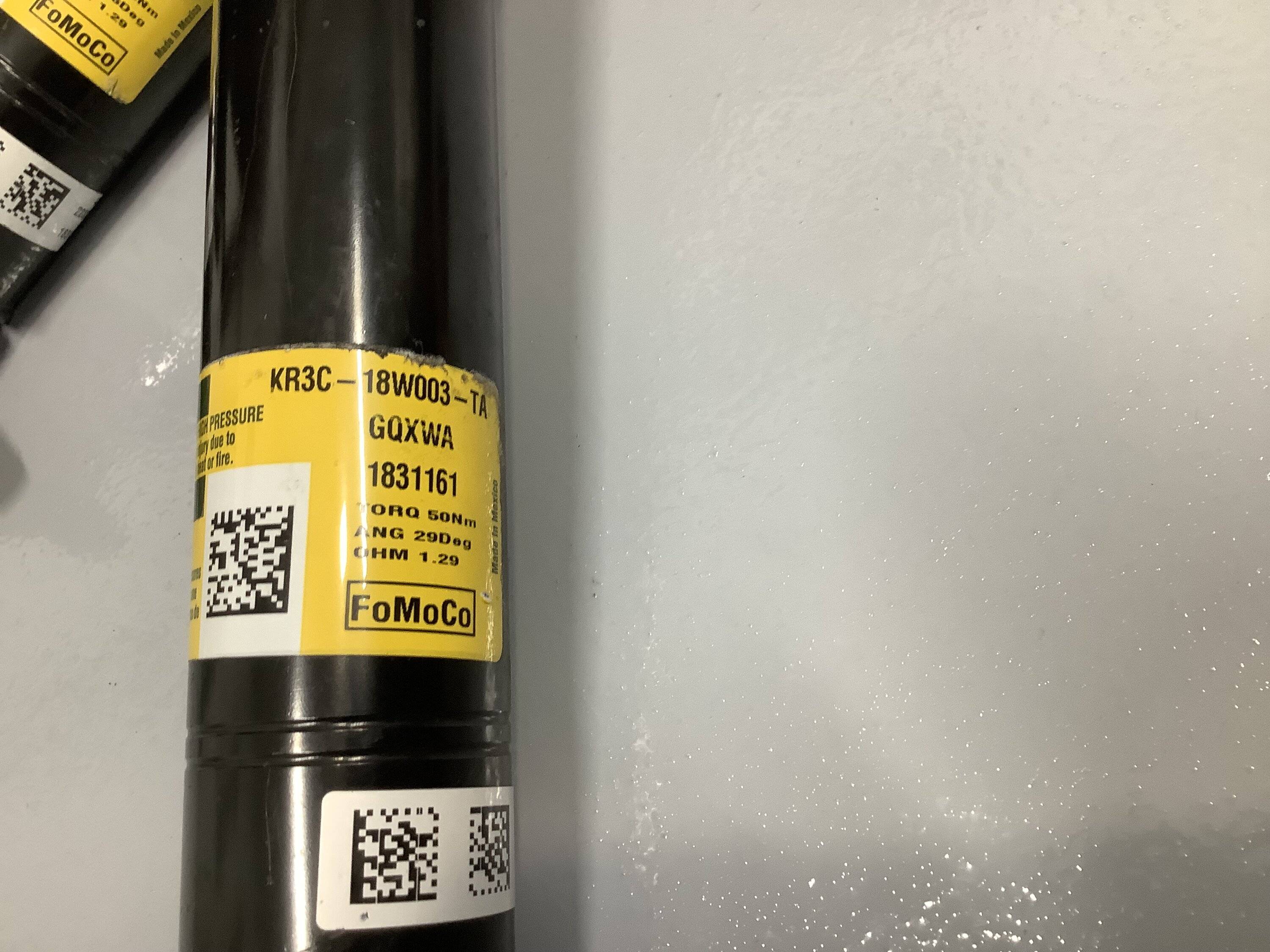

I don’t know if the Bullitt rear MR shocks are the same as what’s on a M1, GT350 or 500, but here’s the info. that’s on mine. Note: Info. is the same on both shocks, in case someone wants to compare part numbers.
Nope.
it's not. The Bullitt rear dampers are quite "loose", no better than the early GT350 and PP1 and definitely not the same as the M1. The GT350R in 2020 got the 'tighter' dampers and possibly programming changes. The PP2 hardware is the same as the PP1/GT350 but had GT350 programming or something very similar, near as I can tell. Your PP1/Eco w/ MR when flashed with the FRPP module gets that PP2 tuning.
