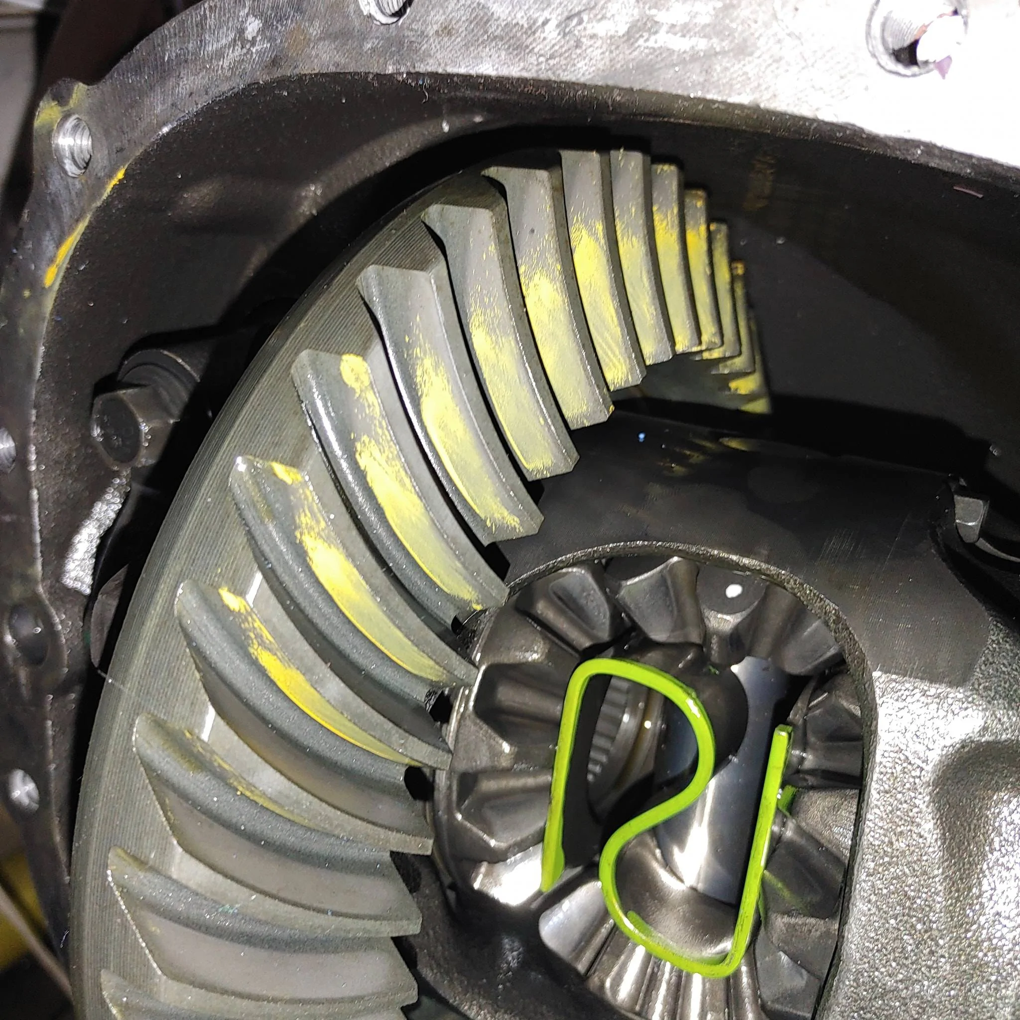

No Torsen for me, ever. That swap isn't for the beginner.
Swapping a new gear set is easier than swapping the Torsen? Dear god, I guess that's why people say to get a whole pumpkin?
Dunno. Should have clarified that I'm not a fan of the Torsen diff.

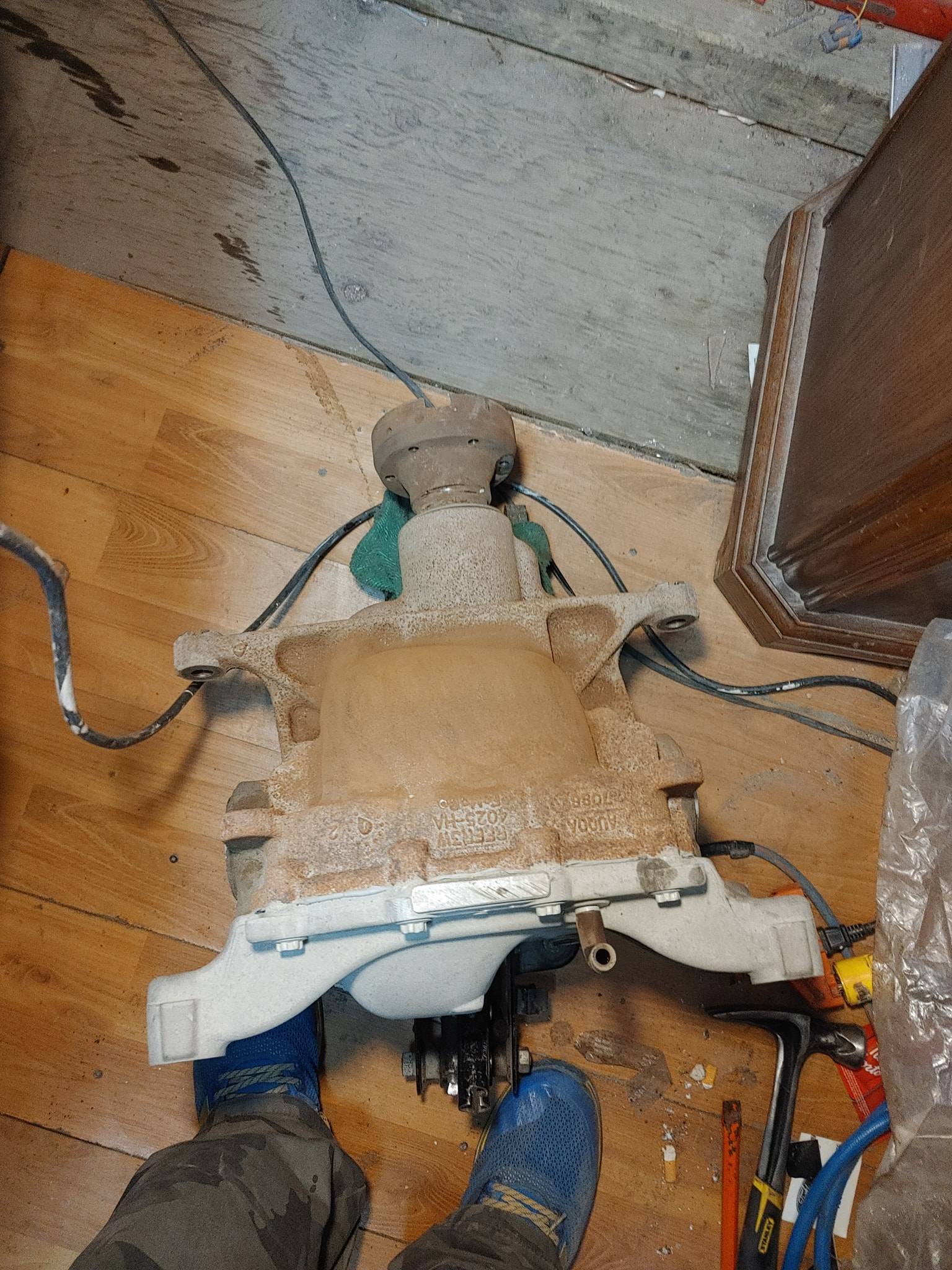

It's not that bad to set up a rear diff. There are some specialized tools. Of course I've only done it on a 9 inch, so I don't have direct experience with the super 8.8, but it's not that bad. It's way easier than rebuilding a transmission or engine. It mostly takes patience and the ability to follow instructions. But it's a real PITA to pull the pumpkin from an S550. It's a lot of work and I wouldn't do it unless I couldn't see any other way around it.

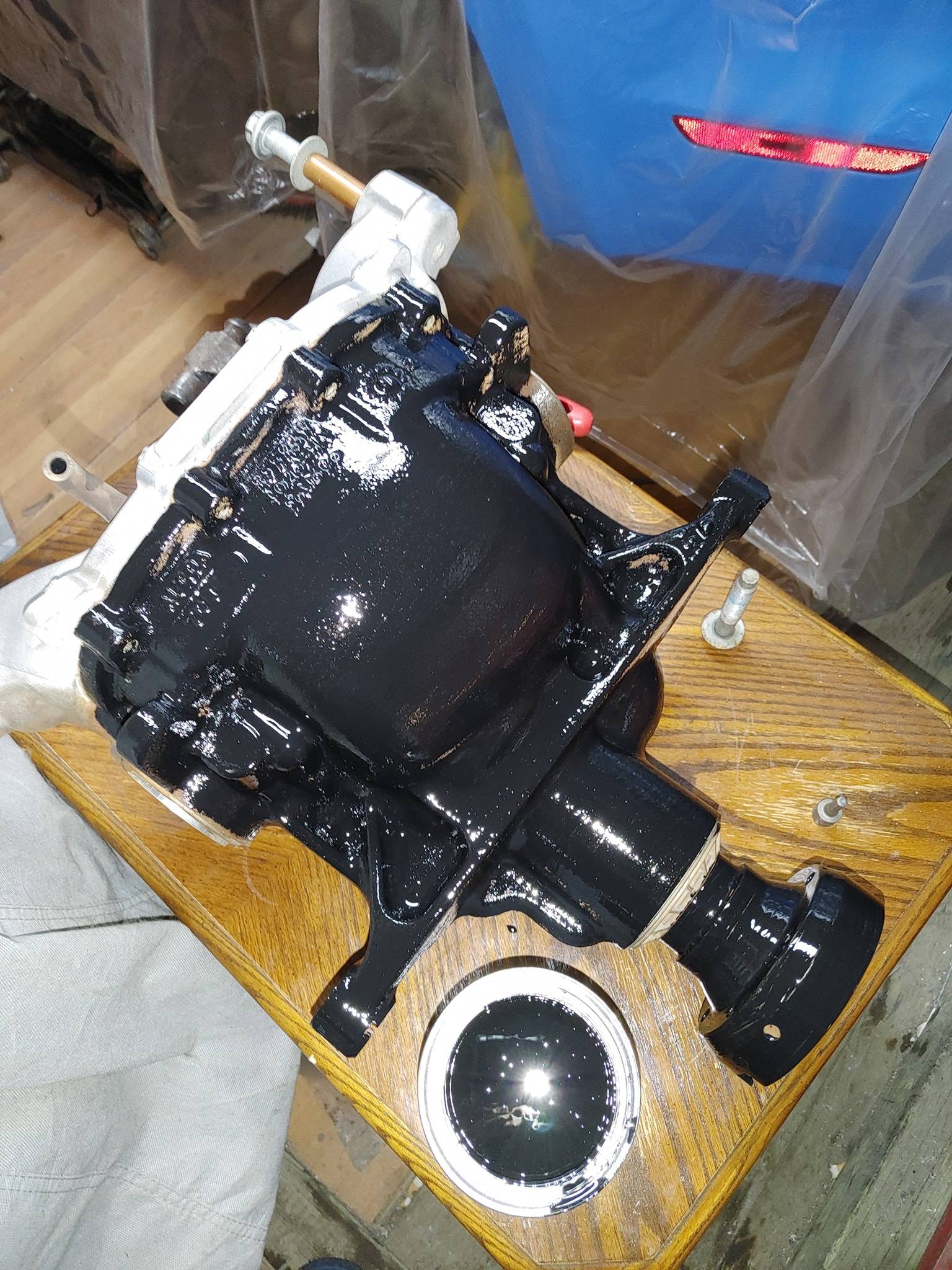

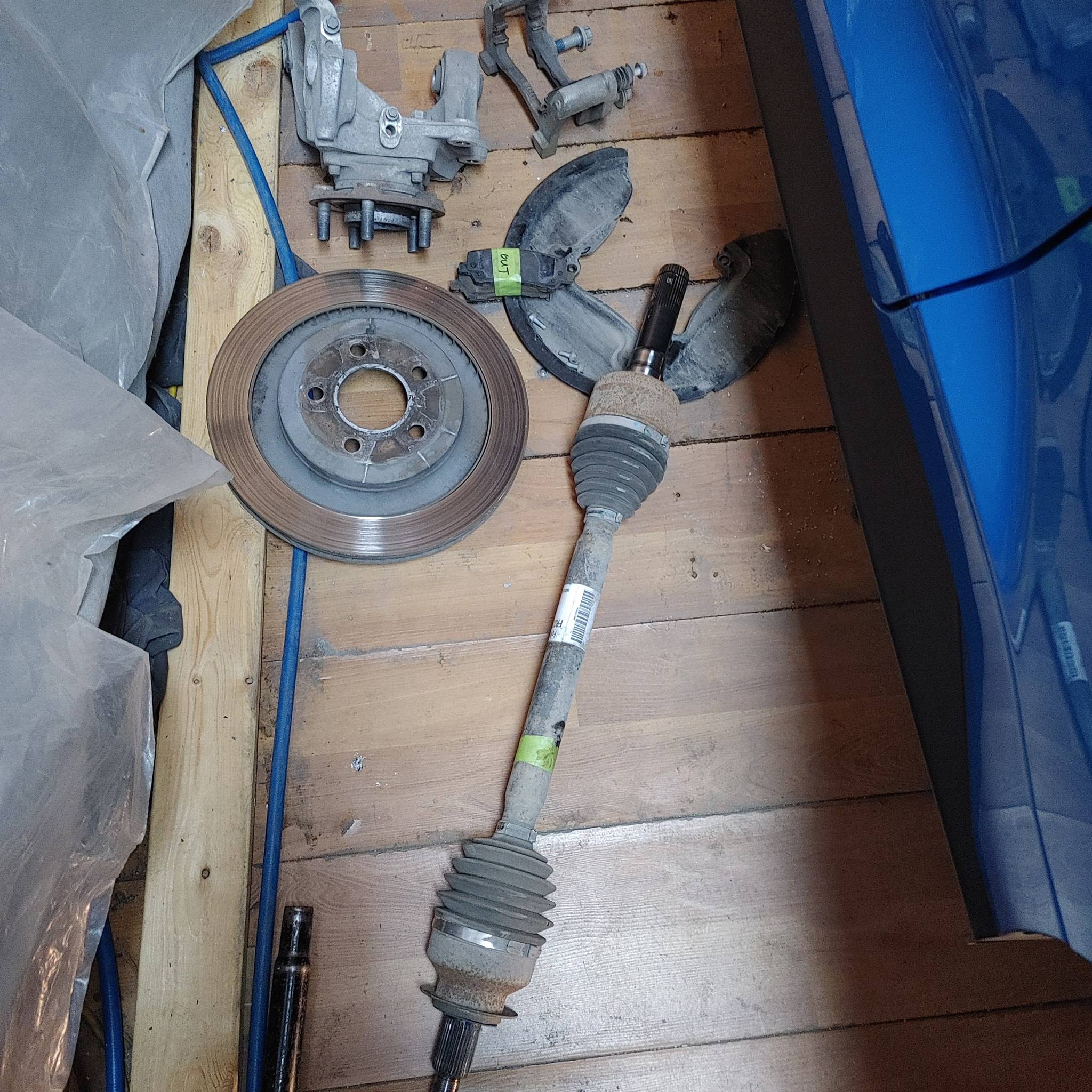

I've seen plenty of guides for how to swap the pumpkin and that doesn't make me too nervous. It's re-building the diff completely because if I mess it up there's pretty big consequences unless I have a spare sitting around. Then I have to do all that work dropping everything and putting it back together.
I'm assuming the hardest part is getting the axles out and in having never done that before, and lining up the driveshaft.
I'm not worried about the subframe or working around in there after doing shocks/springs.
I feel like if I was going to the trouble to take this all apart, I'd swap in GT350 half shafts and new hubs.
Really ? I had the opposite experience. Took me around 2 hours to remove it.

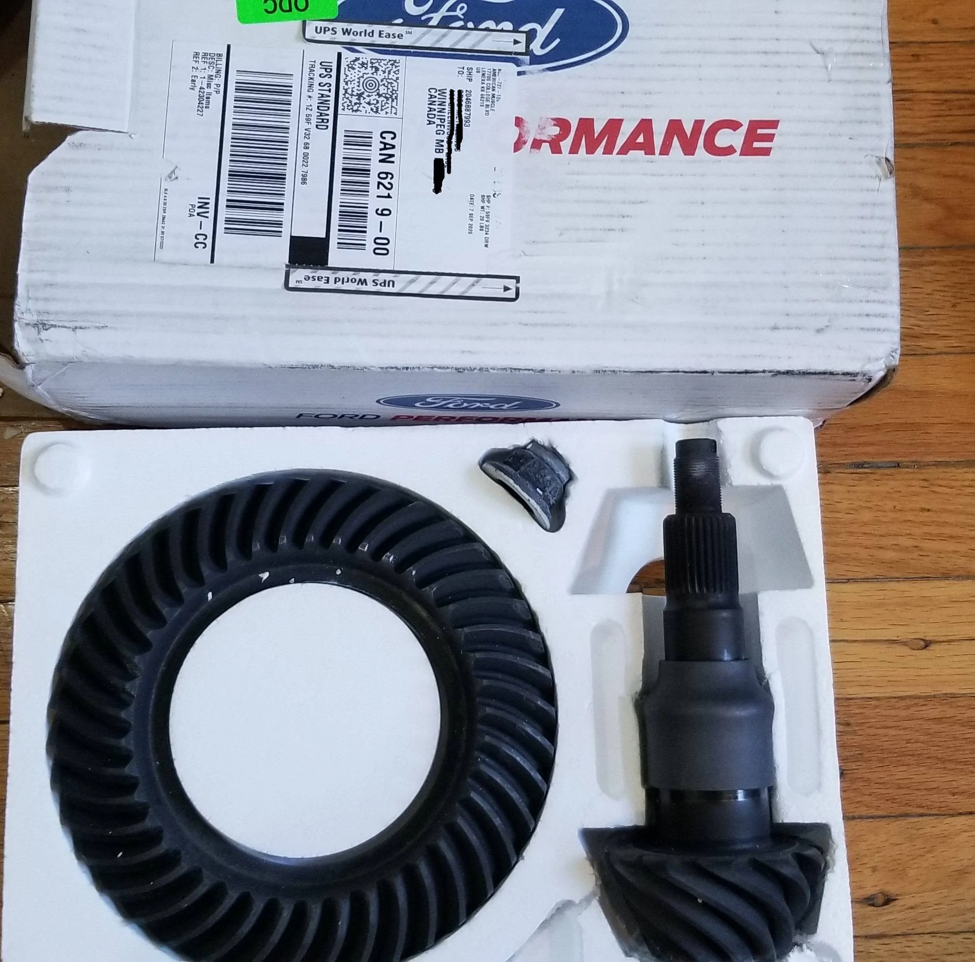

I've got 2 full pumpkins with 3.73 gears if you're near VA.
How the heck did you end up with 2 extra? Unfortunately VA is a bit of a hike, appreciate it though.
I probably just have to "man up" a little more. I remember I bought a better crow bar, because what I had was not working for getting the axles to pop out. And then all the rear suspension disassembly and reassembly was annoying to me as well. I guess I'm spoiled from working on stick axle cars.
