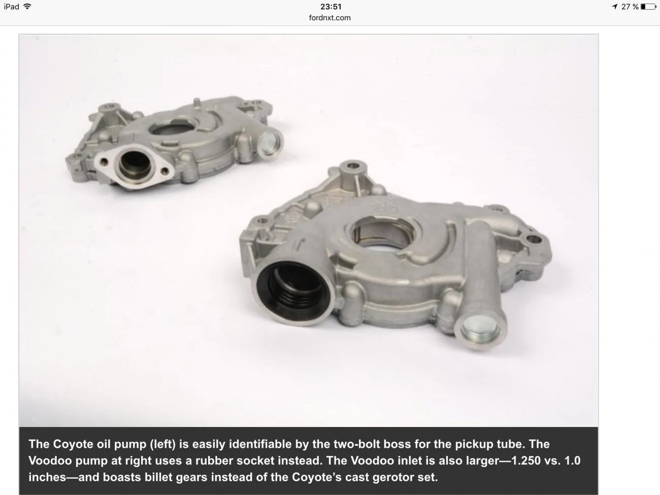

No disrespect krt22 but Scott is a professional auto technician and has proven his knowledge in many, many posts. I agree that we don't know exactly what the issue is but in my view the OPG is likely the issue.
For whatever reason Ford chose to use the same cast OPG a that is in the Coyote. The Coyote does not push over 100lbs of oil pressure when at idle when cold. If you rev it out with the oil cold it could be pushing 125+ lbs of oil pressure, Based on the inherent weakness in a cast part vs a forged part, this is likely the cause.
I guess we will all just need to wait and see but if I was a betting man my money would be on cracked OPG.
:confused:

At this rate, there are more OPG failures than failed oil cooler lines. I think we got a recall on the wrong part fellas.
Kinda funny actually.
No need to argue. I can agree with KRT22 that people haven't proven anything - no pictures of destroyed OPGs....but I have heard of symptoms from 2 cars that sounded like OPG symptoms. Have I seen the insides of the engine, no.

...I am more data/fact driven. It very well could be the OPG, I'd just like to know what facts everyone is basing their opinions on.
I share the same opinion and try to keep an open mind as much as I'm leaning towards the OPG as well.
TSS is well respected when it comes to upgraded pump gears in modular Ford engines.
