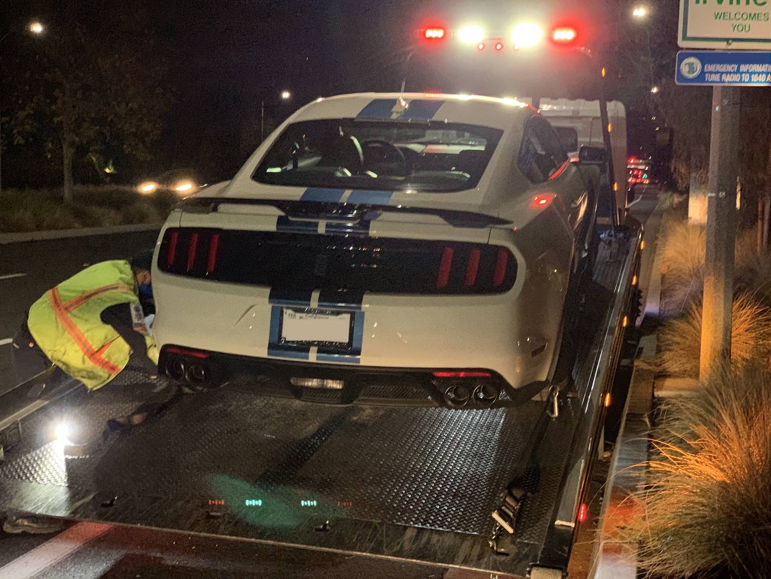

Last Friday I was driving to a nearby coffee shop and strolling in low speed and low RPM on a major street and was about to stop at a red light when I heard a loud, random, short sound from the exhaust pipe. When the traffic light turned green, the car lost all power and could barely move. I parked on the side of the road and had it towed it to the dealer.

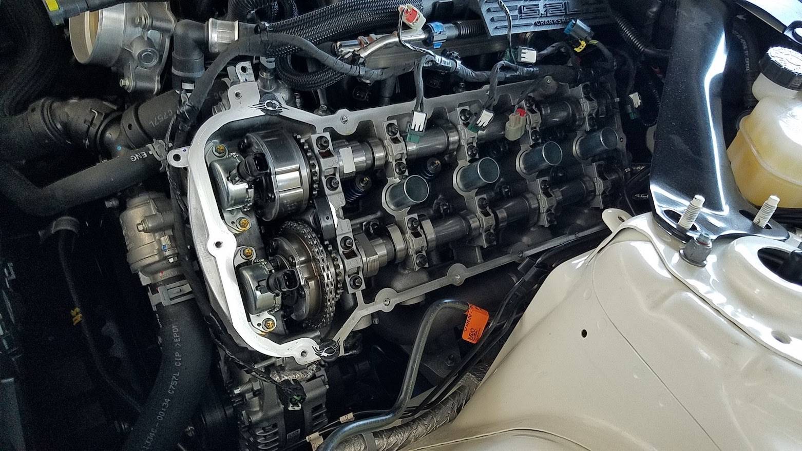

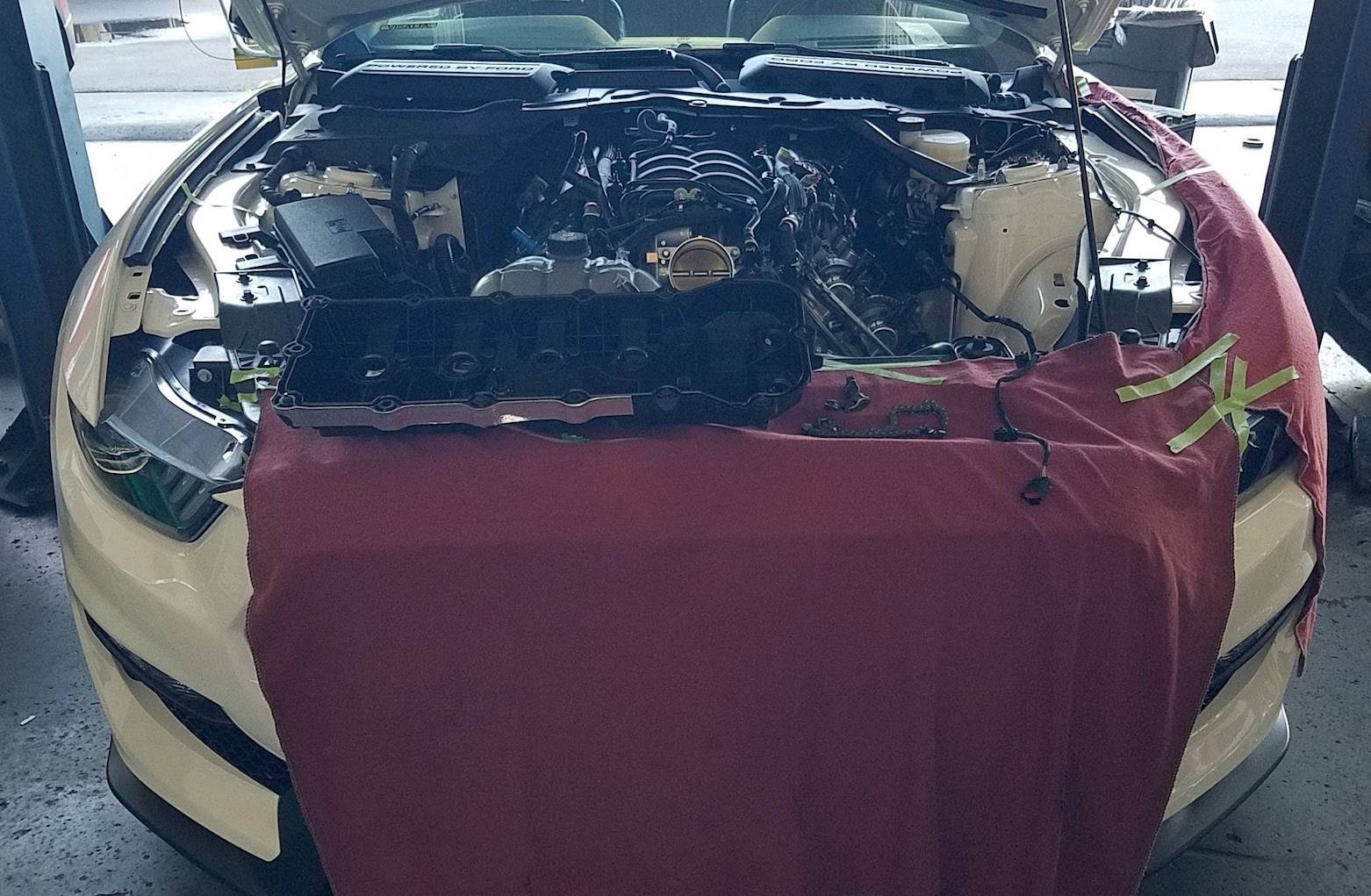

Today I got the verdict from the dealer service center: Something broke in the valve train mechanism (cam/follower/valve), fell into the cylinder, and hosed the engine. He said it wasn’t my fault. The whole long block engine needs to be replaced and they ordered another engine under warranty.

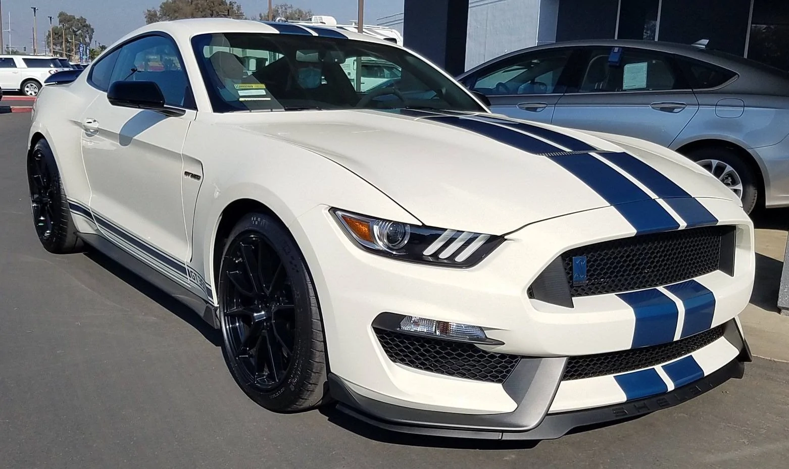

Picking the car at the dealership:

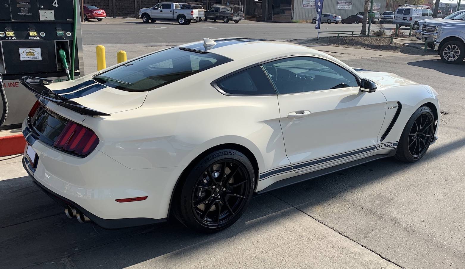

Filling gas before taking it home:

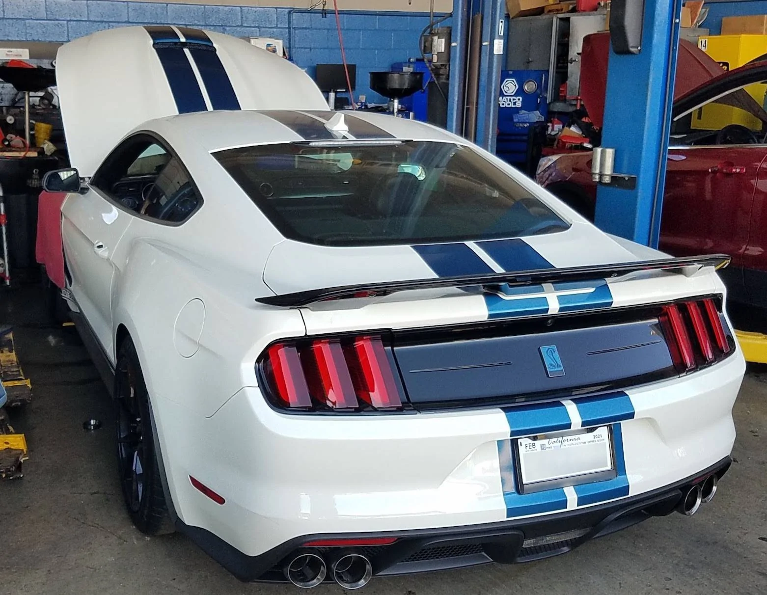

24 days later, towing it to the dealer after the engine failed:

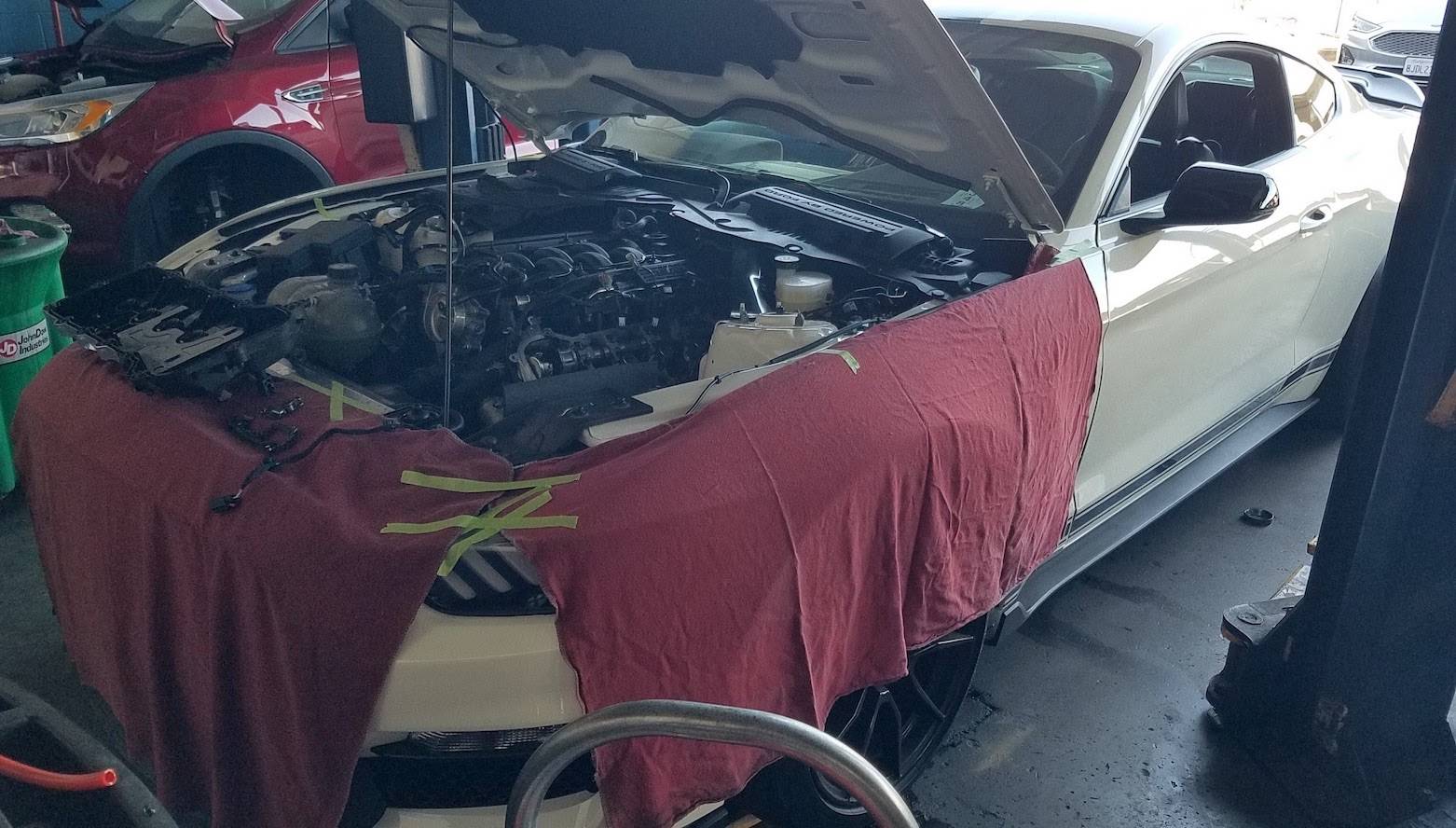

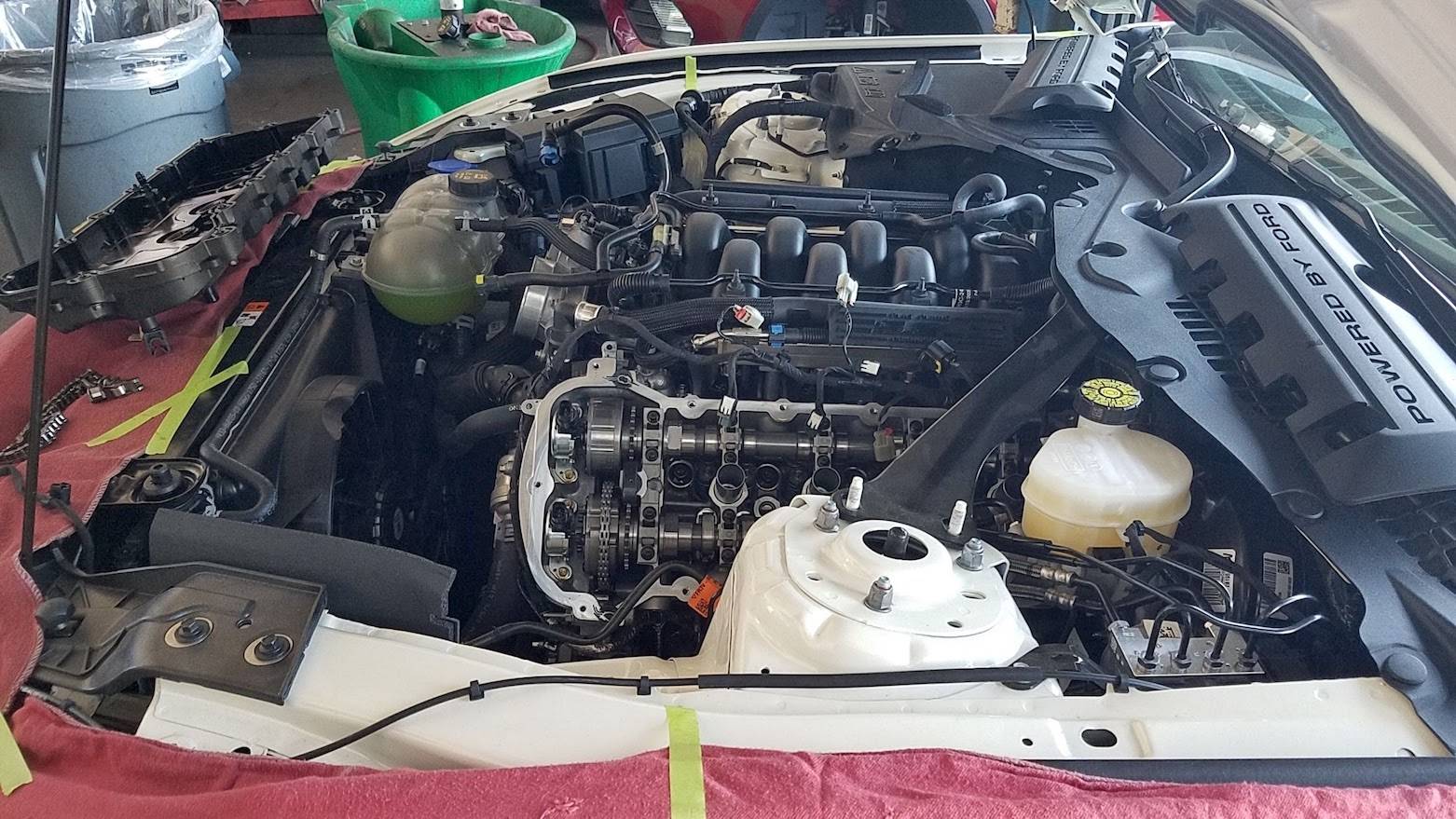

Autopsy pics (not for the faint of heart):

Tom, the issue here is that Ford does not want the dealer service center to do any further disassembly of the engine. They were only authorized to take off the top covers and take pictures of the timing and valve mechanism and see what's broken. The service rep told me they are not allowed to do any further disassembly or attempt to repair the engine themselves, and Ford hot line instructed them to order a new engine, long block and all. So there is no way for them to retain the block.

Oh, believe me, I know. Ford ships a new long block, the dealership strips various external components that are to be used again and it is reinstalled back in the vehicle.
