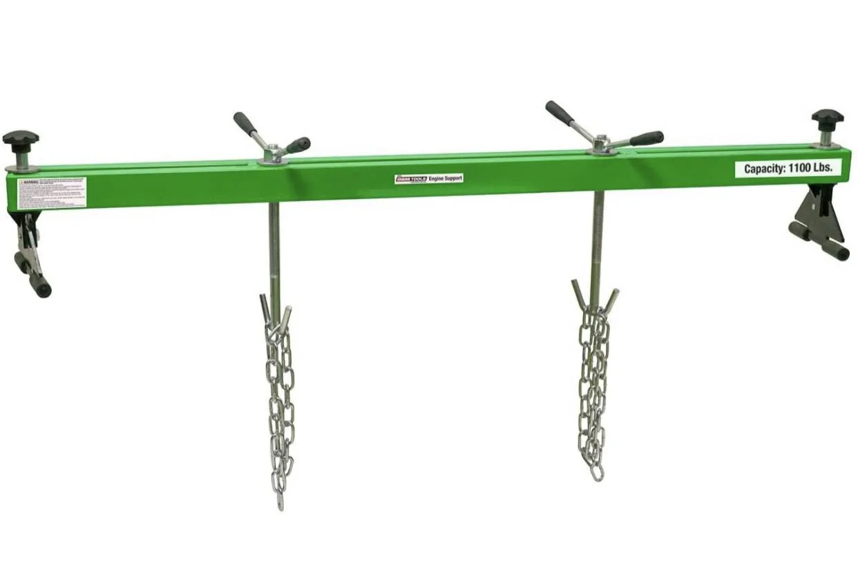

This is purely a guess on my part. I wonder if they used a engine support that rests on the shock towers at some point in the repair. Something like this. It would not be hard to imagine that it hit the plastic caps.

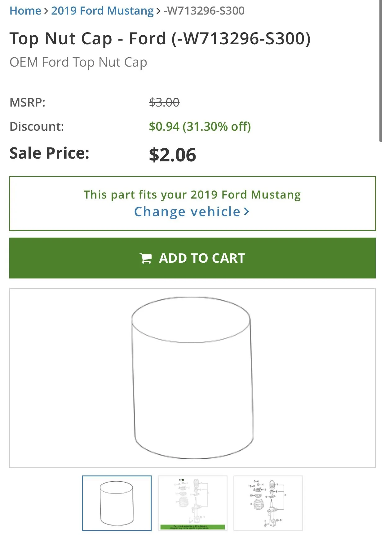

The rust looks superficial. Odds are that little rust has been there and you never noticed it, unless you made it a habit to remove the caps. You can ask the dealer for new caps but I’m guessing they are just on there from the supplier to protect the car on install. Probably not available as a spare part. Any plastic/rubber cap would work.
hit it with a wire brush, wipe on a little oil, and pop on the new cap.
