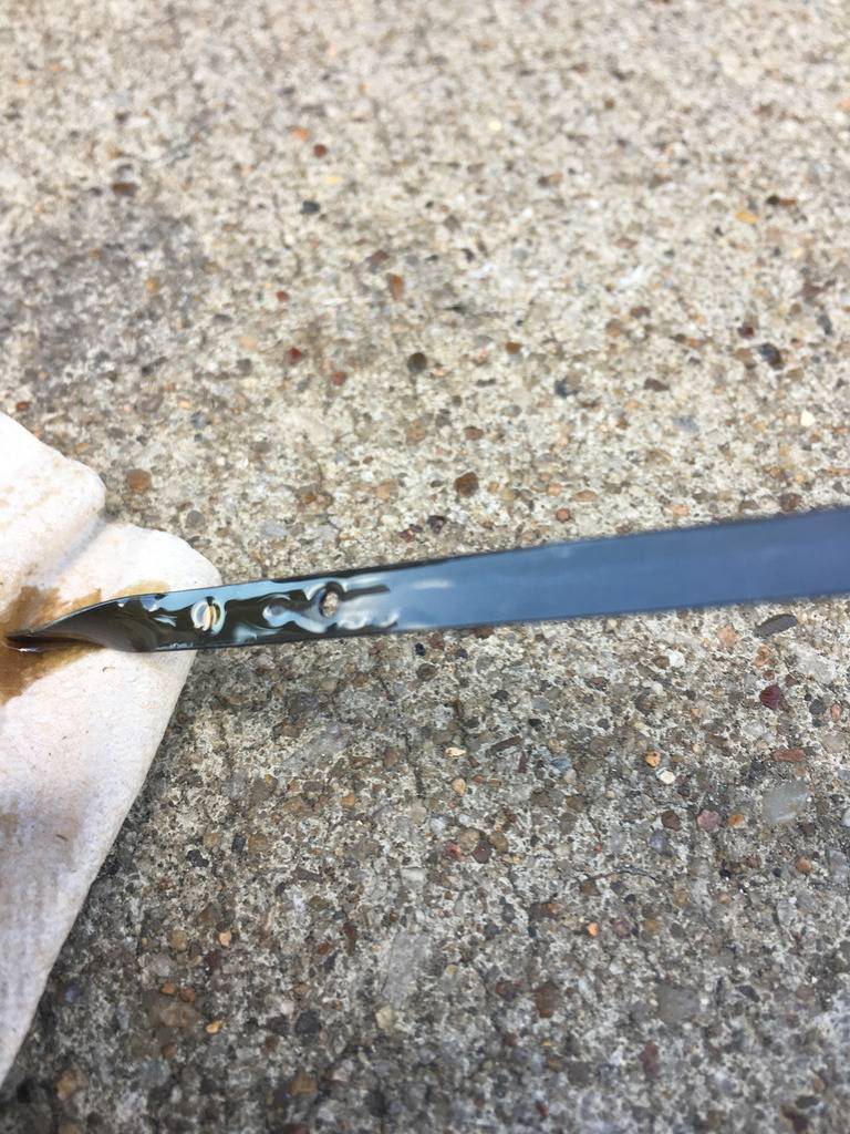

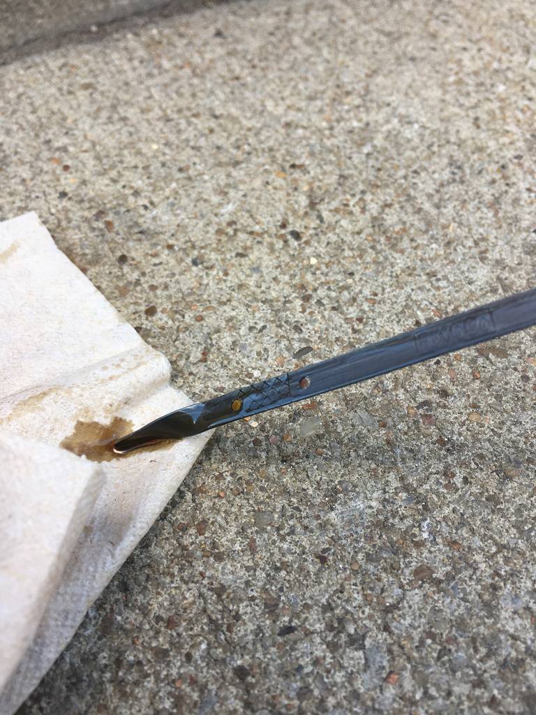

I checked under the car for oil leaks (thought maybe the oil filter had spun off). There were no leaks, I checked the oil a few times and the oil level was right in the middle on the dip stick, where it has been the past few hundred miles that I've checked. I couldn't find any fluid leaks under the car.

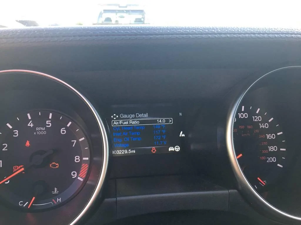

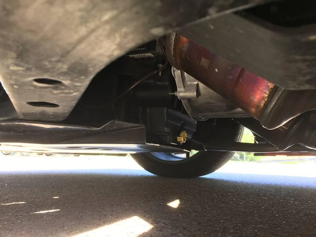

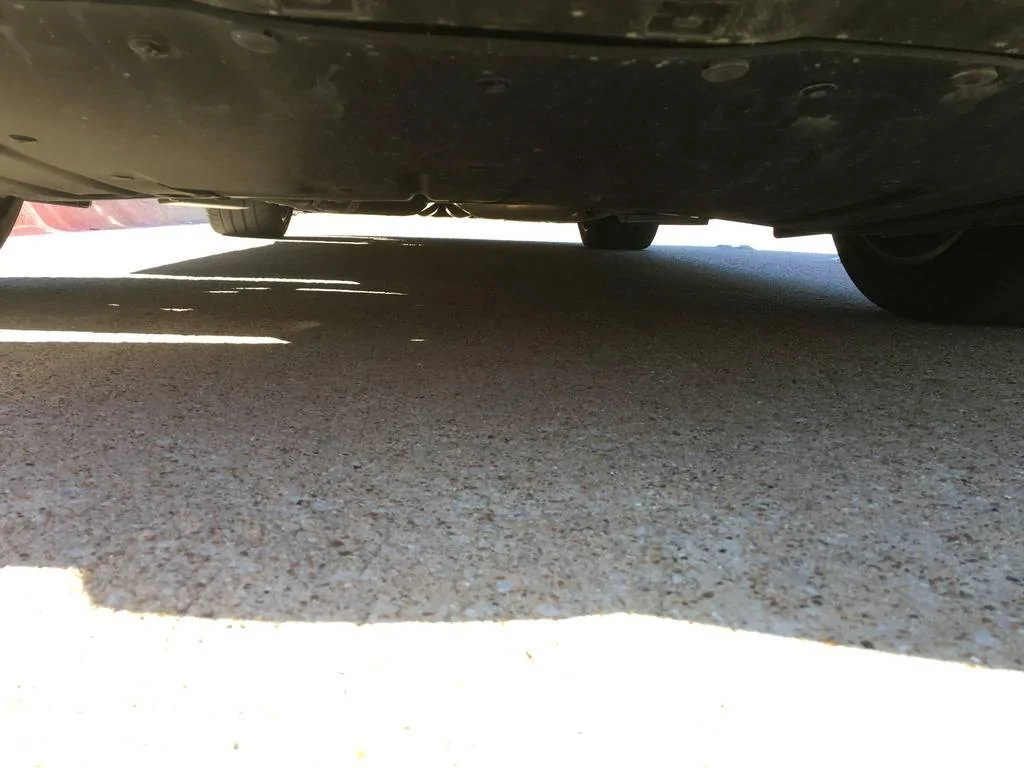

I took the following 2 pictures after the car was sitting for 10 minutes after the incident:
NOTE the car was off at the time this photo was taken
I suspected that maybe the oil filter spun off. I did my first oil change, and have checked the torque of the filter a couple of times since. Haven't had any leaks or noticed the filter loosen. No leaks under the car after sitting on the side of the road waiting for the tow truck.

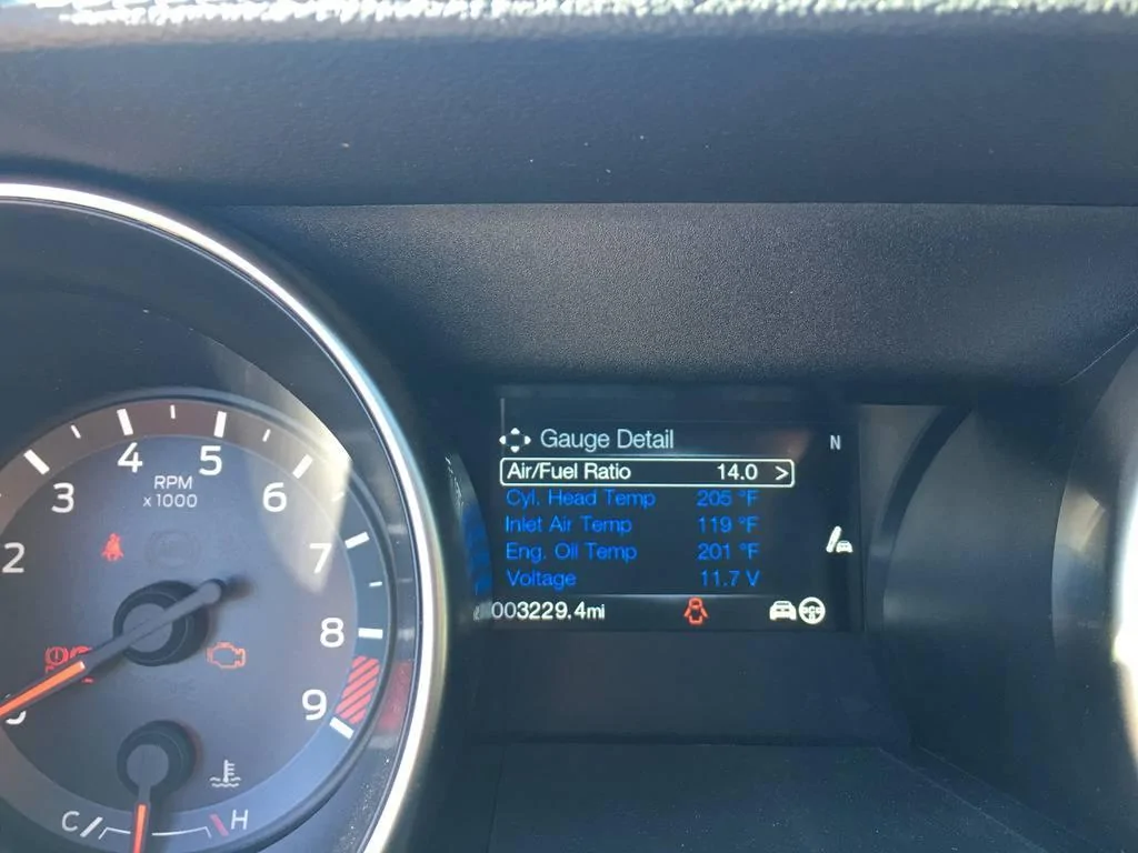

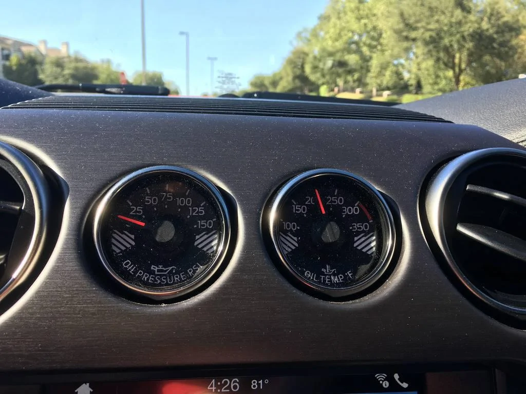

My numbers the car was reporting after unloading it from the tow truck at the dealer. They won't even start looking at it until next week sometime.

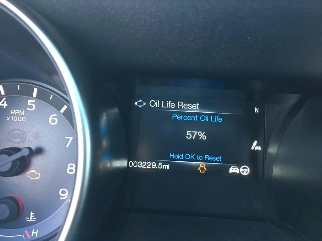

Went back to the dealer the next morning (car hasn't been worked on or checked yet) to get pictures of dip stick and car's reported oil life percentage.

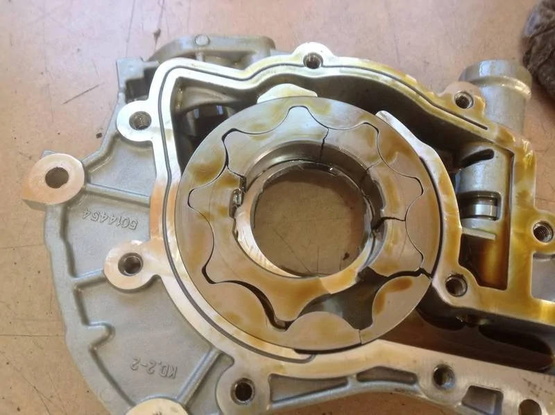

This happened to me last month with my Whipple GT, and it wasn't good for me, and I fear it's not for you either. OPG failure is the likely culprit and motor bearing are hurt like mine. The sound you heard when coming to a stop was what I heard (Oil pump gear shattered) and clanking around. Here is my thread thread on my failure. I'm sorry it's sounds like bad news for you my friend, and I'm surprised this happend to a non modified engine.

Wow that is a telling picture on OPG failure. Might have to go billet.
