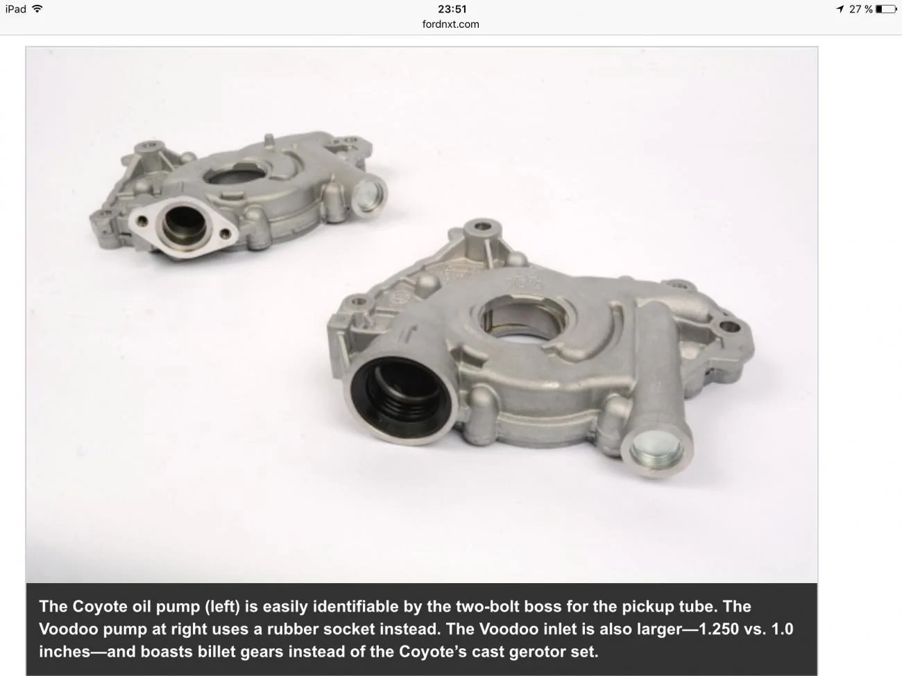

I wasnt trying to cause a heated debate. I fully understand why its a very likely suspect, but being a mechanical engineer I've seen enough cases where the smoking gun was not so smoking when the full failure analysis was done.
I honestly managed to miss the cases where owners had documented the OPG failing and was asking for someone to point me in the right direction since they seemed very familiar with the other cases. It was all burred within that 24 page thread above so it managed to slip under my radar.
I mean no disrespect to you at all. And I'm not trying to argue the fact. But the number one cause of oil pressure loss on the mod motors are the opg's. The reason why you hear so many of them on the 5.0 is for a few reasons.
1) blowers.
2) owners doing their own mods and advertising the failed gears.
3) owners talk about it, dealers / ford doesn't.
The voodoo uses the same gears different housing.
The oil pump housing is engine mounted.
The inner gear is on the crank snout.
The outer gear is centered by the housing.
At cold temps the oil is more of a solid.
At high RPM the crank snout flexes. While the oil pump housing is fixed and does not move with this flexing.
When the crank snout flexes, the crank oil pump gear moves also and changes the OPG clearance to the outer oil pump gear.
When the clearances tighten up the gears fail.
It's really easy to realize this.
I blame ford for this because all the years of opg's that failed on mod motors they should of added billet gears to the voodoo, even the 5.0 should have them if you ask me.
Even if ford did admit the opg's failed on the voodoo, you'll likely not hear about it because a handful out of 8000+ isn't considered an issue to them.
I have a good relationship with my ford dealer and it's parts department. I keep asking about the oil hose issue but still no news on when exactly when they will be available. If you ask me, I really think this is poor business on fords behalf.
So here's the thing.. the old SBF design had a drive shaft that turned the oil pump from the bottom of the distributor. If something got into the oil pump and stopped it from turning, the drive shaft would fail. Or sometimes (even better) the cotter pin on the distributor would fail, and the engine would immediately stop running.
Now the oil pump is mounted to the crank shaft. No way is the crank going to fail, and you don't want the engineer to design the crank to fail either. So that leaves the oil pump. I can't argue that potentially there's a design flaw in the oil pump Ford put in tens or hundreds of thousands of vehicles, but I can side with an engineer designing the OPG to fail before the crank or the oil pump housing fails.
2 cents.
Voodooo
Nov 2, 2015
107
5,821
2,399
SE Michigan
Scott
Carroll Shelbys Soul Lives Under My GT350 Hood
2 cents.
Correct I know the SBF / BBF oil pump design. I used the 3/8" round Chrome Moly shafts myself. I also used a solid dowel pin instead of the rolled pin. Along with a bronze gear. I also screened all the oil return holes.
No where did I say the crank is failing. I said the crank snout flexes which it does. And what you said makes no sense.
You said " I can side with an engineer designing the OPG to fail before the crank or the oil pump housing fails"
Once the OPG fails the engine is over! Including the OPG housing.
:headbonk:
They should of added billet gears.

I never said the pumps were the same. The OPG is exactly the same. You're also assuming the OPG is IN the pump.
