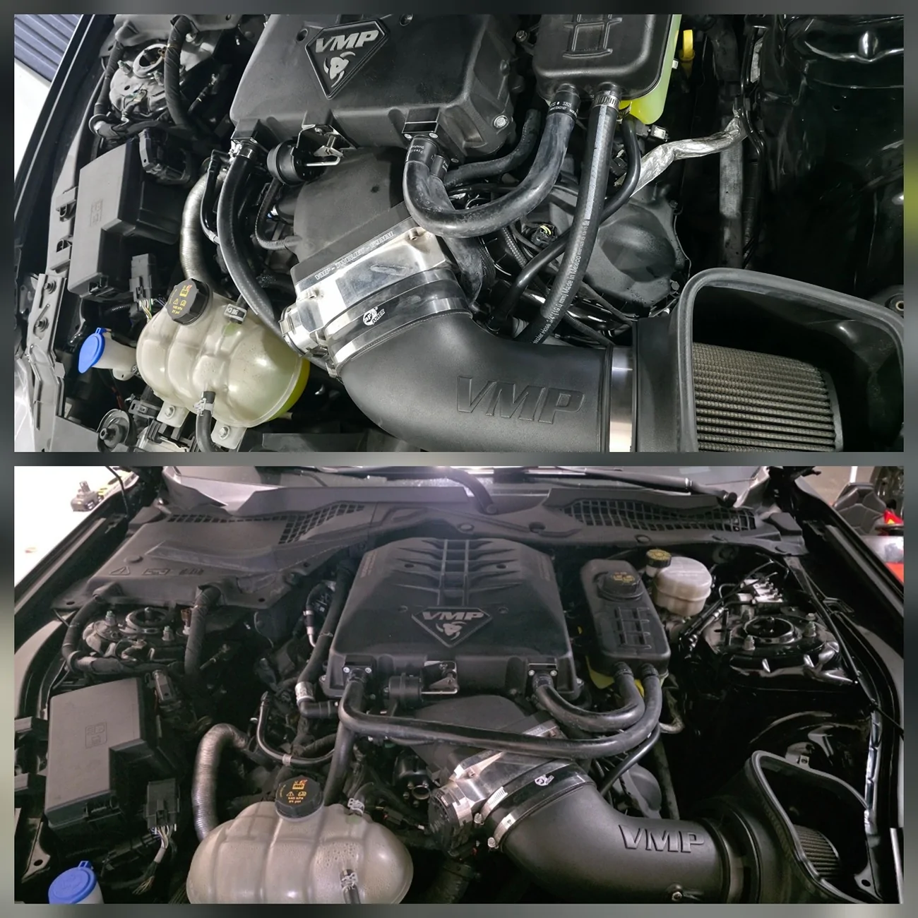

Well, turns out we have a test and tune tonight as well, even though they never put it on the schedule. Ended up making a few changes.
- Retightened everything, there was a decent bit that could be had on intake-TB coupler.
- Rerouted the cross coolant tube, it was run over the TB, and was slightly getting pinched with the hood closed. I think this was allowing a bit more heat than anticipated.
- Unfortunately, boost gauge wasn't here on time to get it in (Nor do I have the adapter for Forscan). Thanks Amazon -.-
- Going to try running a little less pressure in the NT555R2's. And this time remembering to take the gauge with me for checking between runs lol.
But after doing the retighten, and coolant hose, watching the dash vacuum, on tip in it goes to zero FAR faster than previously, so I wonder if I had a small intake leak throwing it off.
