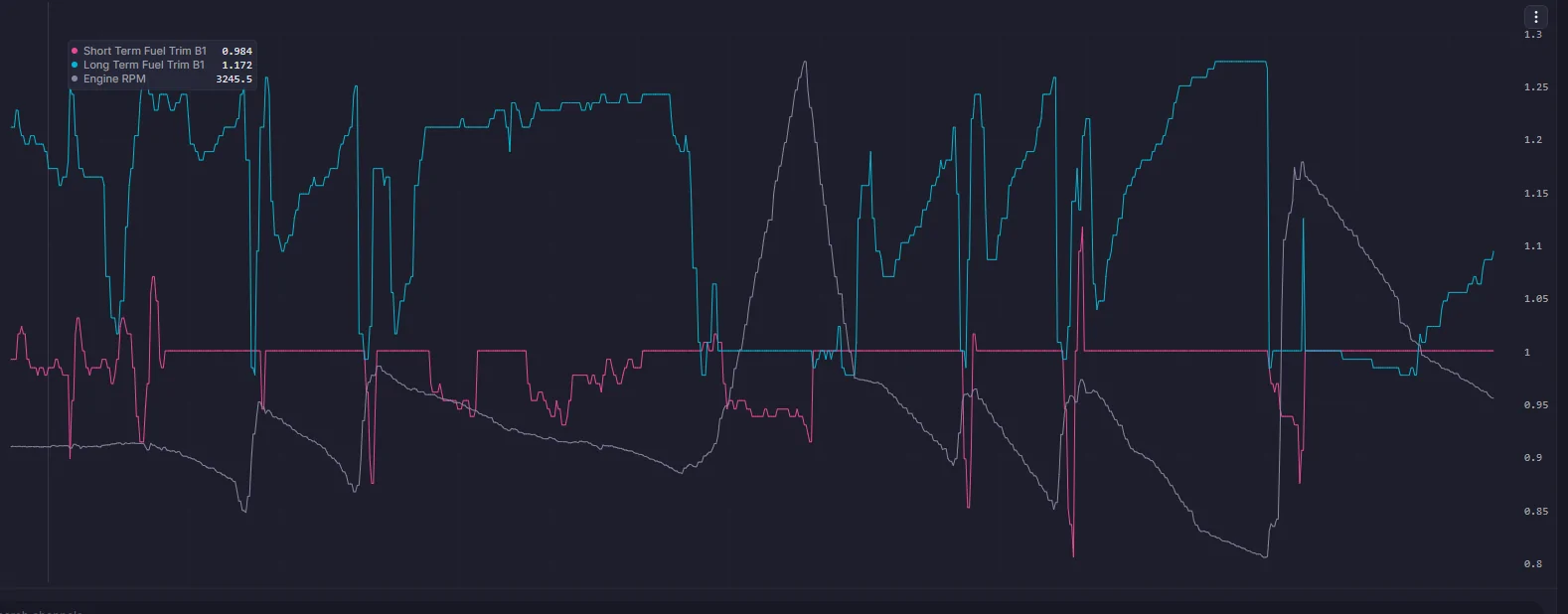

Long term fuel trims over 1.20? What's going on there
Not going to lie and say I know what to look for fueling wise lol. I know enough from previous coyote logging to watch your typical knock etc. But couldn't tell you what to look for fueling wise honestly. But it does look like a LOT of 1.2+

Ok, good we have a log now. The throttle is going WOT as soon as the pedal goes down at 3500 rpm, load at WOT is 1.5 to 1.7, timing is a little lazy starting at 11 and building to 17 deg, lambda is .76, cam timing is running where it should.
The WOT load of 1.5 to 1.7 isn't boost, but it's closely related to it. 1.5 is generally around 8-10 psi and 1.7 is getting up to the 12 psi range. This boost curve is exactly what I would expect for a pump gas PD setup.
The timing is causing some loss of performance. Many tuners will start it out with a low borderline timing and let knock advance add it slowly. You start out at 11.5 deg at 3800 rpm and it slowly climbs, which is hurting your midrange torque a bit.
I don't see anything in the log that says the boost is low.
