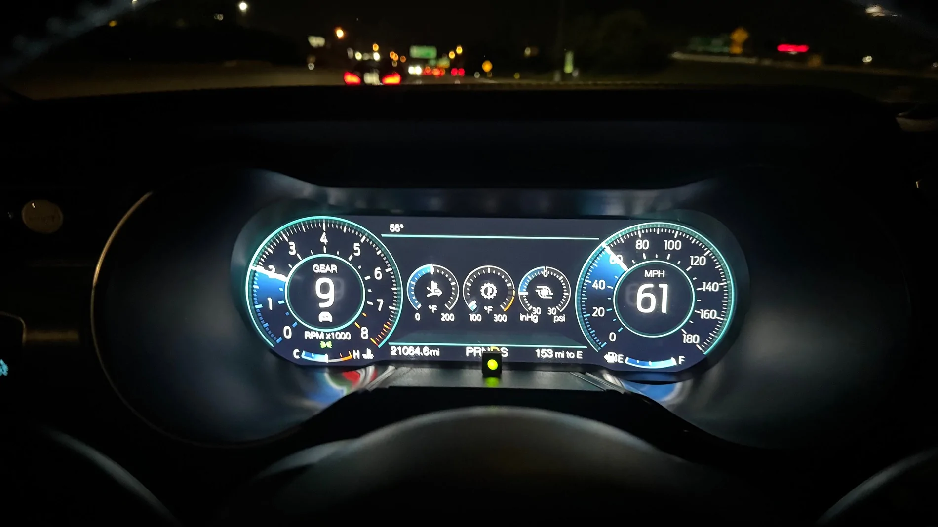

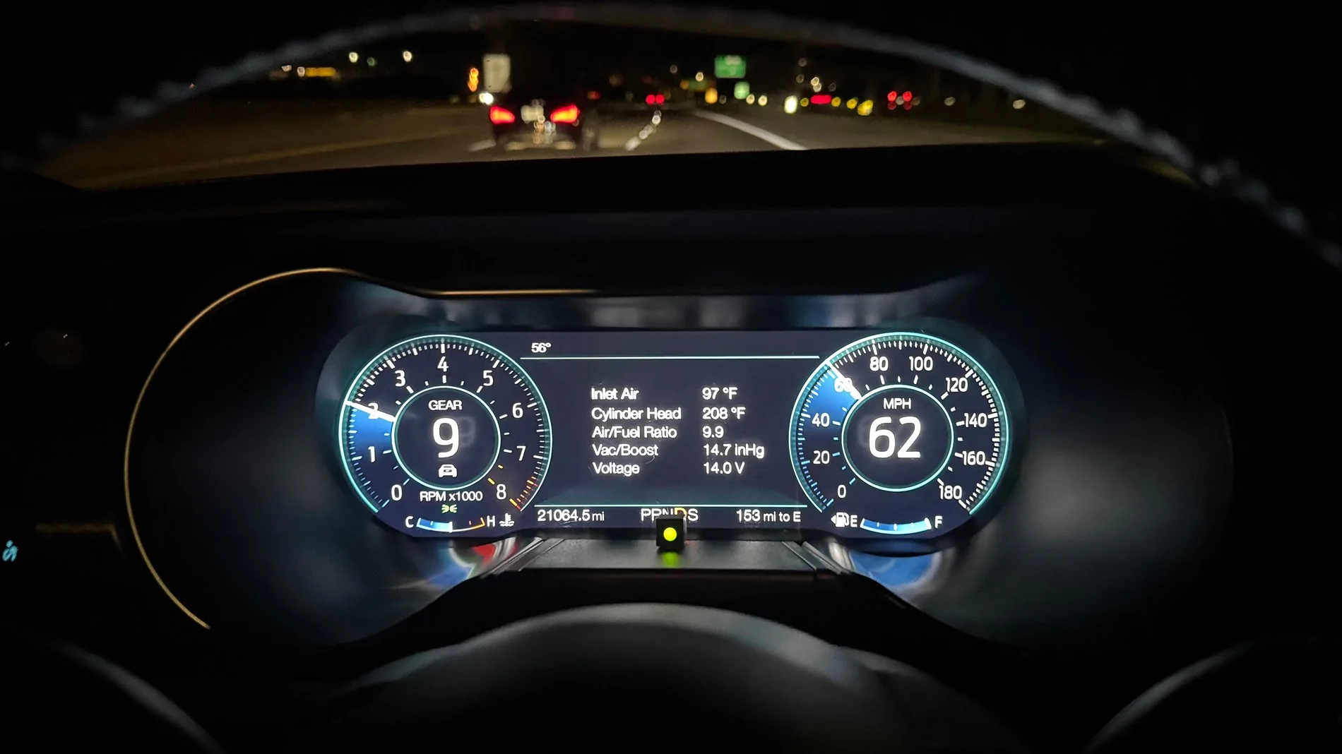

Do you have a way to log Load while driving?
Or you can enable the boost gauge in the dash, so a search.
I agree something is wrong.

If you have Forscan, you can enable the factory boost gauge. It is not super accurate, but it would let you know if you are in the ball park.
Yeah, I’m using the factory setup and it neat but not sure how accurate it is.
