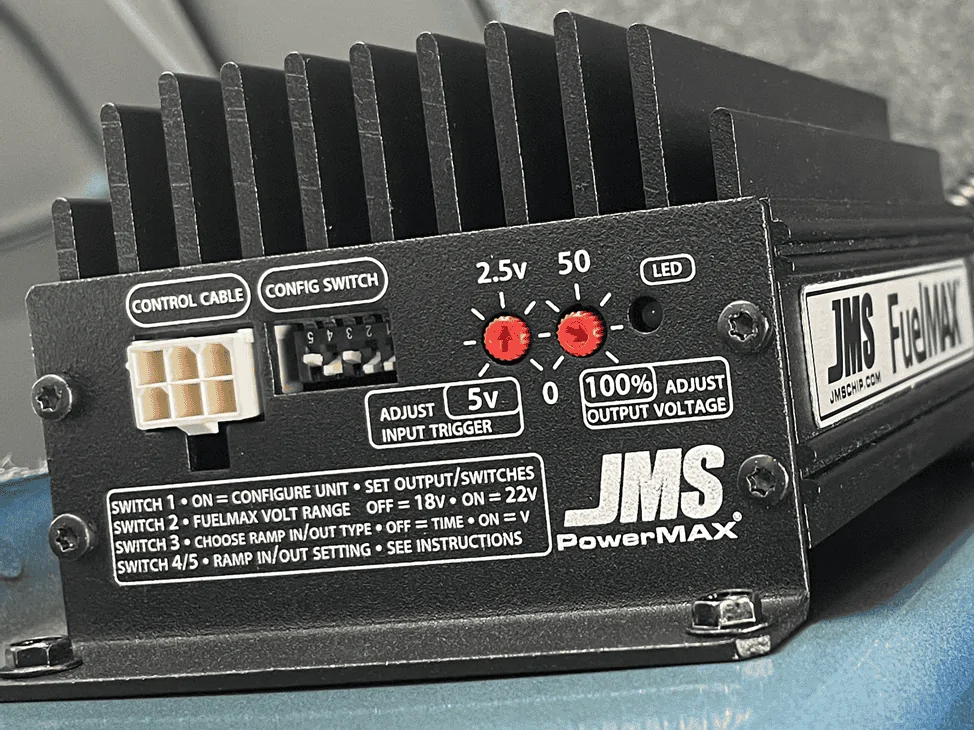

I'm going to start chipping away at the easy stuff. I think I'm first going to confirm that the booster isn't causing the issue by setting it to a constant 14.5v. I'm running Roush's off the shelf tune that doesn't require the pump volt booster. From what I saw during the install the booster is controlled independently based on throttle position.
My booster came preprogrammed:
  • 14.5v to 18v output (my inceptor gauge reads 20v at times)
  • 2.4v input trigger
  • 0.8v ramp

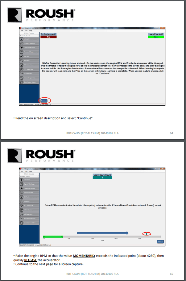

I'm running a Roush crank pulley. Next time I have the undercover removed I think I'll confirm that the pulley is still torqued (~135 ft-lbs) then relearn the RDT misfire correction.

problem with not having a booster with a returnless is if you get into long pulls, without it your fuel pump may not be able to keep up even on 93. I'd highly doubt it would be causing a problem, since I have had mine on for 2+ years with no problems.

Would only flip it to constant 14.5v before warm start to see if the issue still occurs.
I don't expect it to be the root cause but it's an easy test. I drove with the booster installed for a couple weeks before doing the SC and don't remember having issues.

The jms booster shouldn't cause a hot start issue. It only boosts the voltage once you hit a certain pedal position.
