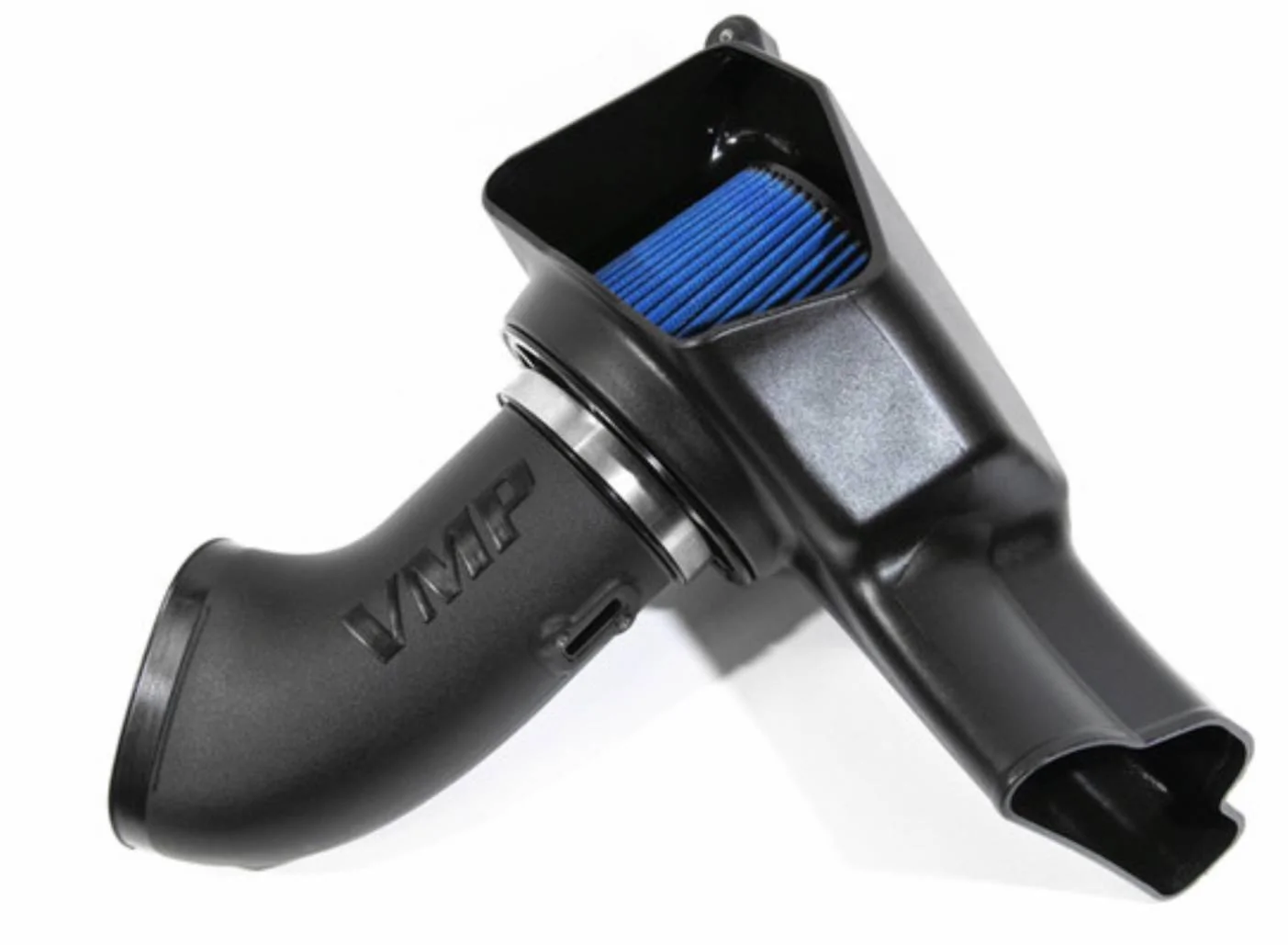

Does the pic below accurately reflect the airbox VMP supply? (Eg. Open top).
If so, this would go a long way to explaining your IAT’s in traffic.
Just remember, all that hot air passing over the IC is actually heating the water in your intercooler system.
Looks like a really bad idea to me.

I live in the Savannah Georgia area and usually see 30 to 40 degrees over ambient running and 50 to 60 over in traffic. I think an airbox lid would help but not sure that enough air could be drawn from the grille under boost. I'm not an engineer however.
Edelbrock don’t seem to have any issues with their closed lid air boxes, nor do Whipple. Yeah, ok, if you’re running a tonne of boost and looking for ultra-mega power, it could pose a restriction, but for the majority, it’s perfectly adequate. Certainly better than slowly boiling the water that’s supposed to be keeping things cool.
