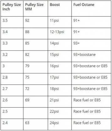

This should help with pulley selection.
it dosent say anything about how to measure the pully or the boost nor the mm to inch conversion. According to that video I have an 88 mm pulley it says 3.5 on it the 3.2 I purchased according to them is the same thing as an 85 mm pulley last time I checked there's 25.4 mm in an inch. And I watched that video before I posted

My stage 2 Odin kit came with the 3.5 in pulley. In the video I think they call it a 92mm?

This is the photo from lethals website that vmp wants to pretend dosent exist fyi. i measured the 85 as 82 so when i get my 3.2 in the mail ill measure that as well as my 3.5 when it comes off and maby i can answer my own question
