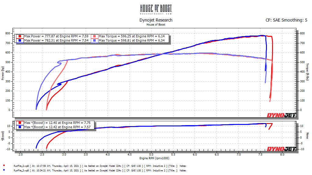

Update on mine:
did VMP P&P fuel setup
makes great power on 93 as shown below, 88mm pulley.
I was on 29.5” radials and couldn’t get a clean number on E85 and the 72mm pulley. Though it was deep 9XX. Bouncing/spinning.
Those are some big numbers on 93 with an 88mm pulley. I have the exact same setup and made 700/562.
dunno if it matters but I’m future proof with id1300’s on my system. My car just has always liked making power on 93. On E it’s right in line with everyone else

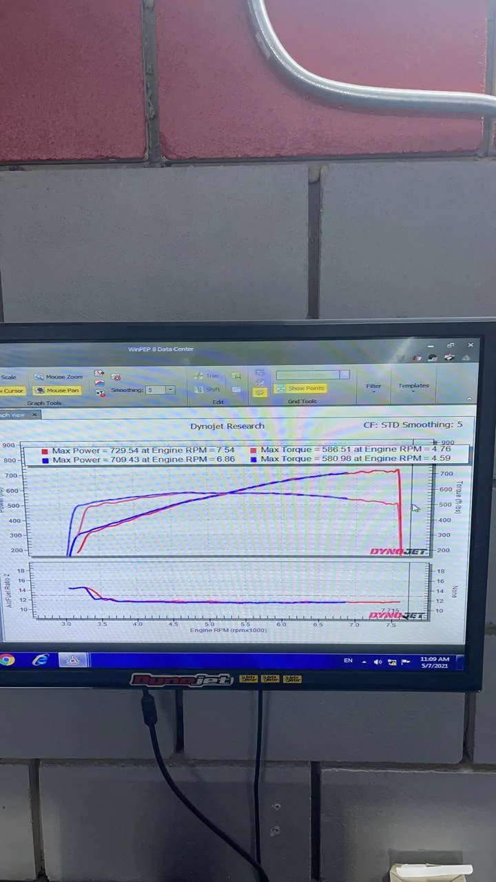

two days back I dynoed my car and made an impressive number as seen below! However, the car is still having a weird cruising idling! To describe it more, when I try to hold my foot on the peddle to drive in a fixed speed. The car would rattle back and forth and the rpm would fluctuate +10 or -10 !!! Also, I've been seeing this code popping up and sometimes after I clear it up it would still come back randomly! The code is P0300 Random /multiple cylinder misfire! spent hours reading everywhere and decided to do Crank r-learn though my Nguage as you might know won't help me do that! I tried my friend's SCT and hello another two code came up : U0422 & U0140 and I believe P0306 along with the P0300. Like I said, the throttle response is no where close to the stock feeling and there is a one second lag let's say! The tuner said is probably the SC bypass ? On top of that, I have witnessed multiple shut downs usually when cornering slowly going from 2nd to 1st and sometime straight @ very low speed it would die!
The Tuner asks for datalog especially when the car dies suddenly. I don't know if that would point out the issue since it might be a bad installation to : spark plugs coils but hey again I am not thinking that cause the car made great power and mostly drives well except when I try to downshift or maintain a fixed speed.
Note: the run was made in 41 C with W/M to eliminate the positive knock.

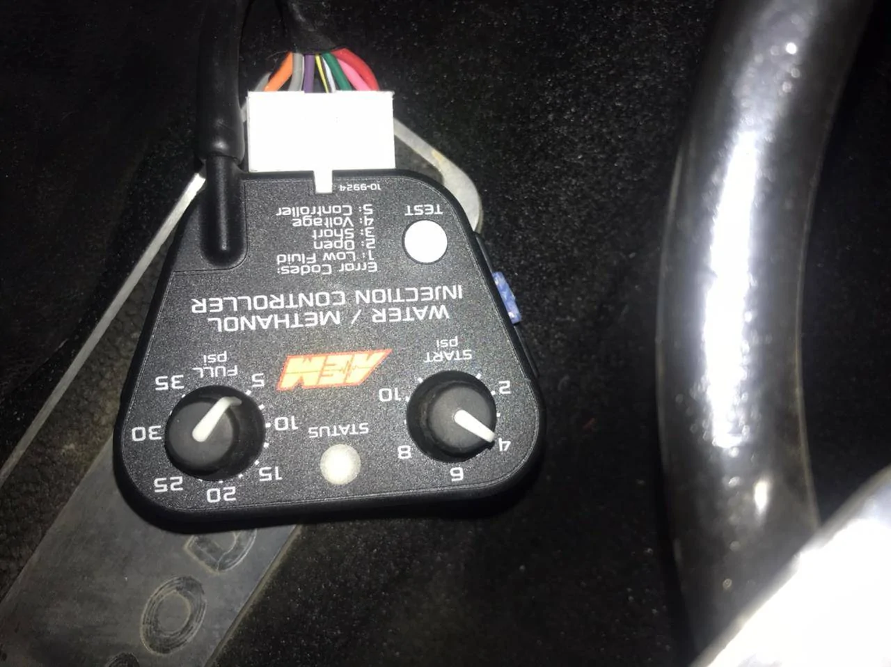

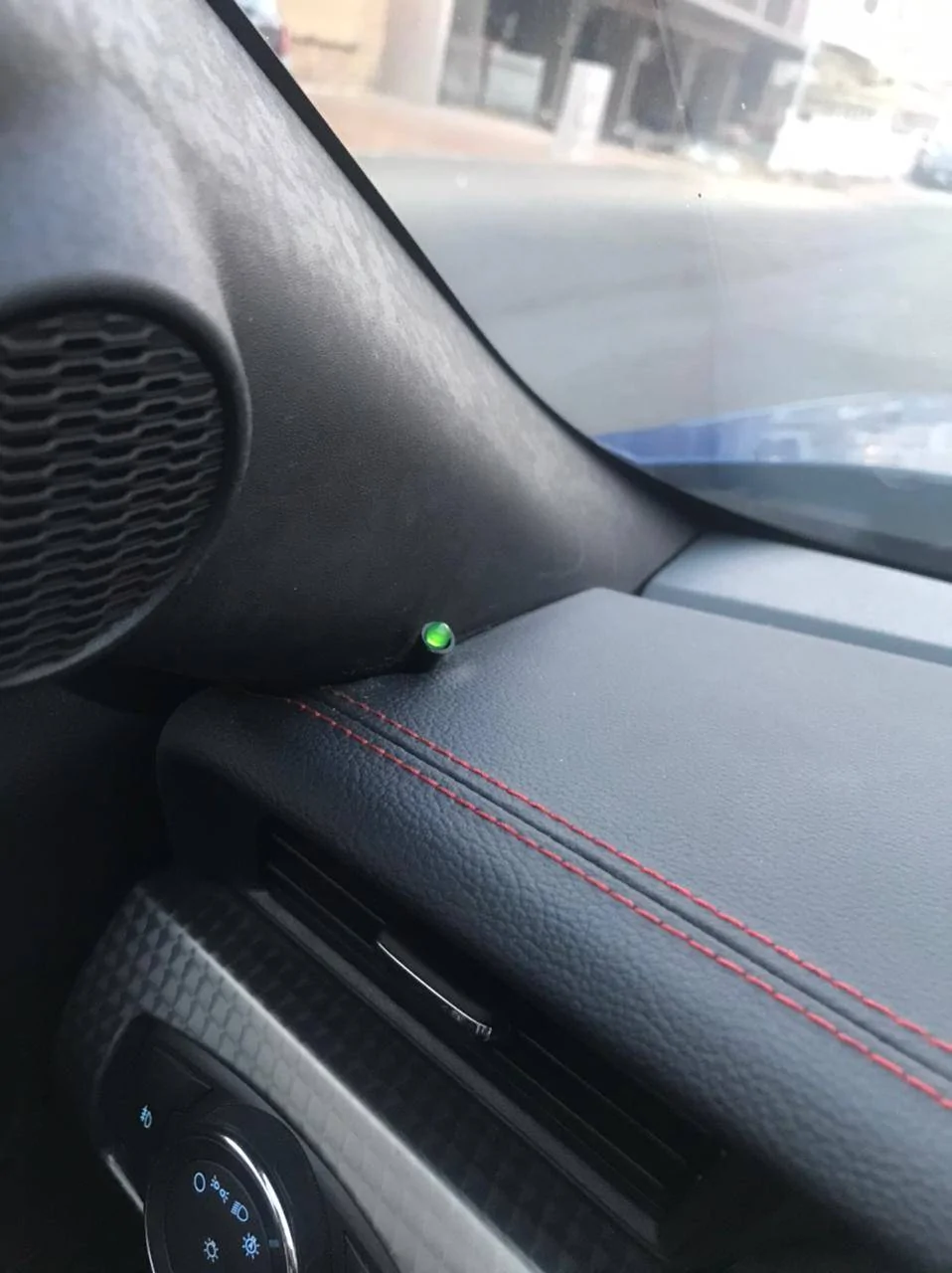

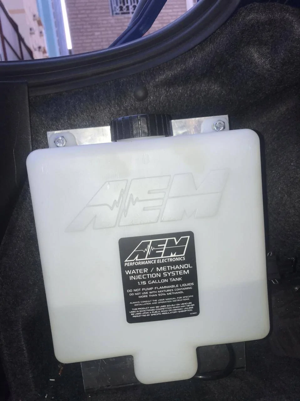

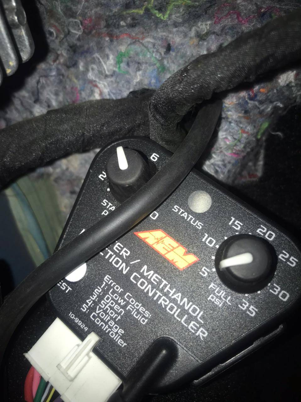

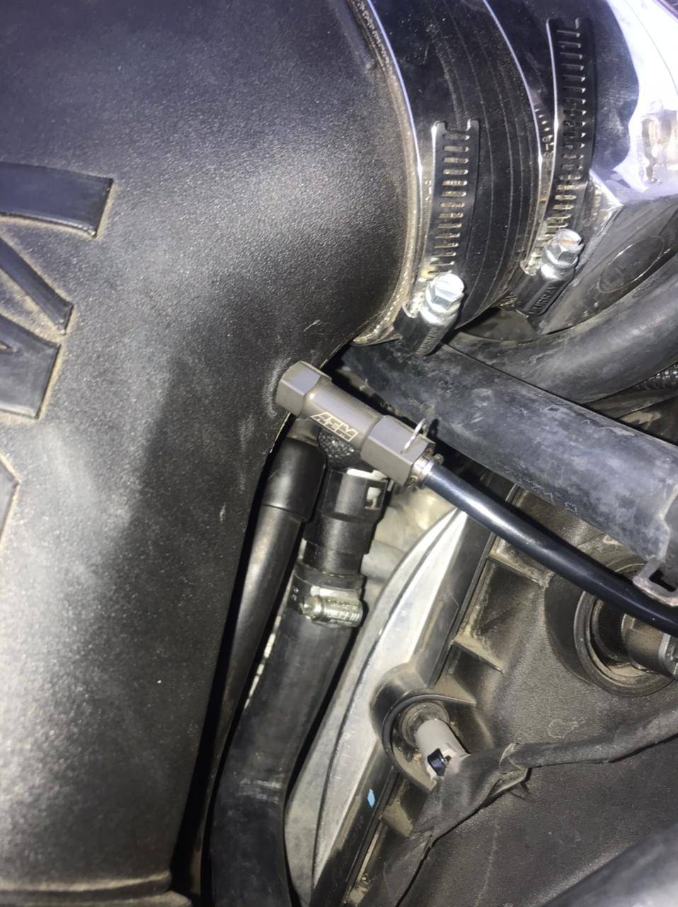

Tell me more about your meth kit!! Pics as well if you can take some!
Hi Torinate,
I uploaded the W/M pics if you're interested.

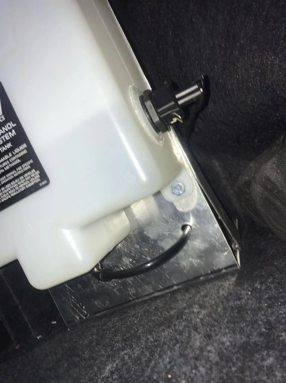

Looks great.
You put the tank in the trunk?
How are you liking the kit? Have you noticed a change to iats or performance running it?

Looks great.
Yes you're right. The tank is in the trunk where the pump is located in the spare tire area.
The kit is extremely helpful in hot climate and it did the magic by reducing the head temps from around 94C to 80'S so we're talking about 10 degrees drop which is of course amazing. Highly recommend the AEM W/M to sweep away the knock and cool the engine as well. my mixture was 70/30 Meth/Water. The car has more potentials by adding boostane or race fuel as per my tuner. Around 60whp more! and I told him I don't want to be harsh on my engine and really happy with the outcome based on crappy pump gas we have around here. Still getting the P0300 Multiple misfire code and will try redoing the Crank relearn and if the issue didn't go away then it's %100 tune thing.
