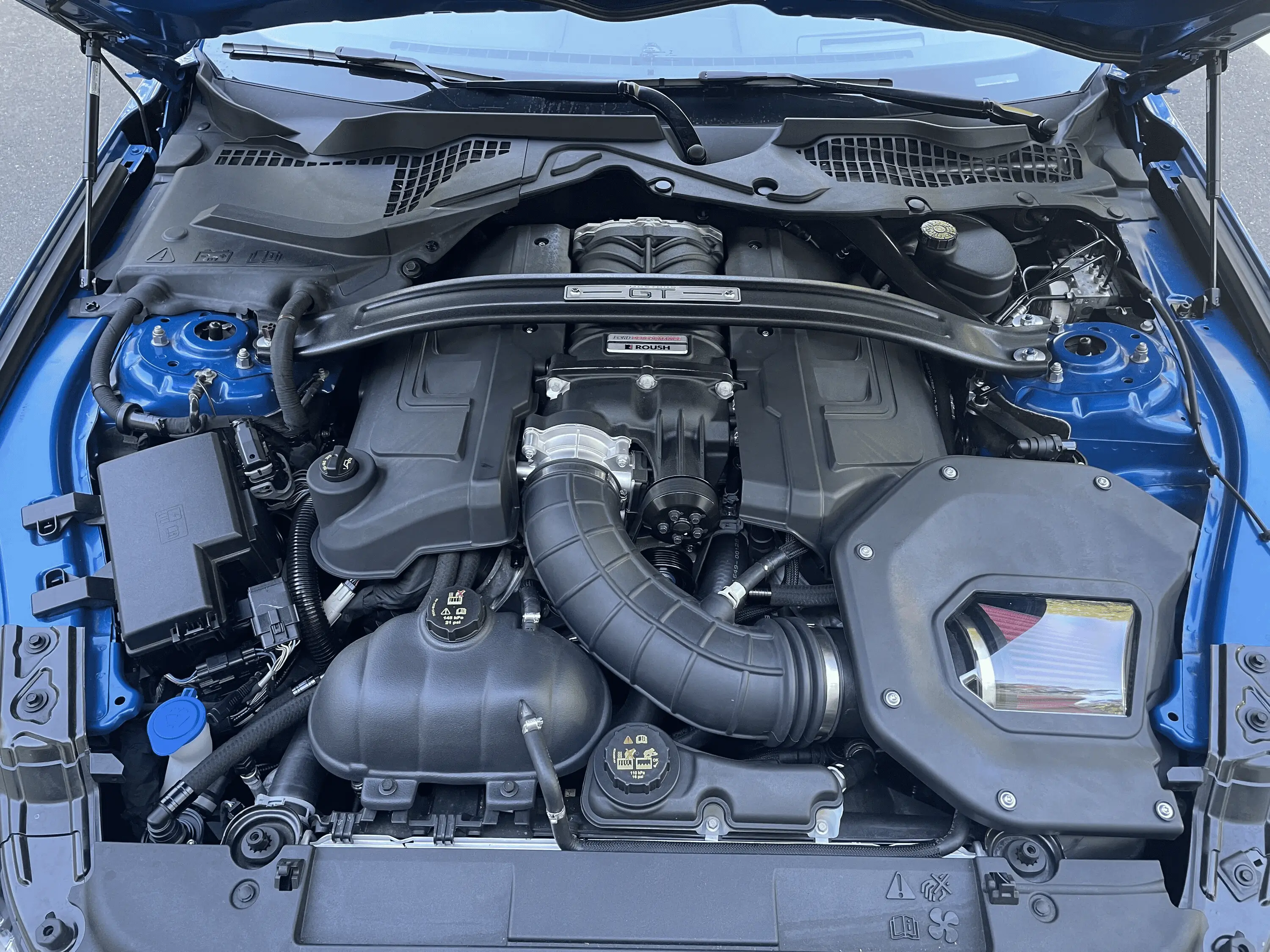

What spacer plates are you running?
How much did they raise the blower?
Did you add a thermal blanket under the IM as well?
Spacers may cause clearance issues with my setup. Not looking to ditch the strut tower brace or replace the factory motor mounts
The heat shield on the lines won't help much because it's the heat transfer to the rails that causing the problem.
I have harrop spacers. They are 3mm thick( something not thick at all) We reused the stock mounting bolts. You have a PD blower with the strut top?
