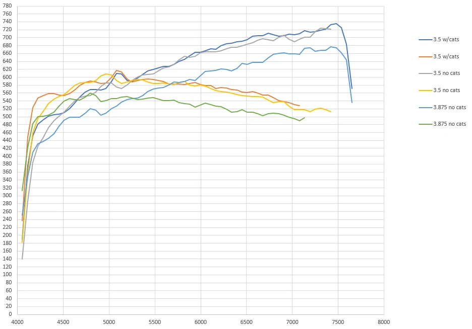

Before yall go dogging on the cats (sorry, I had to) see the attached dyno graph. Gray is no cats, dark blue is with cats. Shocked all of us. These pulls were one car, same dyno within an hour of each other. We actually installed cats without even taking the car off the dyno then immediately did another pull.
Not saying cats are an issue if they are unclogged. I have cats on mine still, but a clogged cat can creat excessive back pressure reducing power output
