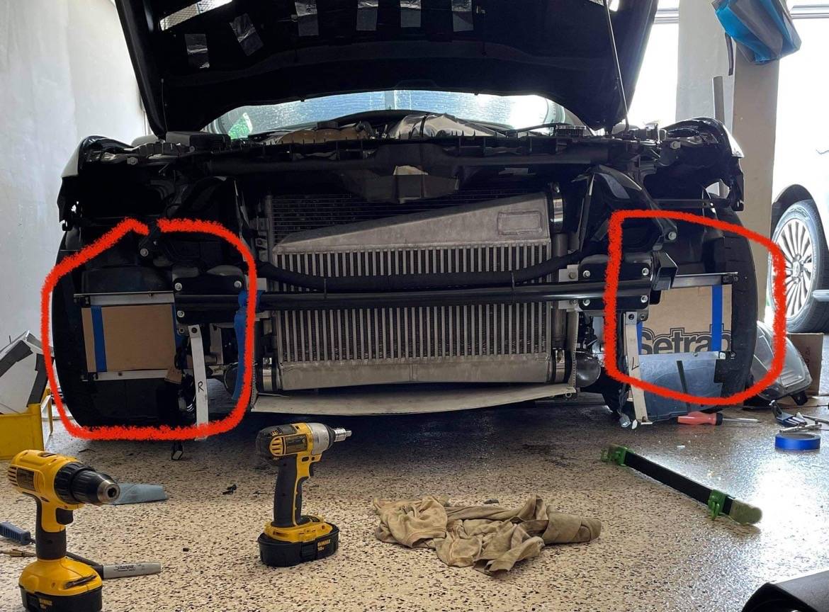

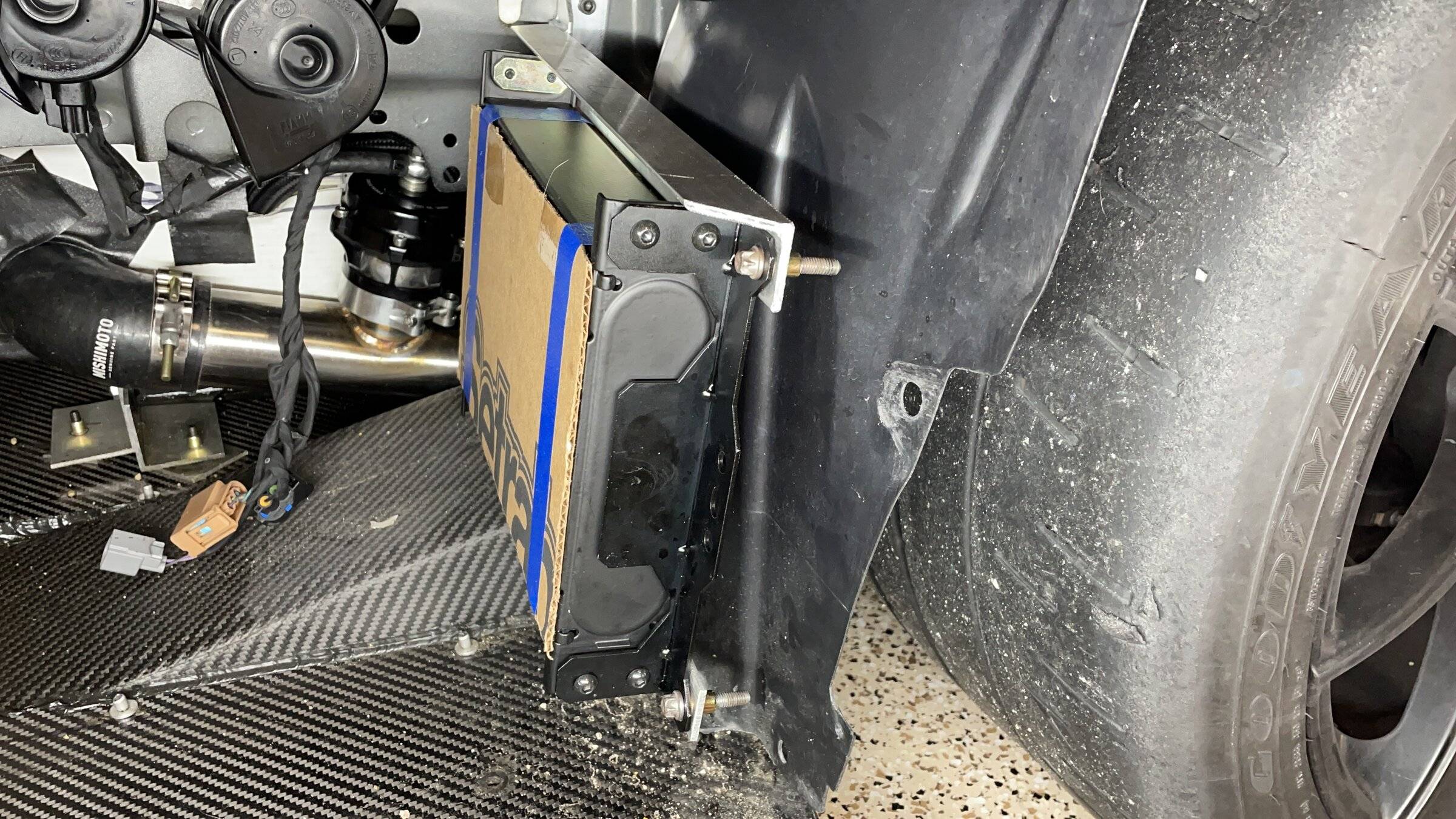

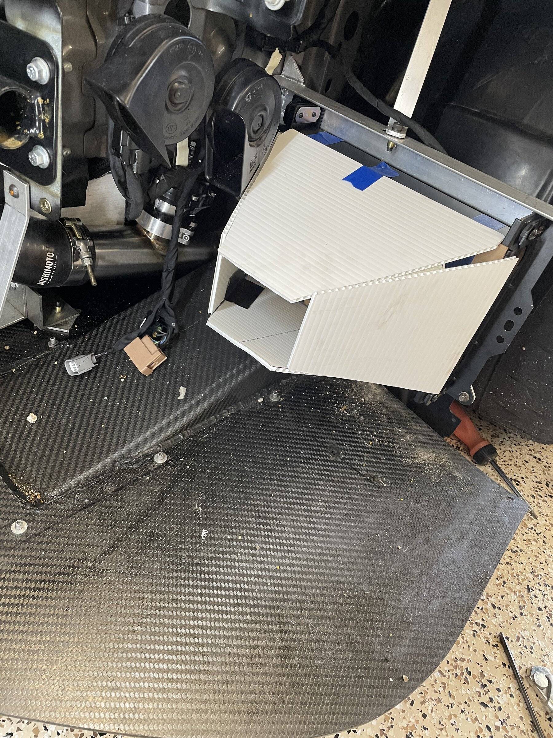

So I eventually gave up on the large oil cooler in front of the radiator and made brackets to hold 2 smaller coolers in front of each wheel. It was a lot of custom, measure plenty times type work, but the end results seem good. The air comes in through the spot light holes, and then I made a box around each cooler to force air through. I drilled holes behind cooler in the wheel liner to let air out.
Also what I learned the hard way is oil coolers must be rubber mounted to prevent them from cracking. My old center cooler setup would crack every year because I didn’t mount it with rubber isolation.

I don't know what your fitment constraints are, but if you were to rotate that cooler forward at the top so it was at a 45* angle to the floor, then you would have a very nice cooling air exit path to the fender louvers. As it is right now, you're not going to get much cooling out of the rad because you have a very nice entry path for the air, but there's no where for the air to escape.
You've done a version of what I think might be the best plan. Two auxiliary rads on the sides of the main and then cool the oil with a heat exchanger. You've done it with oil coolers getting the air directly. I'm curious if you pull too much heat out of the oil.

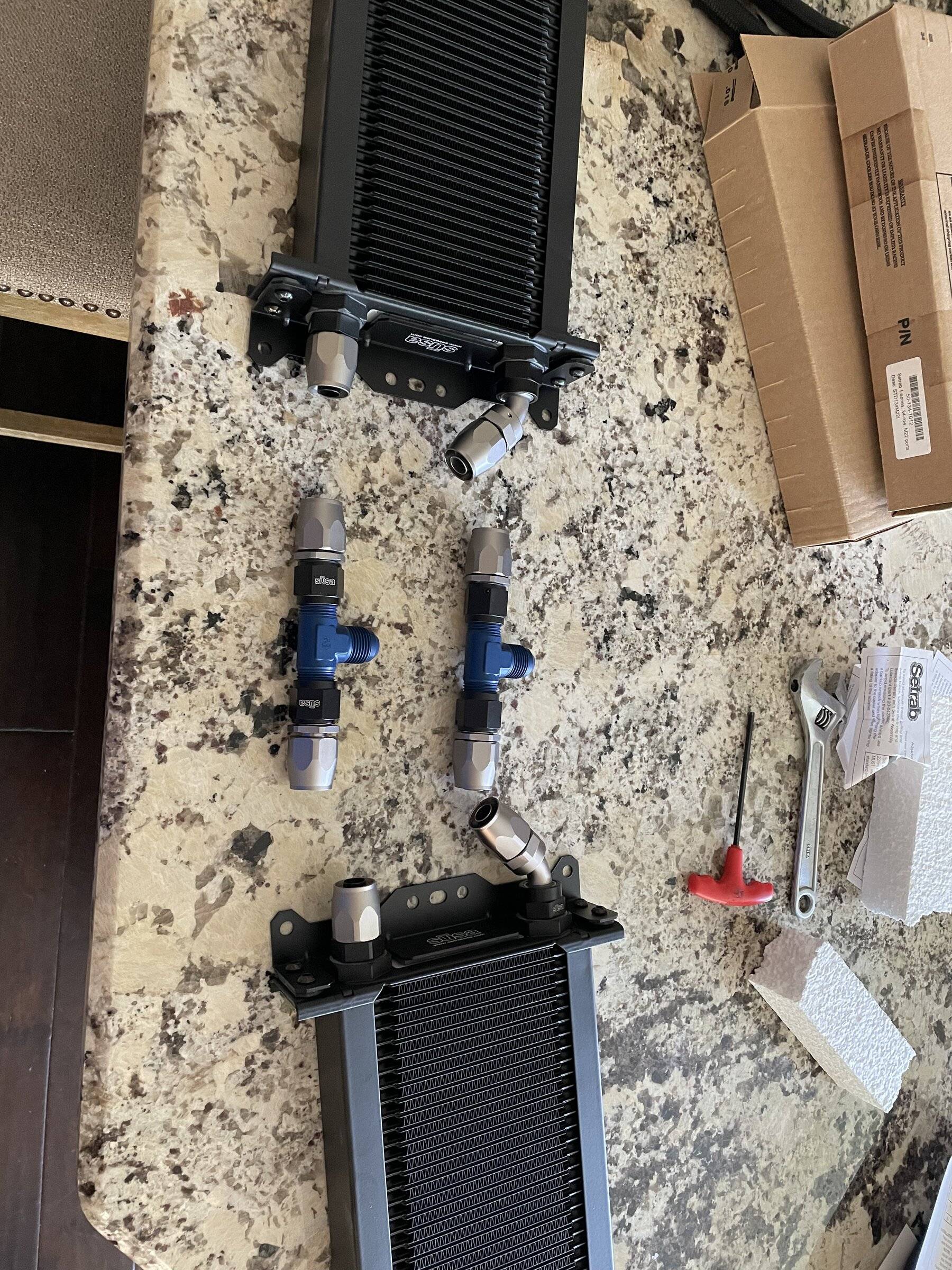

how much 'Shore' on the rubber isolators?
I purchased the setrab installation bracket which came with rubber isolators. It felt pretty soft, like bicycle tube type rubber, with the cooler floating between two pieces.

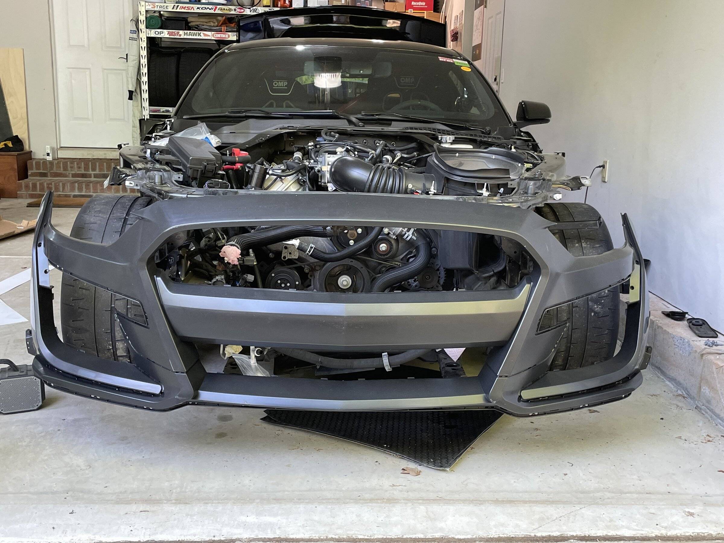

Easier way might be to buy an aftermarket GT500 bumper, from what I’ve seen it seems to have good openings and space in that area.
I did drill a ton of holes in the fender liner behind the cooler to allow the hot air to escape.
I live in Texas, so over cooling is hardly ever a problem, and I’ve still got a sand plate which prevents the oil from over cooling.

I was looking at a GT500 nose last weekend. That'd be the easier way to go, for sure.
On that fender liner, you might have tapped into a high pressure area, in which case the holes are fighting you. If it's not cooling as well as you think it should, I'd take a 2nd look in that area.

Interesting discussions.. after my Tirewall incident I am replacing the whole front end.
Vicerez GT500 bumper, GT350 fenders and liners, triple vent Anderson Composites CF hood.
Plan is to go Setrab cooler on drivers side, behind lower vent. I’m also looking at areas to mount brake cooling ducts. As I will have an APR splitter, I doubt the air directing planes on the control arms will get enough air.
Does anyone have experience using the planes with a flat full splitter.?
Plenty of openings for additional cooling over the stock GT.
