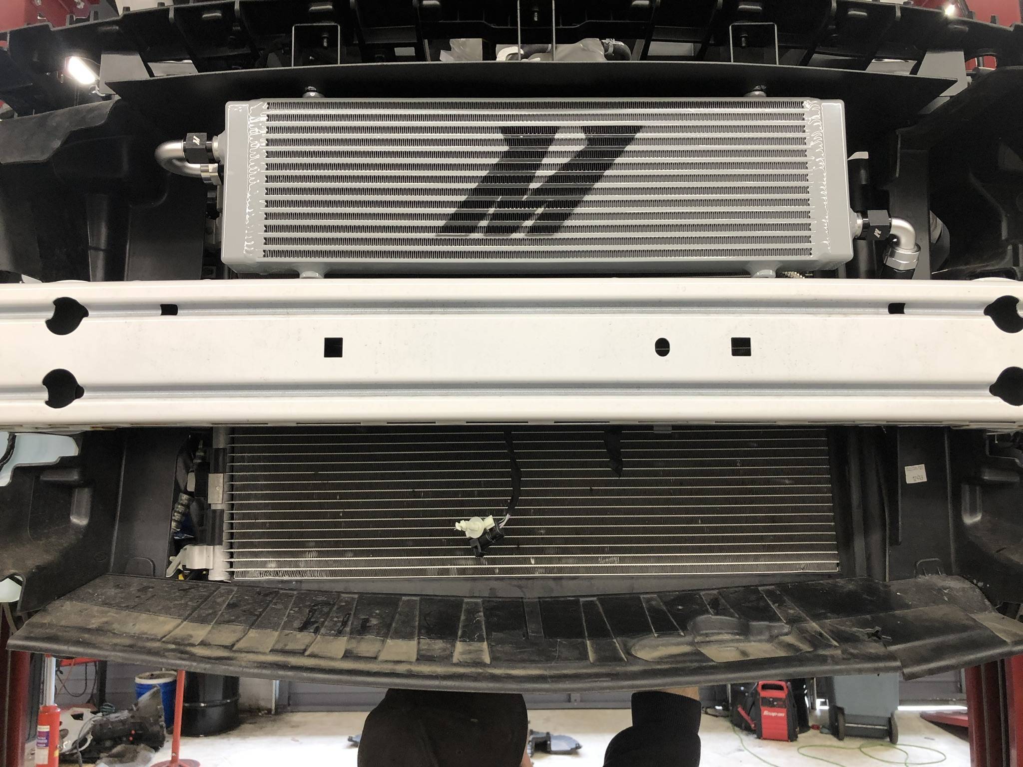

having the extra oil capacity from that large heat exchanger is nice, but that kit requires the bumper belly pan (?) to be removed? if it is mounted paralell it seems that a smaller one with a fan would be more efficient than a large one without.
Kermitz
Dec 22, 2018
766
809
Vacaville CA
Seth
2019 Mustang GT PP1 300A M6
You only have to remove the belly pan to install the Harrop kit. Once the kit is installed, you reinstall the belly pan.
There’s plenty of space for the air to come in through the lower grill, pass through the cooler and exit under the car.
you talking Harrop? the belly pan is intact, even essential to correct operation. I'm probably going to use weather stripping to box the input side. You don't need massive air for any of these radiators to work. about 30mph is plenty. More and all you get is turbulence and stall.

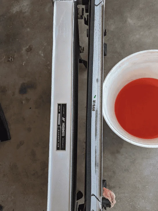

I talked to Ron Davis this afternoon. He produces an Eco radiator with all the factory mounts @ 1.375" thick & $1287. They're all custom with about a 5 week lead.
1.375" seems a bit thin. The Mishimoto core is listed at 2.05" thick. Here is a pick of the Mishi next to the factory PP radiator.

My quote of ewheels was specifically in regards to the Mishimoto Oil Cooler kit for the S550 Mustang GT. If that’s what he is considering, I highly recommend against it.
Flyhalf
Feb 25, 2018
1,619
2,136
CA
www.youtube.com
Alessandro
Mustang GT 18 10speed auto PP1 , GT500 '21
Well I have it since 2018.
15k miles.
It does.a good job for 'normal HPDE speeds or time trials '
For endurance definetely small.
I have it without a thermostat.
For the 10speed guys. please remember to PUT IT IN THE LOWER GRILLE. Cause otherwise you cover your trans OEM cooler
