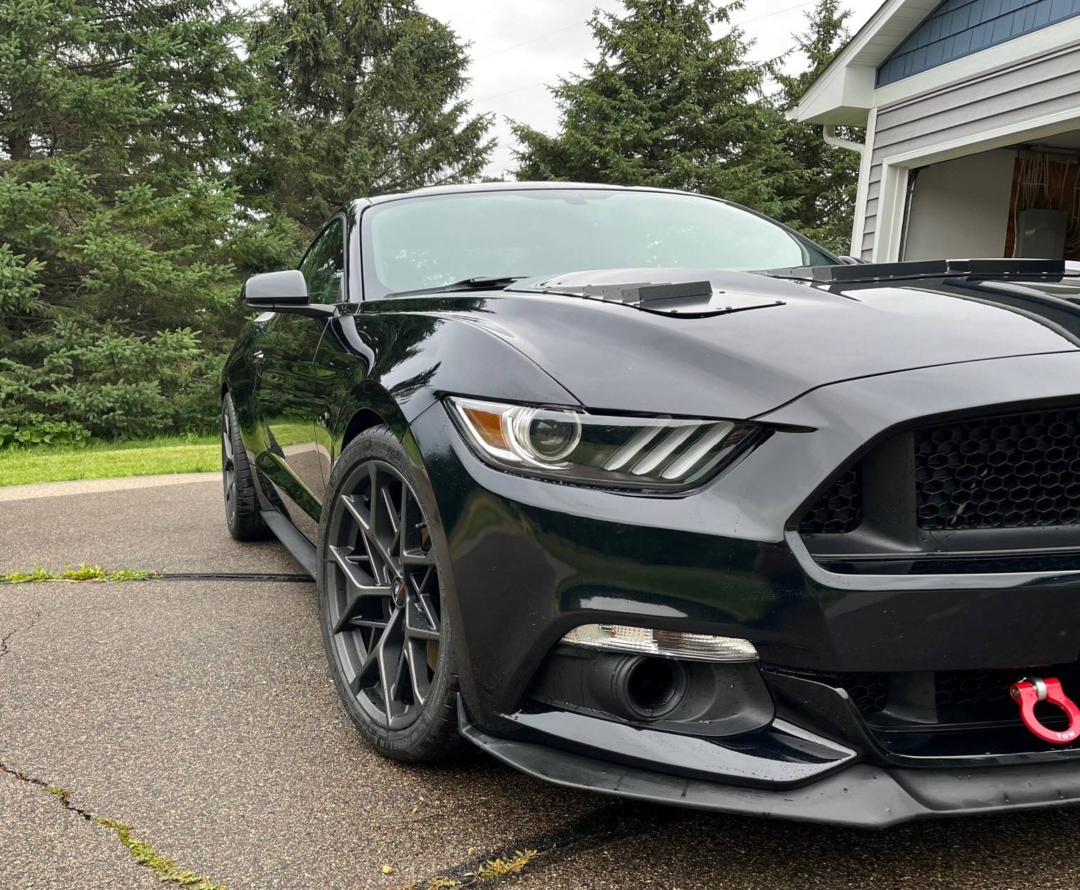

I finally wrapped up my first set of planned mods and got my car out on track. No problems with heat so far! Running Mach 1 wheels with Pilot 4S tires 305 front 315 rear.
I'm using Race Louvers in the hood for engine cooling.
Stock brakes - I added JLT vents from the deleted fog lights, but also kept the air diverters on the lower suspension arms. I just trimmed enough off the air diverters so they don't interfere with the vents. I didn't push the brakes super hard during this first track day. I'm just using good fluid and above mods. They feel a little squishy, but I didn't notice any changes during the day. On this track I don't think I get much over 100 mph, so it probably wasn't too hard on the brakes
I have a Derale 13740 cooler with the two small fans on the rear diff. I also wrapped the exhaust near the rear diff as extra insurance.
For the MT-82 I'm using a stacked plate Derale 51608 mounted in the front of the car above the bumper beam.
Tilton 40-524 intermittent pumps.
I'm using two Spal 185 FH controllers to run the pumps. Right now I'm just using a toggle switch to turn them on and off.
