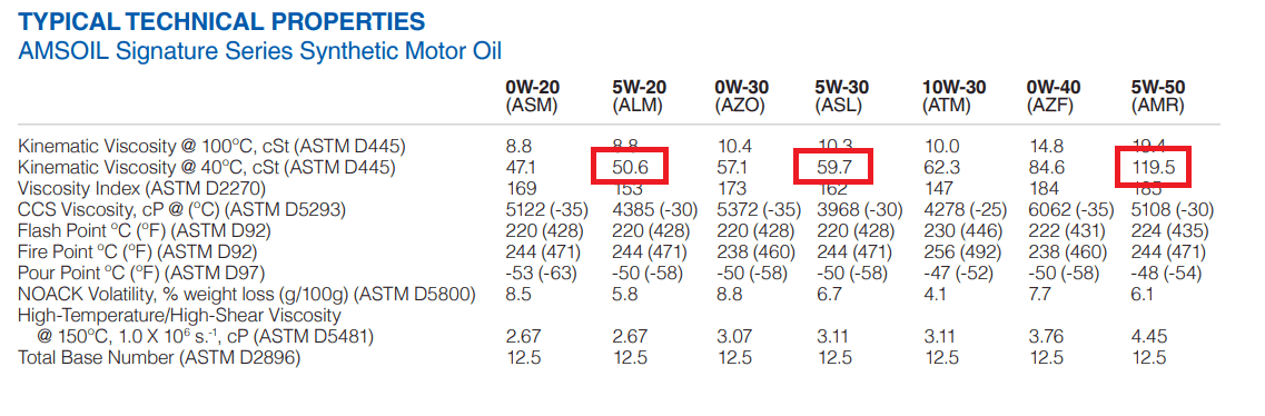

So I was reading this and I need some clarification. Oil specs are (cold)W (hot) I believe. So I think that 5w 20 and 5w 50 are expected to perform just about identically at cold. But when the oil starts getting very hot the 5w 50 doesn't lose viscosity as quickly. Unless I'm not understanding, the two oils should be the same except the 5w 50 costs more and it will hold up to heat better.
I would think 5w 20 and 5w 50 are basically interchangeable as far as function goes - unless you are generating a lot of heat on track. And when you generate a lot of heat the 5w 50 gives your engine better protection.
Correct? Or no?

No.
Even though they both are 5w, they are not the same viscosity when cold. This is because oils that need to thin out to 20 have a different composition than those that thin out to 50. For example, here are the specs of many of the Amsoil SS series of oils. Even though these highlighted are all 5w, look at the difference in cold viscosity. That's at 40* C per the standard guidelines, so at say 0* C the difference is even larger.

Great info. Thanks! I wonder what the comparison of viscosity is at 0C. 40C is pretty hot. Seems like someone did a crappy job with oil viscosity naming standards and the 5w 50 should be called 10w 50 or something.
