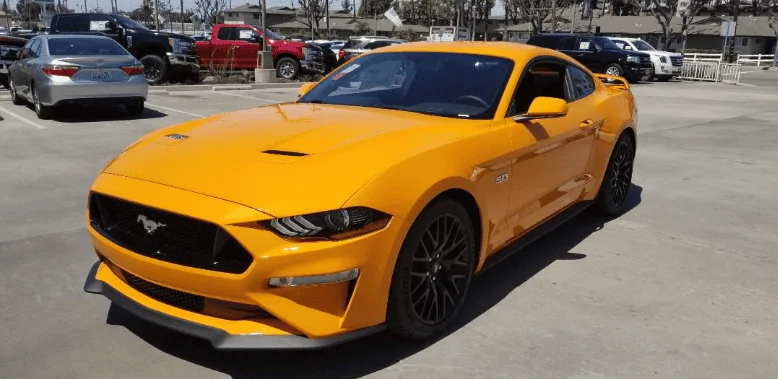

DAY 1
This picture was sent to me from the dealer as they received the car.
2018 Mustang GT, Performance Package 1, 301A Tech Package, Manual Trans, Orange Fury paint. I was in love.

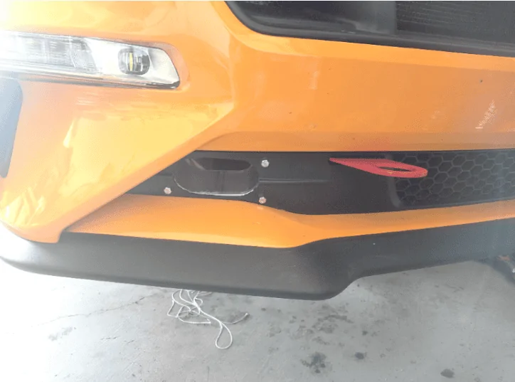

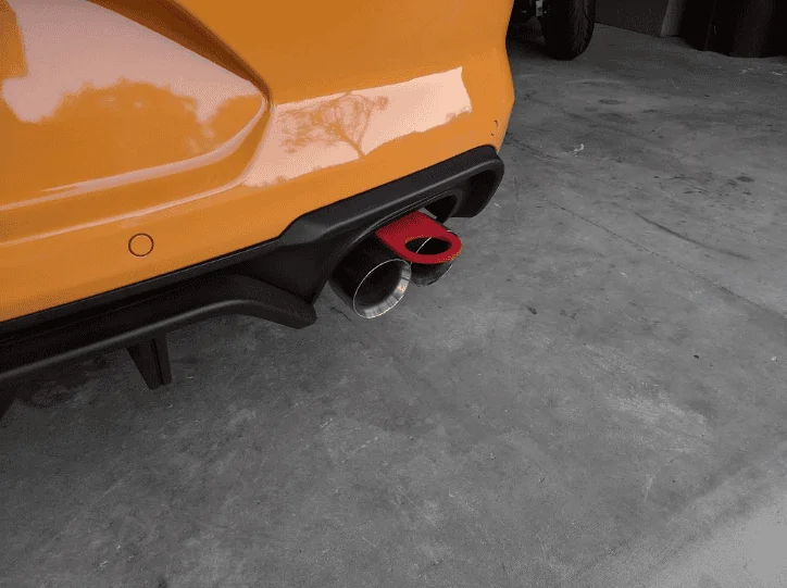

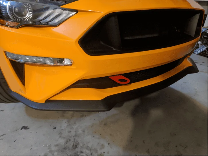

TOW HOOKS
While obsessively reading everything I could about track days and what to expect your first time out, I came across tow hooks. I read stories that if you do happen to go off track and you do not have these, the tow driver will hook onto anything he can find on your car. I personally don't like broken bumpers and suspension components so tow hooks were ordered!
Most S550s I've seen with tow hooks had the removable one in the front and one that goes in place of your license plate in the rear. I didn't like that. I wanted something that I could install once and forget about; and I didn't mind the look of driving around with them on the street.
I found Vorshlag. Their tow hooks didn't require removing the license plate and fit my "set and forget" goal.
My full installation guide can be found here:
https://www.mustang6g.com/forums/threads/vorshlag-tow-hooks.120438/

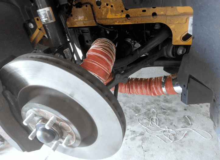

BRAKE COOLING DUCTS
***In hindsight, I should have done this mod AFTER my first track day to quantitatively see the difference it makes. I got too caught up in track prep and I thought I needed a bunch of mods to track at all. Lesson learned.***
This ended up being more complicated of an install than I originally anticipated. I had originally purchased the 4" kit from Vorshlag but after reading their build thread, talking with their customer service, and taking measurements on my own car, I realized that this kit was not what I was looking for. The 4" ducting does not fit well in the wheel wells. (There really isn't enough room at all for brake ducts on this chassis.) The ducts get crushed by the tires (OEM fitment) at full lock and quickly get torn and worn out and need to be replaced. I did not want another consumable. I wanted a set-and-forget system.
Later I found Full Tilt Boogie Racing's kit. They use a 3" duct that can be routed in a way that does not get destroyed by the tires.
So I ended up using Vorshlag's 4" bumper inlets, Mishimoto 4" ducting, some aluminum couplers I found at Home Depot, Mishimoto 3" ducting, and finally FTBR's 3" backing plates. I checked fitment on both sides at full lock and there is zero rubbing.
My full installation guide (and planning process) can be found here: (post #29)
https://www.mustang6g.com/forums/threads/vorshlag-brake-cooling-ducts.120415/page-2
I plan to 3D print some covers for the inlets for daily driving to keep water/debris out but for the time being I'll use tape.
TESTING
I know the proper way to test the performance of these would be to use thermal paint on the calipers or at least get an IR gun but for now I'll use the "feel" method.
I directed a leaf blower into the duct and felt the air leaving the rotor with my hand. I felt almost no air flow at all. A bit discouraging. Then I tried the same scenario but with the rotor off the car and placed my hand directly in front of the duct exit. There was a substantial amount of air flow coming through.
My guess as to why the first test did not yield promising results is due to the rotor acting like a pump while in motion. I'm sure when stopped, the rotor simply blocks air flow. Either way, I know that decent air flow is getting to the back of the rotors.
12-14-19: NEW DISCOVERY
I went to Buttonwillow to watch a friend race. He has a 2018 as well. I was telling him about my brake cooling testing and he wanted to try his ducts out as well. We performed the same test: leaf blower into the duct inlet and put your hand over the rotors vents. His setup had A LOT of air moving through the rotor!
This tells me my previous theory that the car needed to be moving for the rotors to pull air through was false. My friend has Specfab backing plates and AP Racing rotors.
Though the AP rotors have directional venting unlike the factory rotors, the car was stationary so the directional venting wouldn't have made a difference. I don't think that was the solution. The Specfab backing plates sit much closer to the rotor vanes than my FTB ones do. I think that is the key to getting proper air flow through the rotors. Looks like I'll be buying more parts soon...

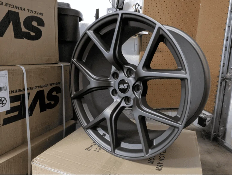

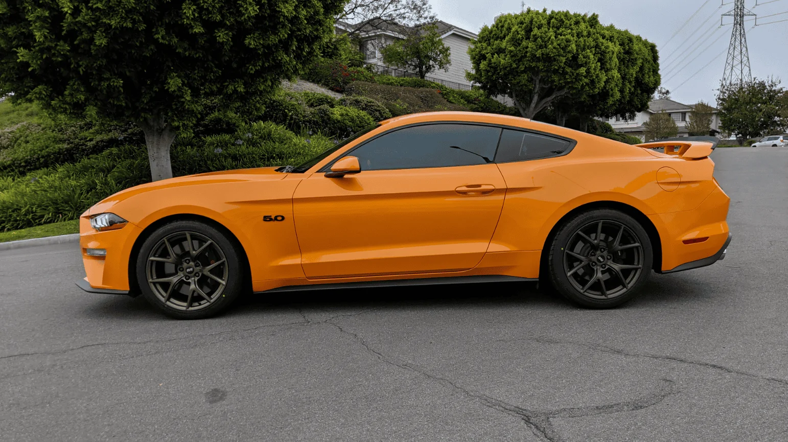

TRACK WHEEL/TIRE SET
I had been looking into a set of wheels and tires for some time now. I wasn't completely sure if I wanted double-duty tires that I could daily and would hold up on the track or simply get another set purely for track days. Either way, I wanted a square setup. I knew square was better for track handling and it's better for the street as you can rotate them.
I spent A LOT of time calculating offsets and making sure I had enough clearance for the strut. Also finding a rotatable setup was proving to be difficult. The front and rear offsets are SO different. I tried to get everything perfect as to not change the overall tire diameter too much, wheel fitment front and rear without rubbing, scrub radius, ect. It seemed likely that the easiest path would be to get a less aggressive offset and put spacers up front.
I came across Apex EC-7 wheels. I was looking at their 19x10 +40mm wheels. Flow formed, so they're strong and perfect fitment in the rear and with a 5mm spacer up front, they would have enough strut clearance. That was my plan; more expensive than I would like, but my plan.
Down the road, I was talking with a fellow M6G member who road races and I noticed he uses SVE wheels from LMR. He said they are well constructed and he has had zero issues with them. He drives his car hard, so I trusted his word.
Come Memorial Day, I saw LMR was having a sale on their SVE wheels. ALMOST 40% OFF!!!! I had to jump on it. So I purchased a set of SVE SP2 19x10 ET35 wheels in bronze. I think normal price is $1200-$1300. I got the set for $810.
The offset was perfect for strut clearance without a spacer, not too much change in scrub radius, was a bit aggressive for the rear offset, but would fit. And I could rotate them!
I decided on going for the track-only path for these wheels. It would be cheaper in the long run and I could eventually get much stickier tires that wouldn't be well suited for street use. I chose to go with Bridgestone Potenza S007A in 285/35/19 size.These are Bridgestone's replacements for their RE11 autocross tires. I have read very good reviews for these so I'm hoping for good results. They are a 240tw tire so better than OEM but nothing crazy. I thought I should progress through tire grip rather than jumping into a 200 or 100tw tire.

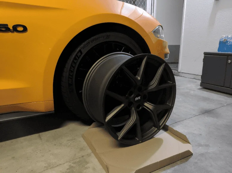

PICTURE UPDATE
I got all four tires for $900, installed and balanced. I wanted to see how they fit and looked so I drove around on them for a couple days before shelving them for the next track day.
No rubbing from what I can see. They poke out just a tad in the front and a bit more in the rear. I'm hoping that isn't an issue at the track.
LMR's website says these wheels are 24.1 lbs while factory PP wheels are around 33 I believe. I could definitely feel the weight difference when putting these on.

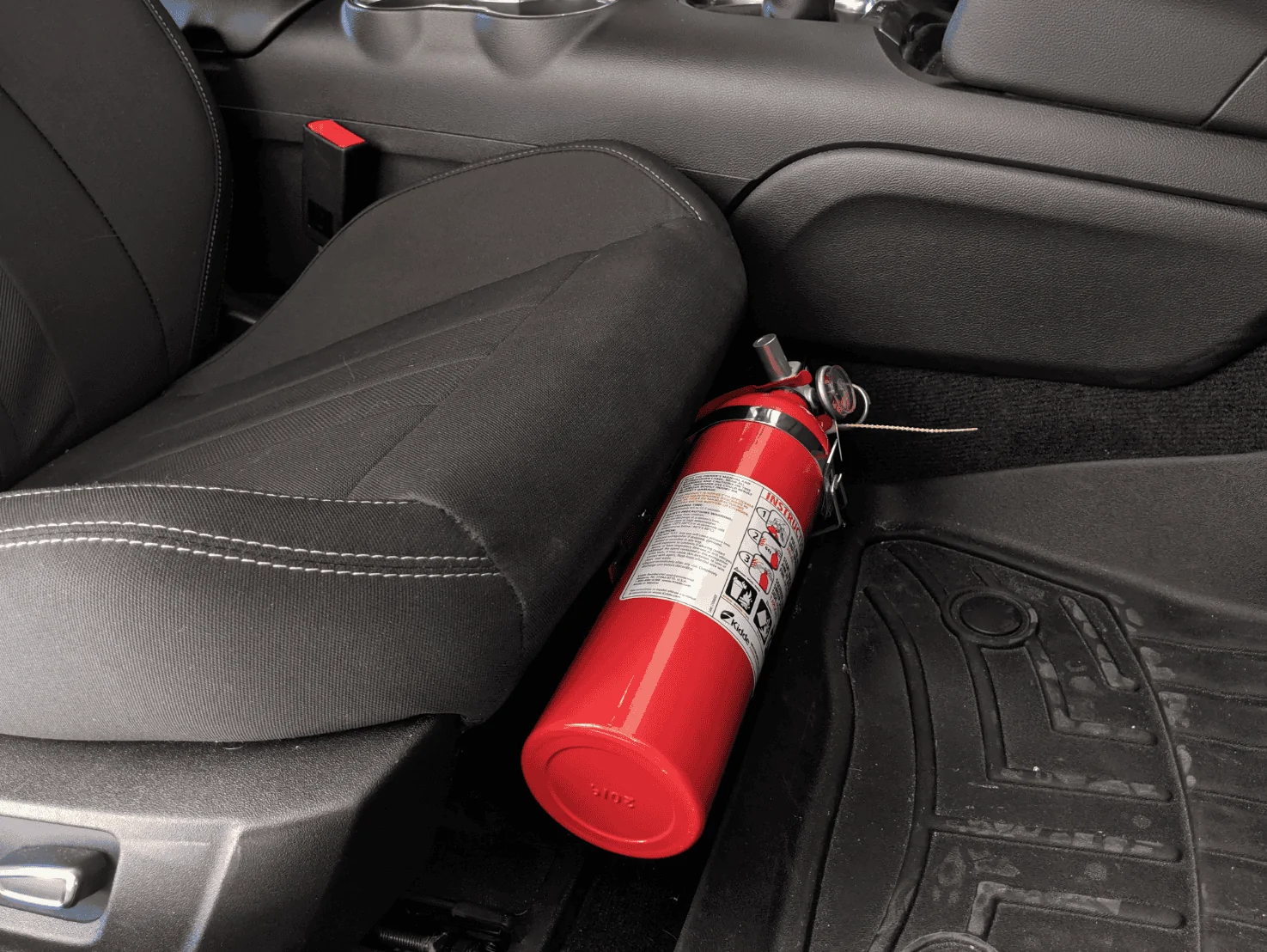

SEAT MOUNTED FIRE EXTINGUISHER
Safety first! This was a very easy and straight forward install. I purchased a Brey Krause seat mount (R-2160) and a fire extinguisher and bracket from Grainger.
The install instructions that came with the Brey Krause mount were very easy to follow and quite detailed; simple screws and bolts and everything goes in place. The seat mount has pre-drilled holes that line up perfectly with the Brey Krause quick release. Because I used the fire extinguisher bracket rather than their quick release, I had to drill some new holes.
Note: the mount is made of some tough steel. I thought maybe I could get lucky and an electric drill could get through it. Nope. So I took it to work and used a drill press instead.
I may switch the bracket out for the BK quick release (R-9520). The bracket that comes with the fire extinguisher does not seem all that secure.
UPDATE: 1-6-2020
Other than the clamp the bracket comes with, I was using a hose clamp to hold the bottle in place. This was meant to be temporary as you cannot quickly and easily remove a hose clamp during the event of a fire. Though the BK quick release is gorgeous and I'm sure works perfectly as designed, I did not want to spend $250 on this. Instead, I got a nice velcro strap to secure the bottle for $7. Works just as well, it's easily and quickly removable, and it doesn't cost $250. Win win

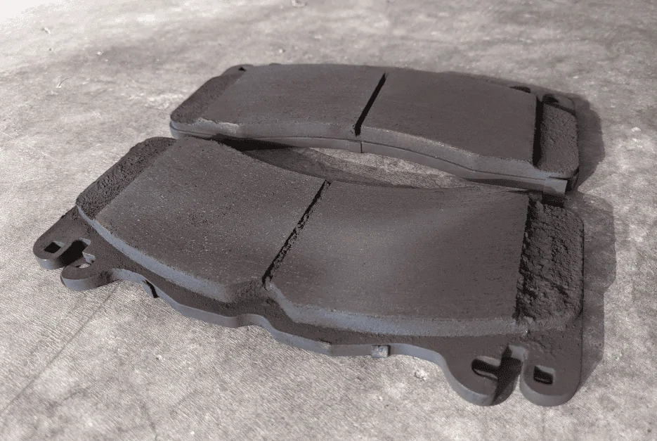

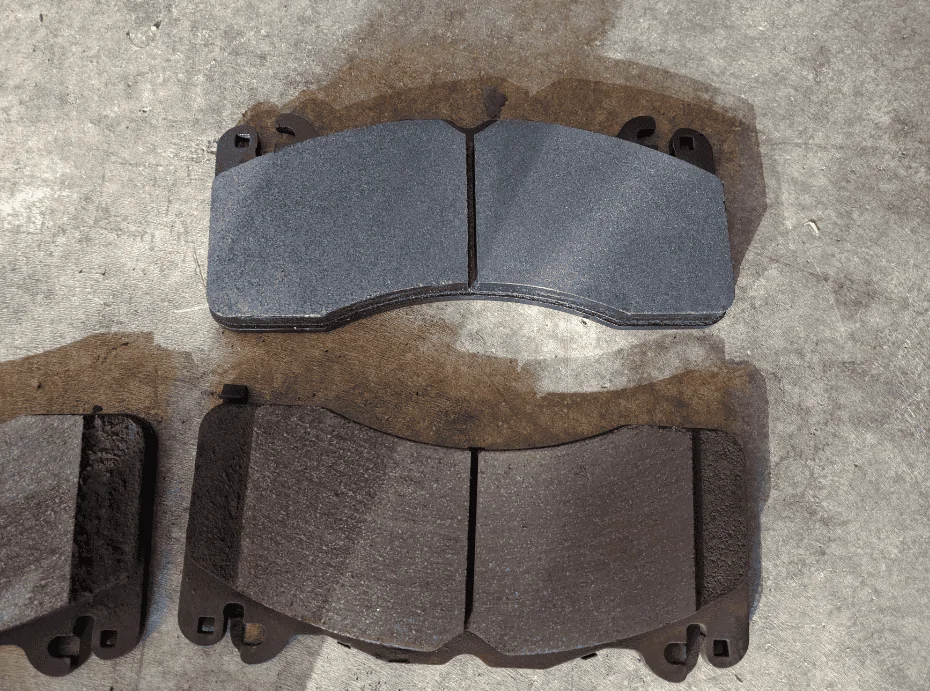

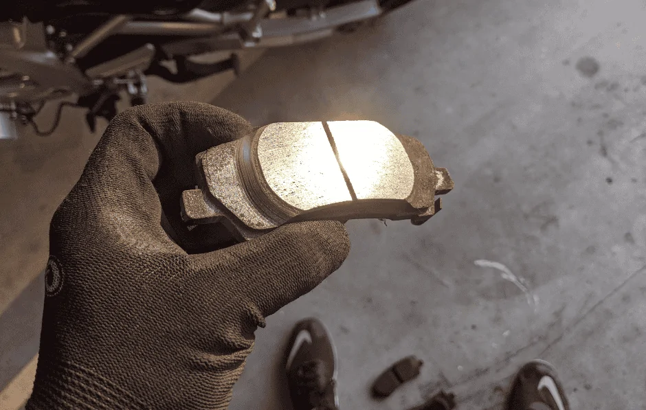

FIRST PAD CHANGE
Changed the brake pads out for the first time on this car. (For reference, these pads have 13,000 miles total and one track day.) Very straight forward but this was my first car to have fixed calipers so it took me a bit longer as I learned the process. It was interesting to see the condition of the OEM pads; as my previous post stated, I was told my pads were at least partially glazed. I had no idea what glazed pads were supposed to look like though I was told they should look shiny.
They looked beat up and definitely shiny. Though the new Hawk HP+ pads also looked shiny but maybe that's only because they're new. These OEM pads felt great for my first track day but they don't appear to hold up to the abuse. Glad I pulled the trigger on new pads.
The top pad is the Hawk HP+ and the bottom pad is OEM. I'm excited to see how these feel at Buttonwillow this weekend.
Side note: I didn't know till it was late at night that the rear caliper piston is a twist to compress type. I'll rent the kit from AutoZone today and finish the rear pad install.

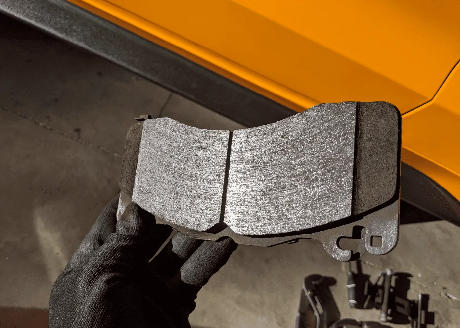

Day #2
Rear pads done. Forgot to add a picture of the rear pads last time. These DEFINITELY look glazed, almost mirror finish.
Bedding process was simple too. (Again, new experience for me. I'm sure for many readers, this is all quite obvious.) During the first two "stages" of bedding, the pads actually felt relatively soft. I figured this was normal. Then the last portion before letting them cool was at the fastest speeds. At this point the pads had significant bite. There was already way more braking potential than OEM.

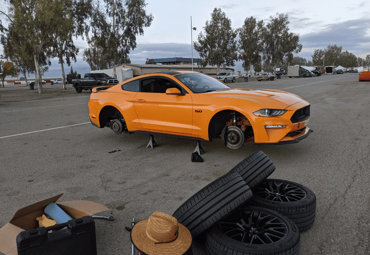

I arrived early again this day to once again, put my track wheels back on. (I had put my street tires on to drive to the hotel for the night.) When I was tightening my lug nuts, I noticed a small crack in my front passenger wheel near the hub......DAMN! Did this form from the previous day or had this been there since the day I bought them?? These are SVE SP2 wheels from LMR. I know a few other people who use SVE wheels @Flyhalf and they drive HARD so I know these should hold up to abuse. Maybe I got a defective wheel? Who knows.

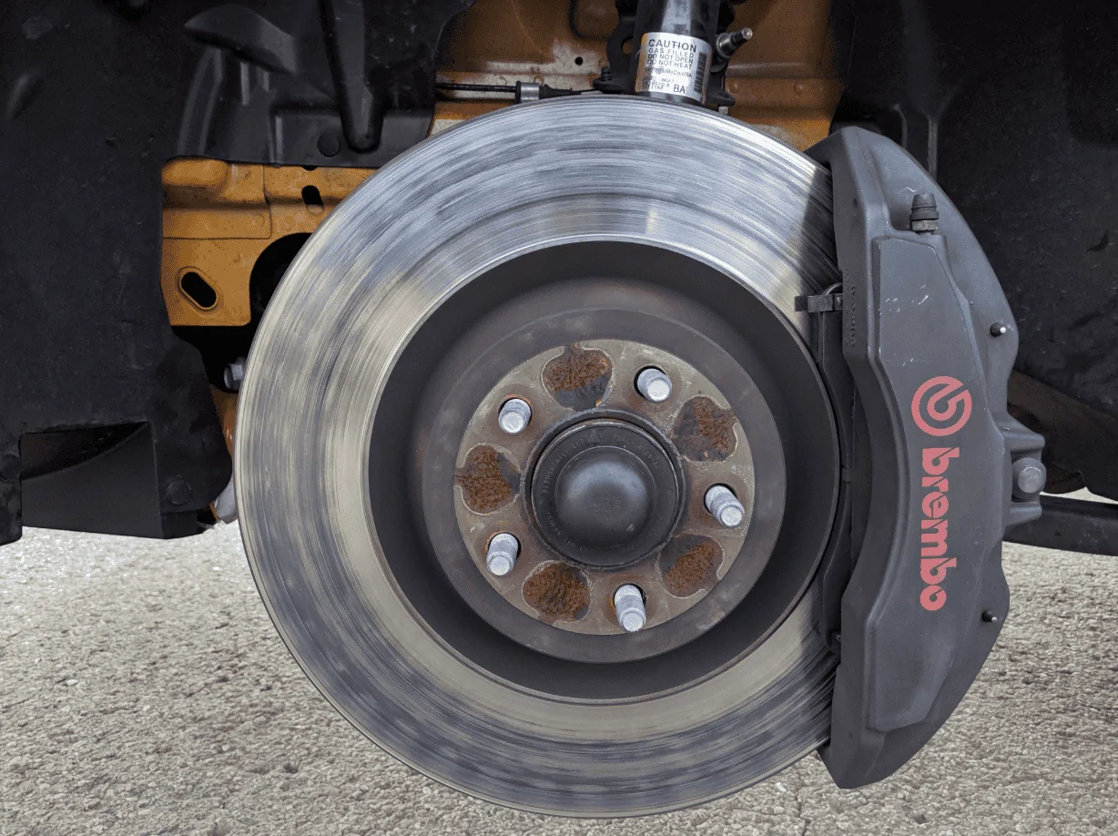

I knew I shouldn't drive on this but I wanted a second opinion from someone more experienced. So I found my instructor from the previous day and showed him the picture. He said "Do Not Drive On This" so it was back to my street tires for this second day.

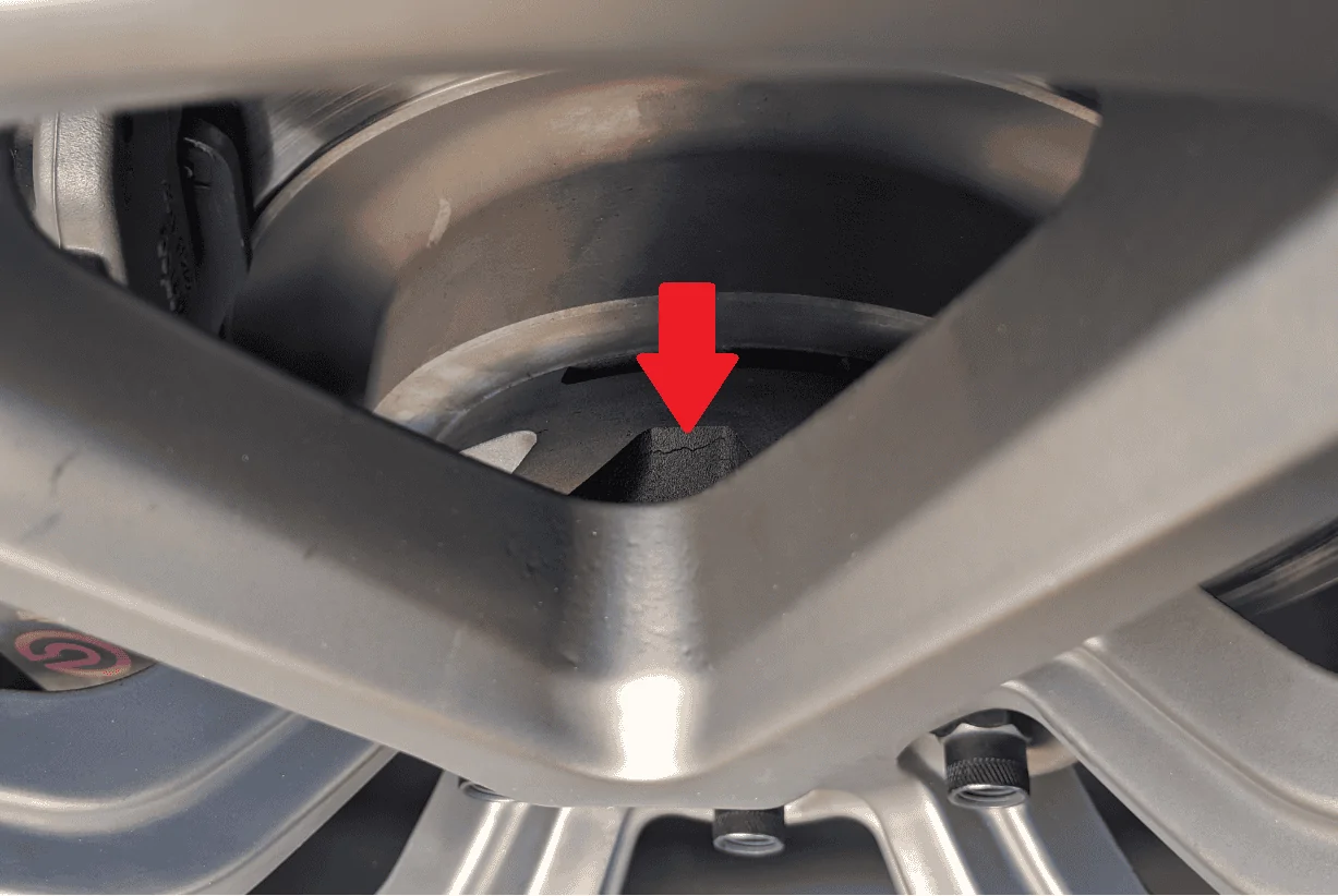

During the first day, I had noticed my brakes felt "jerky" and didn't know exactly why. I remembered at this point when changing wheels for the second time that day that when my instructor was driving my car, he mentioned the same thing. He said I have multiple pad compounds on my rotors and that is what's causing the "jerky" feel. I must have not sanded the rotor surfaces enough when switching pads. I learn something new everyday.
With the wheels off, I could get a good look at the rotors and I could see the "splotches" of differing pad compounds.
Other than this slight issue, my new brake setup felt fine. I want to say these Hawk pads had more stopping power than OEM but it's hard for me to say.
I may end up getting another set of rotors to have dedicated for my track pads so things like this don't happen.

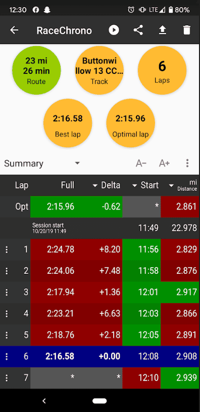

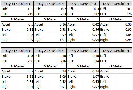

Throughout these two days, I tried to gather some simple data as each session passed. I was concerned with diff and engine oil temps but I never noticed any high temps. Granted, it was a cooler day and the sessions are only 20 minutes.
I wanted to record ECT and oil temp but since they are only displayed in a bar graph rather than a precise numerical readout, I skipped over those.
I packed up and left early before the last session; I was so tired and had a three hour drive ahead of me. Shame on me, I know. I paid for eight sessions, I should utilize all that time.
Temperatures never got too hot; ambient was around 75-80° both days. And after reading the g meter data, I see that my consistency could use some work as well as accelerate harder out of turns. Work in progress.
