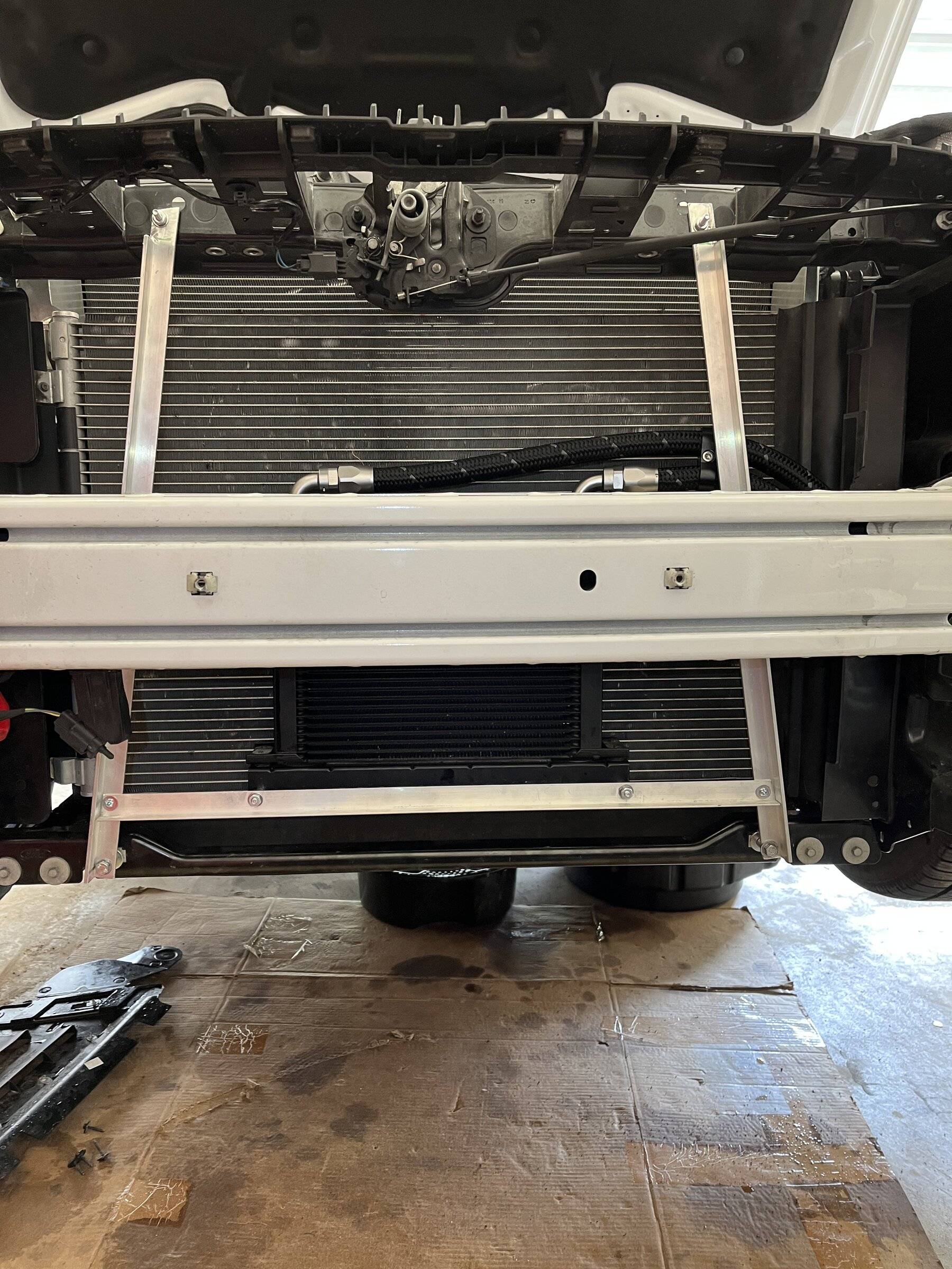

So I eventually gave up on the large oil cooler in front of the radiator and made brackets to hold 2 smaller coolers in front of each wheel. It was a lot of custom, measure plenty times type work, but the end results seem good. The air comes in through the spot light holes, and then I made a box around each cooler to force air through. I drilled holes behind cooler in the wheel liner to let air out.
Also what I learned the hard way is oil coolers must be rubber mounted to prevent them from cracking. My old center cooler setup would crack every year because I didn’t mount it with rubber isolation.

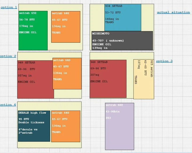

Fyi. I'm debating the future cooling setup.
Light yellow is radiator.
I dont have issue with the actual setup but my car is a time trials car
I did test multiple times for 15~20min with good success but i want to be sure to be able to substain w2w racing with traffic in case i go in that direction.
So attached a real size scheme with the options I'm evaluating.
Option4 is the less probable
But wanted to share it.
Please remember i have a 10speed bypass (who fixed together with the cooler all the overheating issues. ) And also no thermostat on oil. (again for time trials reason i can buy some time and also reduce the inlet air taping the lower grill to increase DF even more.
