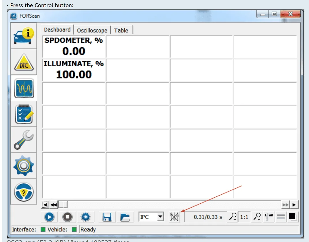

So, I had a noise problem on my car a week ago - sounded like a bearing failing in the engine cooling fan - so I pulled up Forscan and tried to control the fan from the laptop. Couldn't figure out how, and I know it can do it because I've been running the diff pump every fluid change for five years now. But, I hadn't run it recently and for the life of me, I couldn't get access to the controllable PIDs.
Well, Google found the answer on the Forscan forum. Here's a screenshot:
The red arrow points to a button that opens a new window with the PID controls in it. Boom. Done.
And, why had I missed it? Well, first, the button is in an obscure location away from the rest of the control buttons. Second, my new laptop has a 4k 14" screen. The icons and buttons in Forscan are extremely small on that screen - almost unseeable. In any case, once I realized what I wasn't doing, I did it and it worked. And the engine cooling fan sounds fine, by the way.
