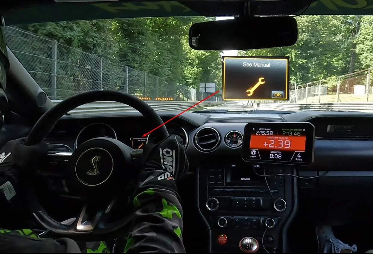

I was at the racetrack in Monza last week and had some thermal problems.
Oil and differential temperature have become very high.
On all the trackdays I've been to so far, I've never had big temperature problems.
It may well be that Monza is a bit different. The track is called "The Temple Of Speed".
You have 4x very fast sections! I have never had that on any other race track until now.
To get an idea:
-Segment 1: 155 mph --> braking to 34 mph
-Segment 2: 136 mph --> braking to 50 mph
-Segment 3: 140 mph --> braking to 64 mph
-Segment 4: 143 mph --> braking to 65 mph
Video:
The oil temperature after 4-5 laps was already at 278 °F.
Diefferential temperature up to 291 °F.
(Weather was 86-90 °F).
Is it possible that the GT350 heats up so much after a few laps with warm weather and so many high speed segments?
I also noticed that the temperature of the differential did not drop much even with 3-4 "cool down" laps, only about 50 °F.
I got the "wrench warning light" on the display after some time.
However, I don't know if it was because of the high temperatures (oil & differential) or because my clutch was slowly at the end.
After the display message, i went to the pit-lane and turn off the car. I tried to read the error code, but it didn't show any.
Later I started the car again, but the message did not come up.
(The clutch needs to be changed. It no longer "grips" properly and has been smelling in the last few laps.
Has 37'300 miles, and will be changed next).

The 278 engine oil temp seems relatively normal for track use at those ambient temperatures. It is not high enough to trigger any warning lights.
It is almost certainly your differential temps that threw the alarm. Check your differential fluid levels. Perhaps they are low or your cooling pump is not working properly.

A stupid question, has the stock GT350 differential cooling its own pump?
Unfortunately, I don't know much about this.
When the clutch is replaced, the mechanic will check the rest and definitely change the differential oil.
However, it would be helpful if I can already give the mechanic some good inputs, what he would have to check. (regarding differential)

If your mechanic has access to forscan they can try to run the pump through that utility. That is what you are supposed to do when changing the differential fluid to pump out any air from the lines.
Checking the fluid level is the first step though. Should be 9 mm below the opening of the drain hole. If the fluid is low that might explain the high temps.

"If equipped with a differential cooler, operate the differential cooler pump with a scan tool for two minutes and top off differential fluid."
You can run the pump with Forscan or another scan tool. IIRC, the PID is "R_DIFF_PUMP" and it's a controllable ECU PID. Just make sure when you're done that the level is 9mm below the bottom of the fill plug. Too full and it'll leak.
