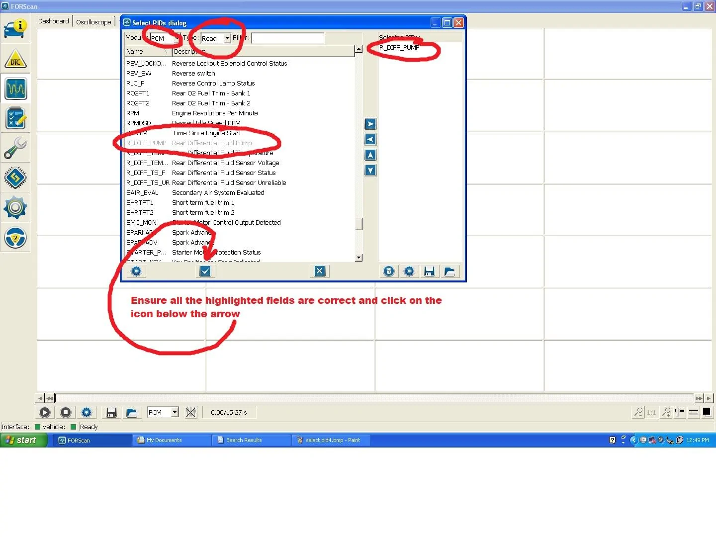

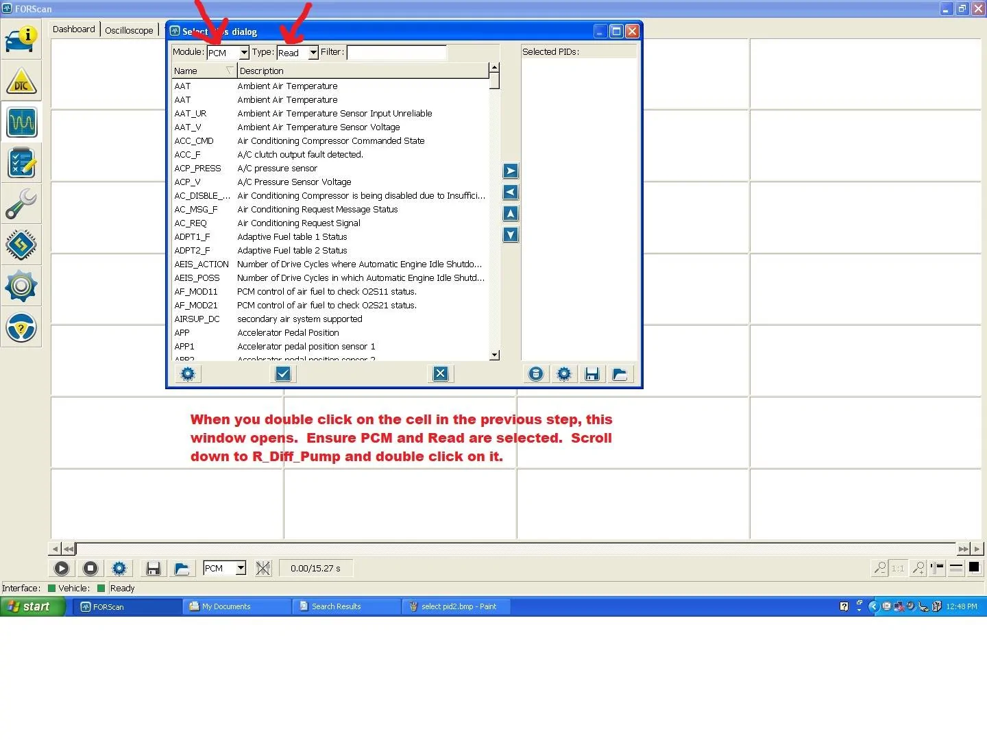

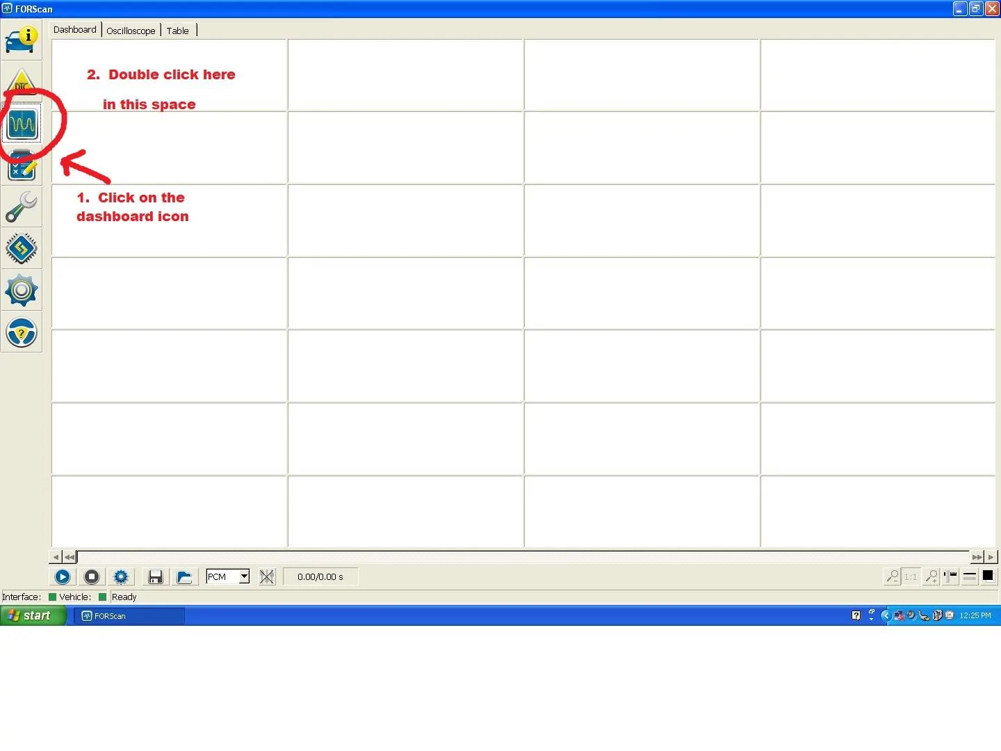

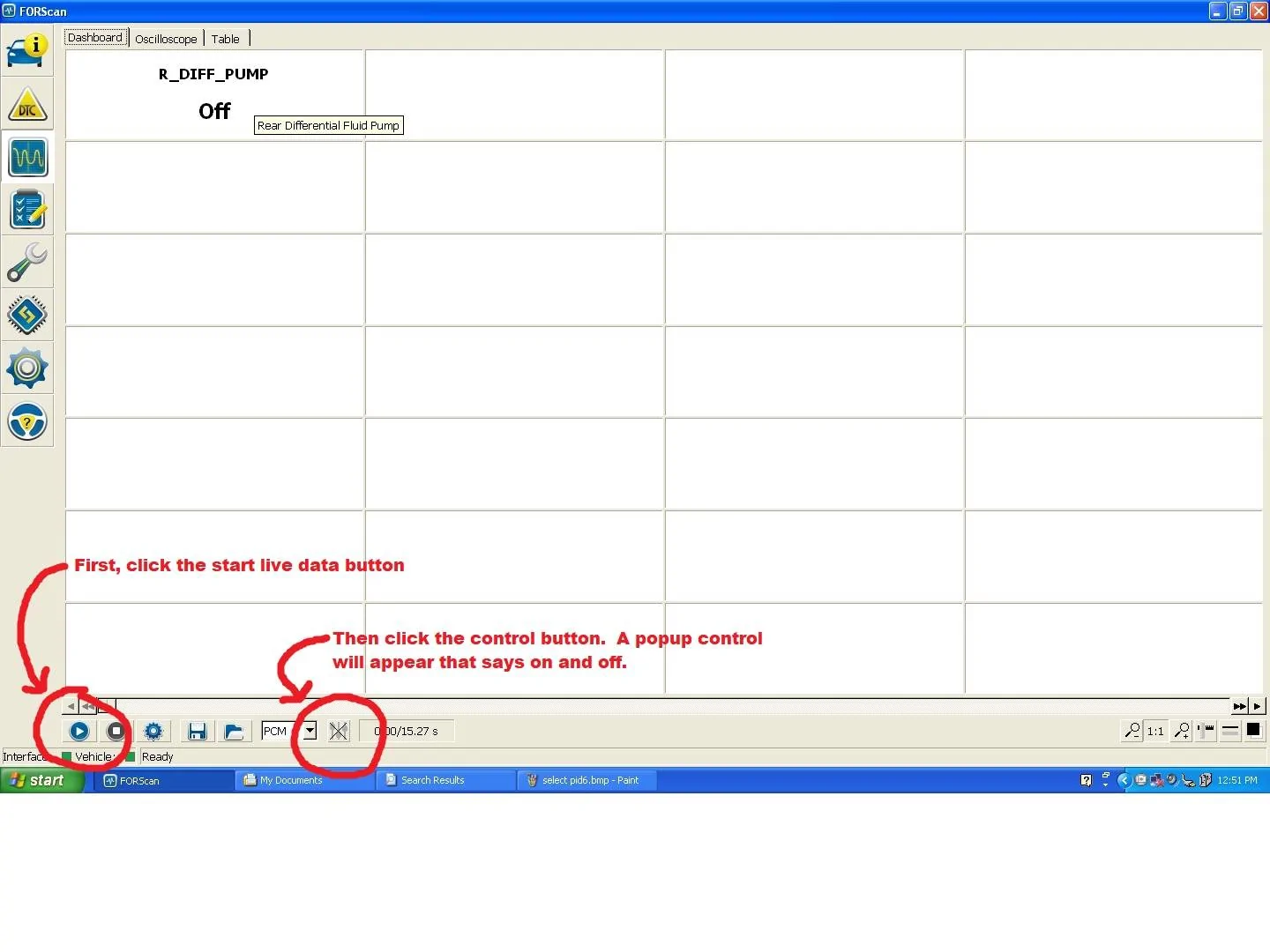

Step by step below. Do not use the pump to drain fluid and only operate pump when fluid is at temperature. When cold, the fluid is very viscous and could damage your pump. It was not designed to run cold.

Thank you very much sir!
