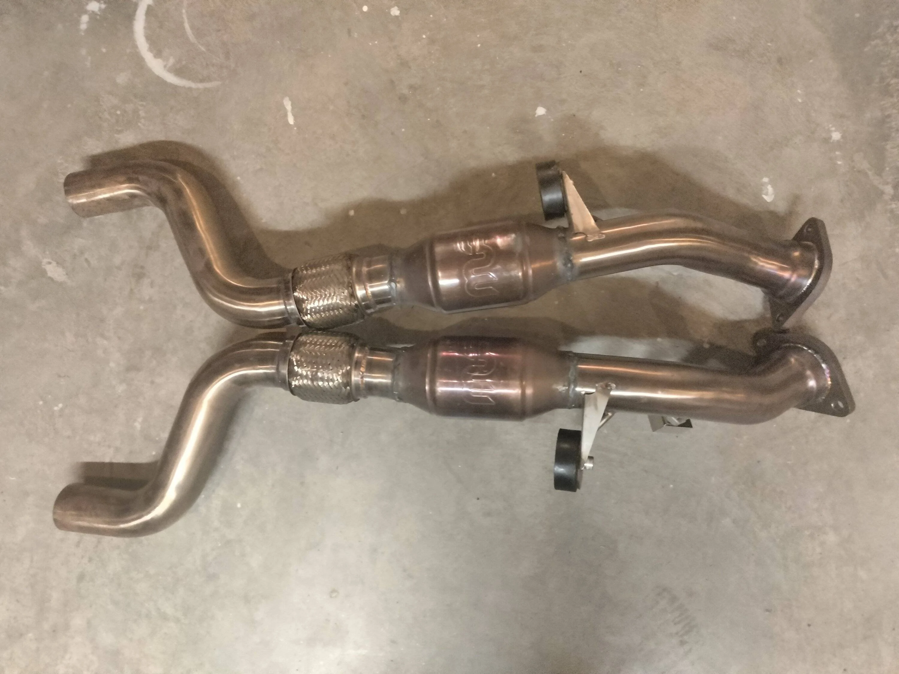

This was my attempt to construct midpipes with integrated high flow cats. These are Shifteck cat delete pipes with 02 extensions and Magnaflow #69006 200 cell HFC's. The sound is super aggressive while maintaining the 350's unique character. Sounds amazing just a bit too loud for my daily commute. Also improved throttle response especially when rev matching. Also no CEL for the few hundred miles they were on.

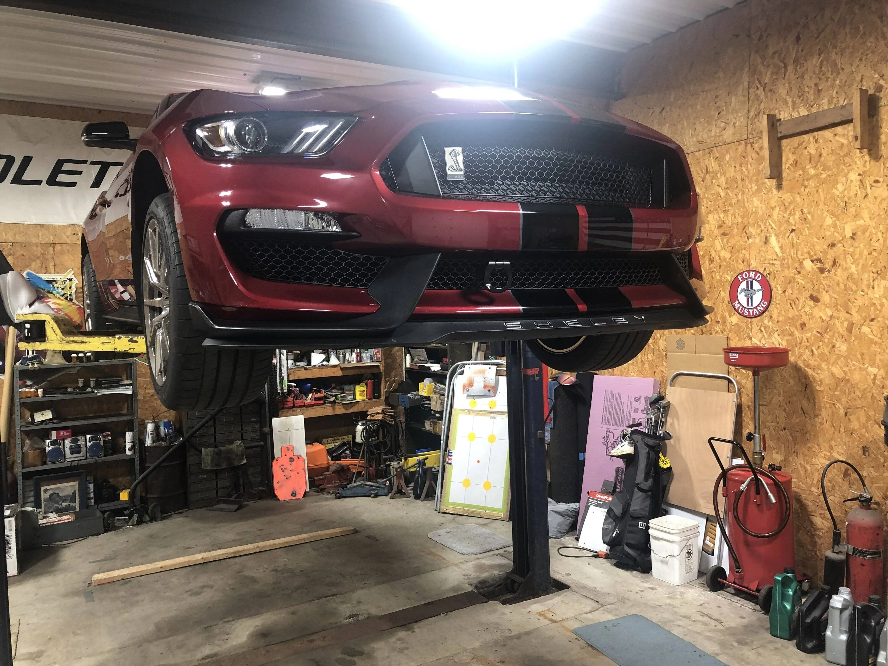

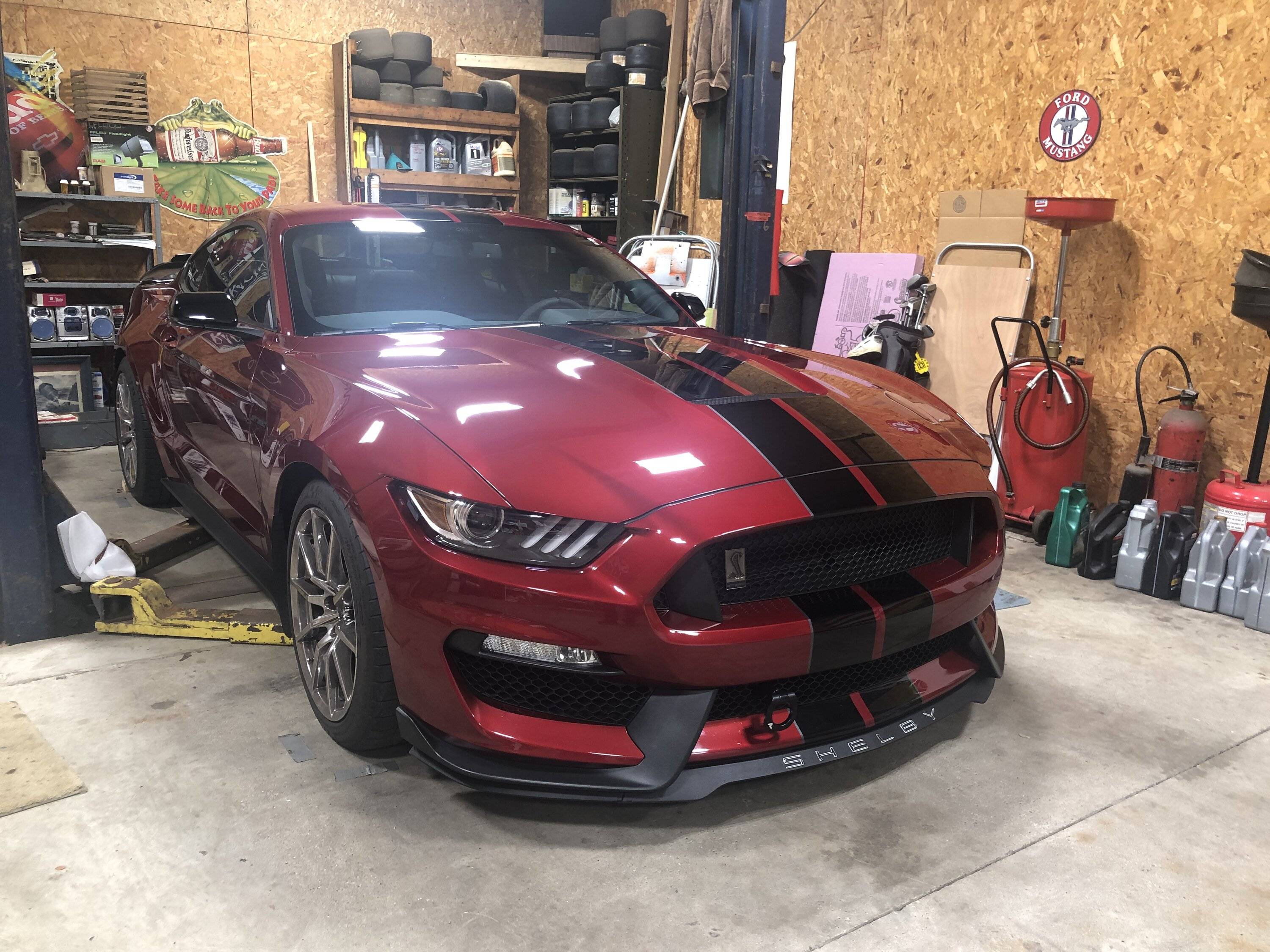

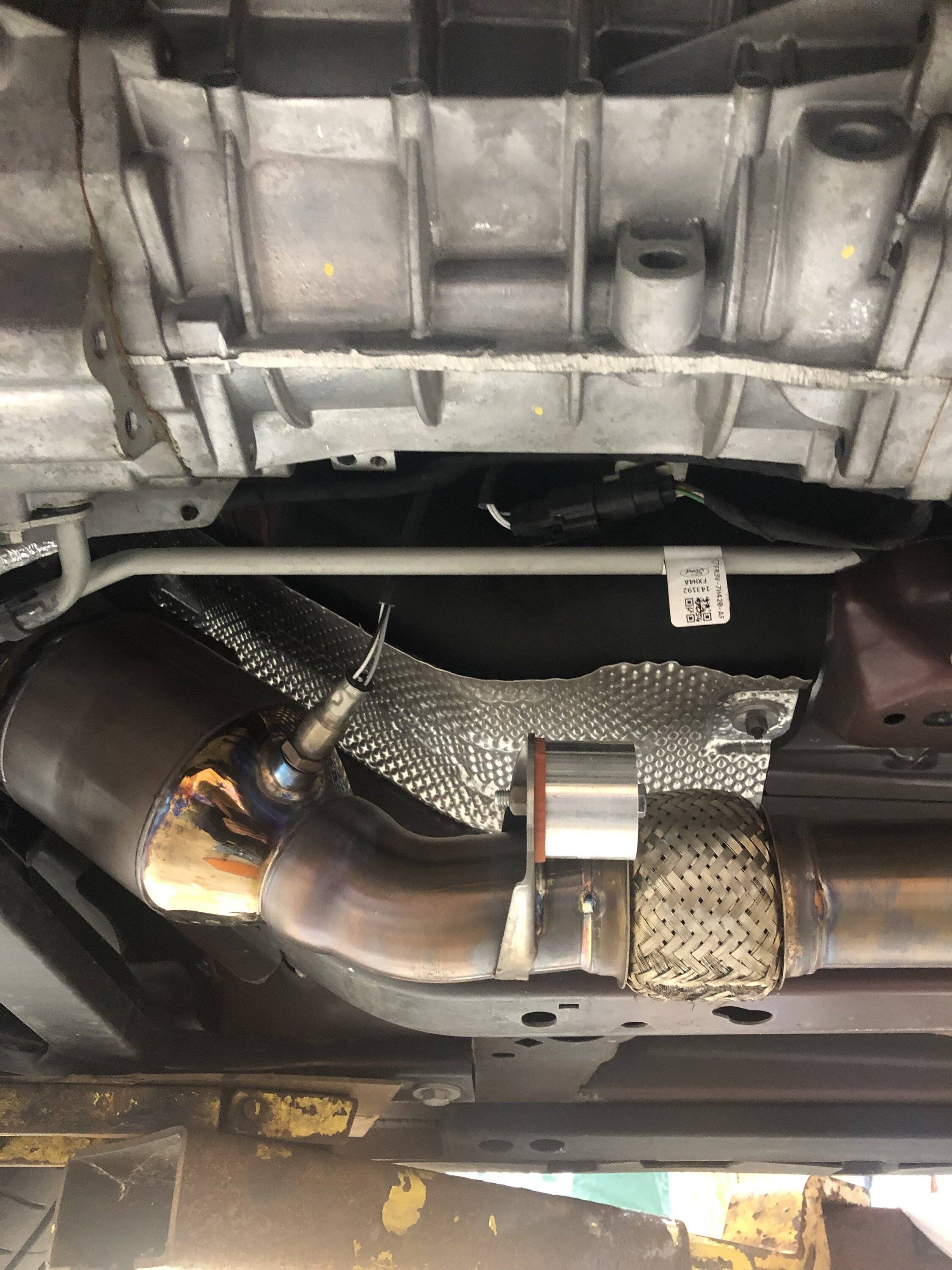

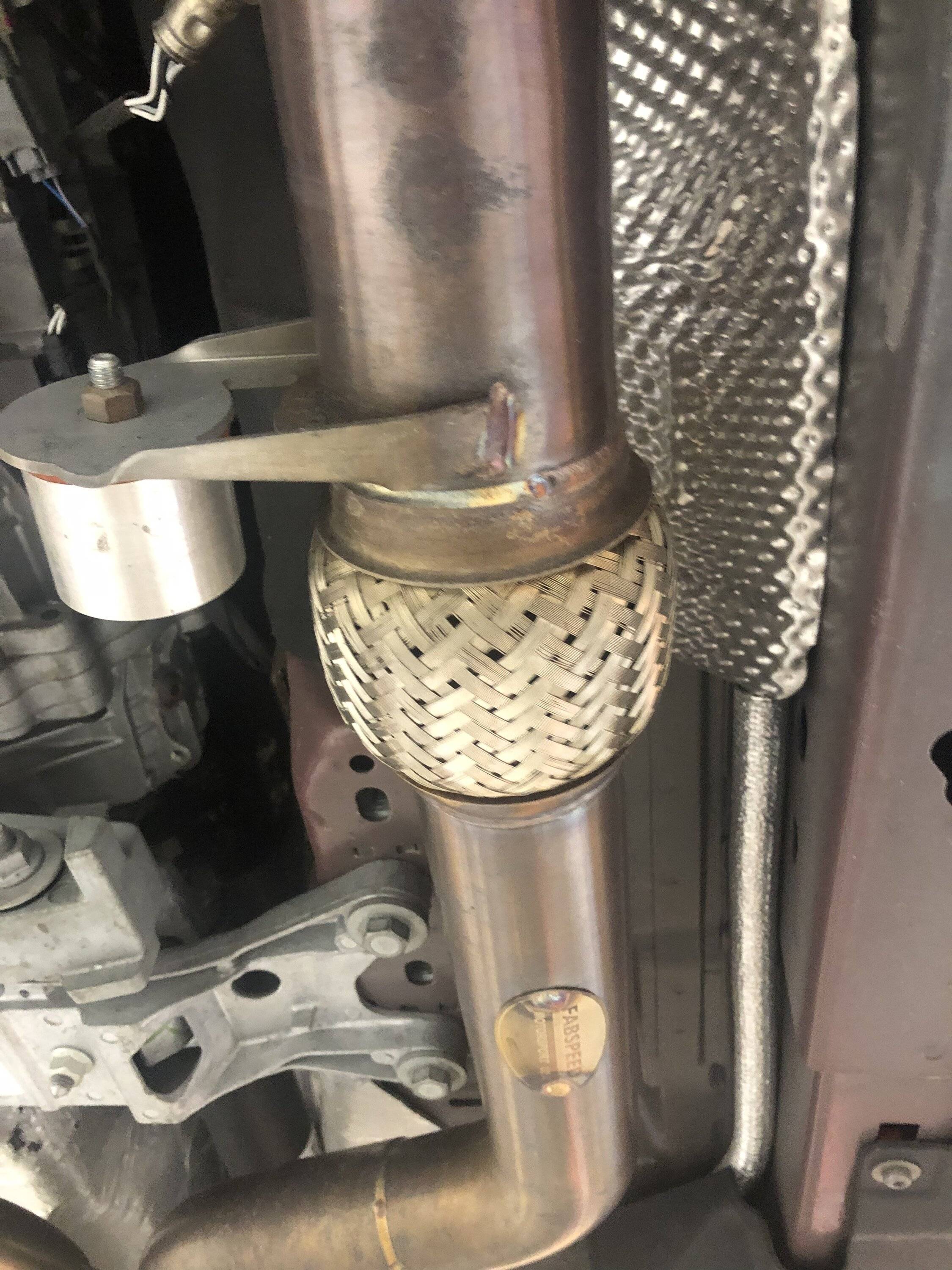

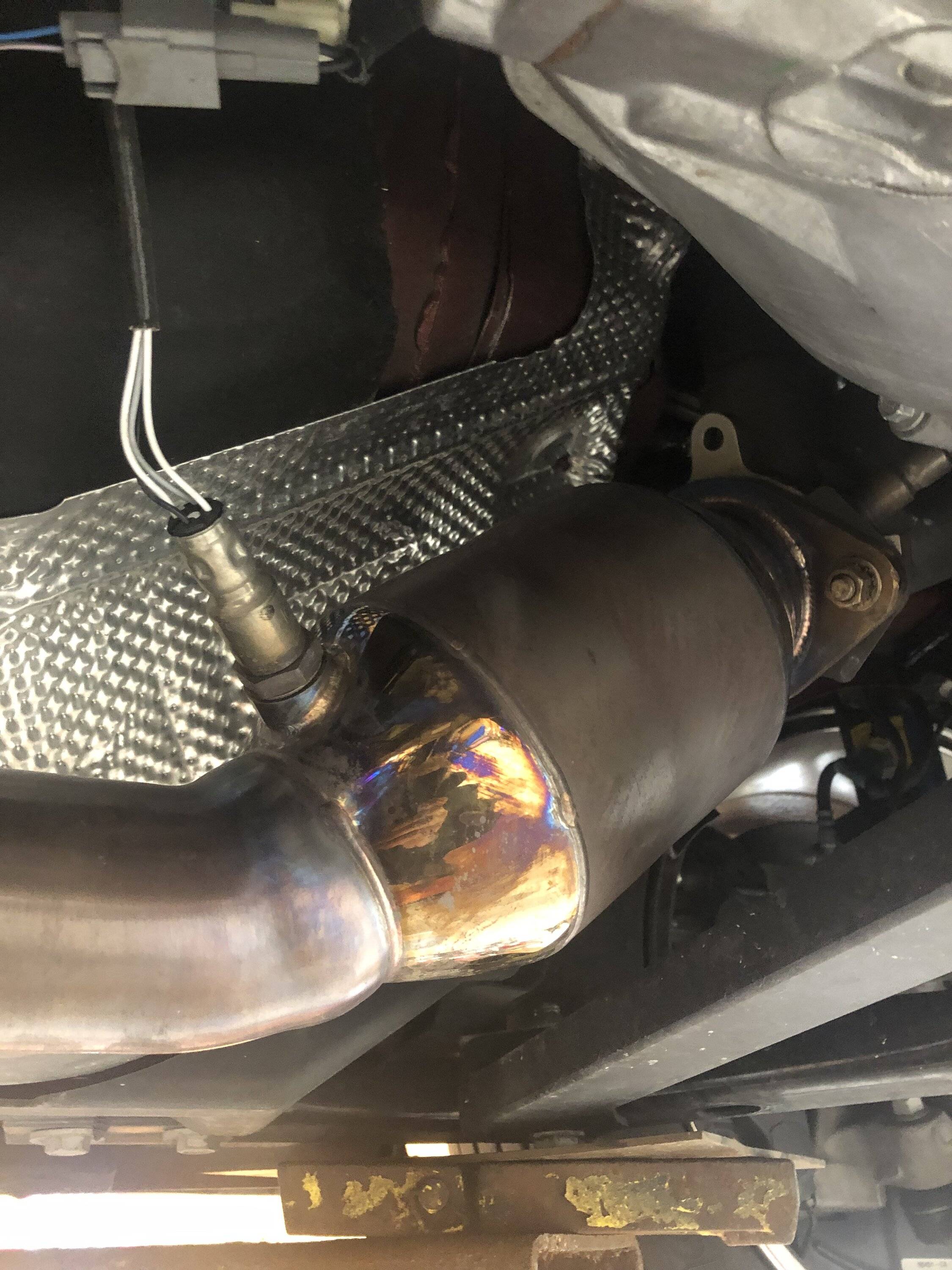

I’m getting my car ready for the dreaded winter storage. I put it up on the rack to clean and inspect the undercarriage.
I looked over the the FabSpeed High Flow Cats for any cracks or deficiencies and they look pretty damn good to me.
Around 6,000 miles of street driving and 2, Two day weekends at Mid-Ohio with my son and I going back to back as we were sharing the car.
He would come to the pits, we’d change drivers and go back out for another 1/2 hour session.
