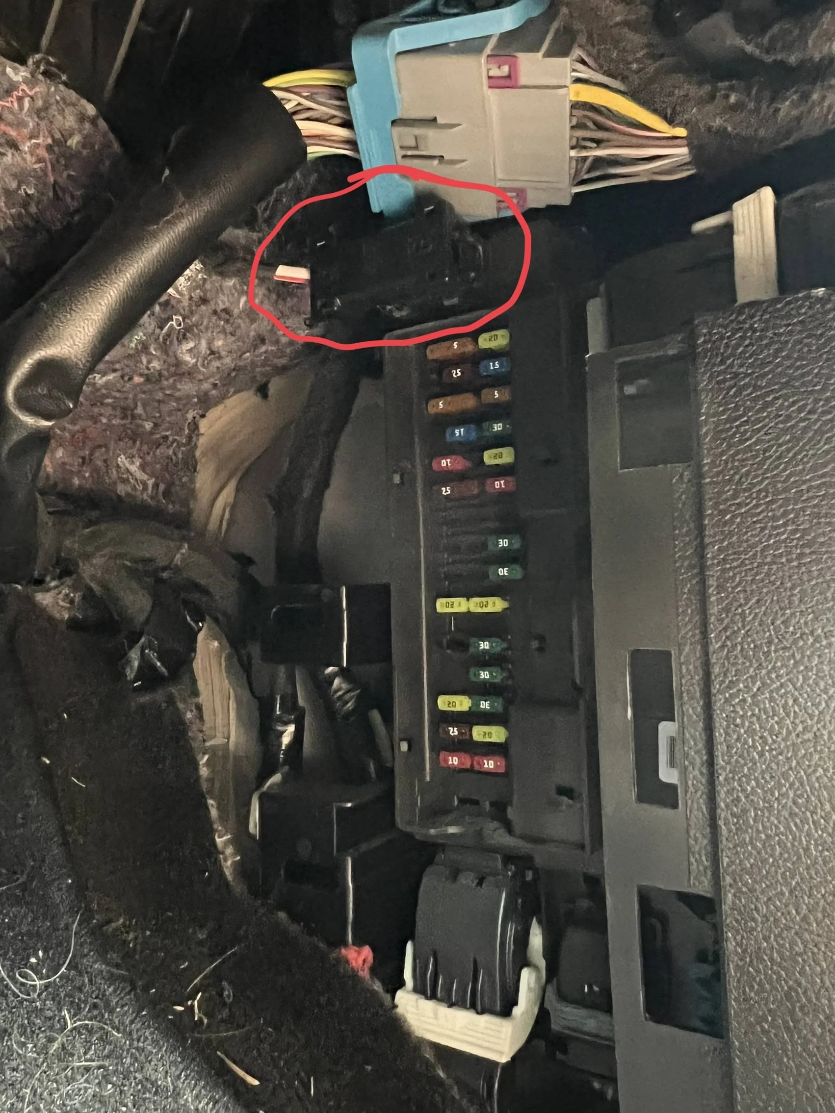

I solved it before I was able to read your post.
I knew it had to have something to do with the BCM, and the fuses were checking good. So I started to figure it had to be a broken wire or a short somewhere that had rubbed through, but as a last-ditch effort I decided to start wiggling connectors.
This connector with a large-gauge white w/red wire was unplugged. My guess is it somehow came loose over the last 6 yr/ 135k mi and I finally hit the bump that was the coup de gras.
I snapped that connector back into place and I’m back in business.
Thank you all for your help and your time to respond.
Good diagnosis and find! It will definitely benefit others in the future with similar non-start issues!
