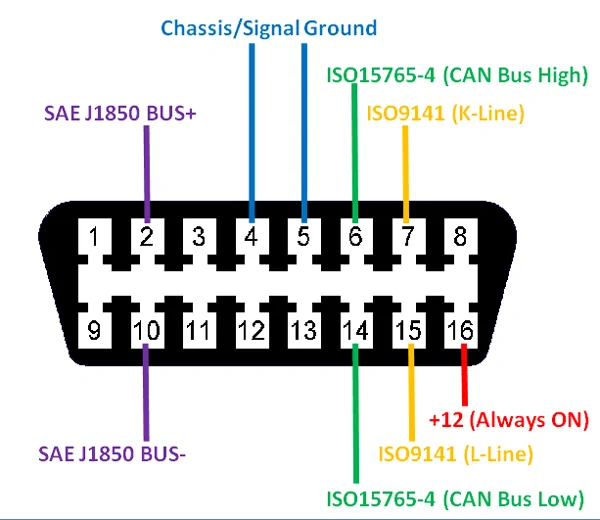

I looked up the OBDII pinouts and found this:
I put the red probe of my multimeter in port 16, and the black in port 4 and got no reading. I did this with the engine running, while the accessory was on but the car wasn't running, and while the car was off. No difference. Just to make sure I had my multimeter set right, I checked from the output of the under-hood fuse box to a ground point near the shock tower, and I got 14V while the car was running. Just nothing on OBD2.
