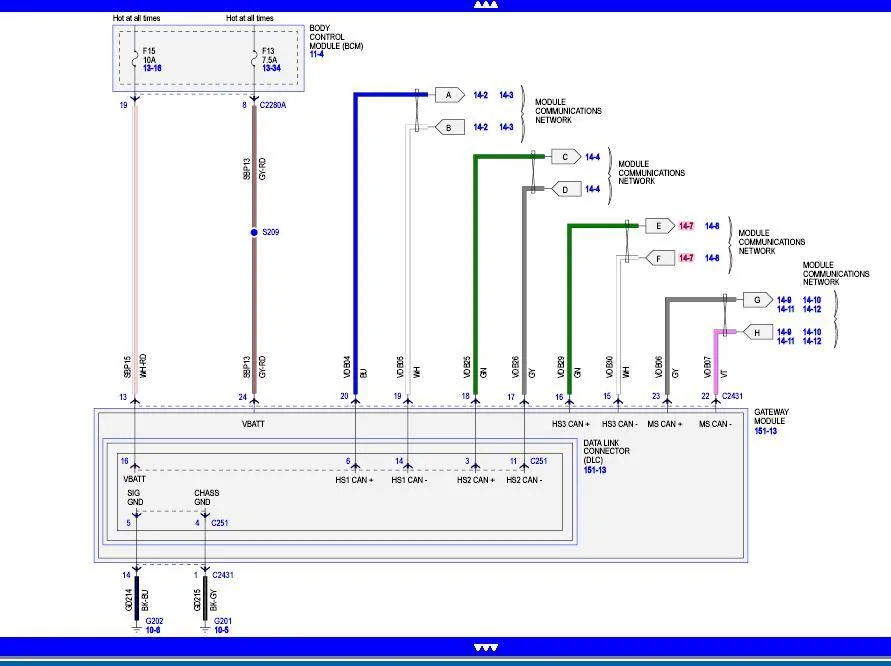

So after months of waiting the Hellion kit is done. But as we went to load the tune there is no power to the OBDII. We've have went thru every ground and every wire with no idea. Does anyone have a diagram for the OBDII portal? we couldn't find anything on the web for the 2015-2016 Mustang
