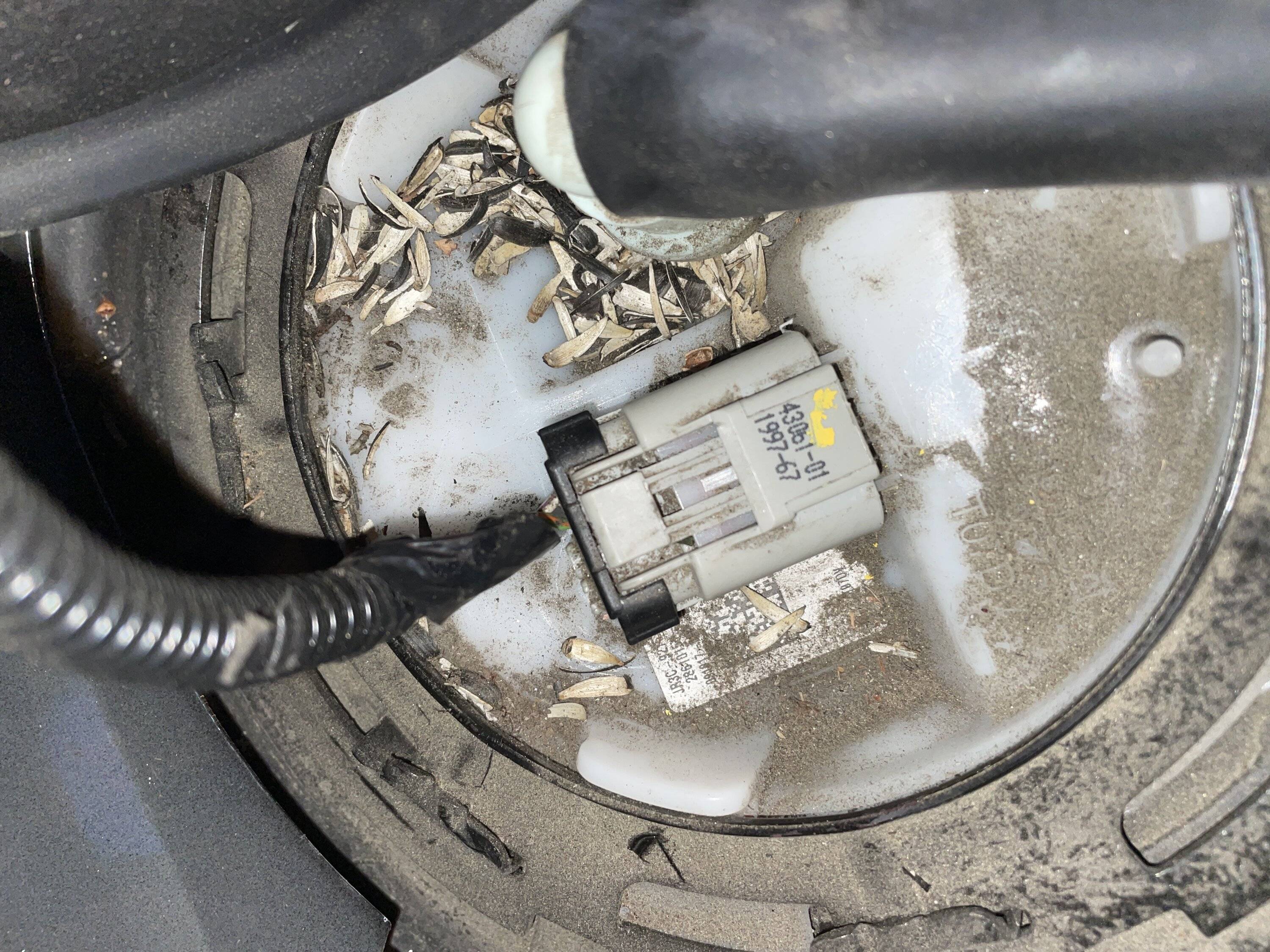

Today I started snooping around the engine compartment to see if I could find any trace of gnawed wires. No luck there - I did take the silly plastic engine cover off as well (which required taking the strut tower brace too, brilliant).
Pump fuse is good, swapped out the fuel pump solenoid with the wiper, and the wipers still work, so that's not the problem. Then I started taking the back seat apart to look at the gas tank connections, lo and behold on the passenger/return(?) side, I see this:
I don't think the wiring is harmed right here, as I pulled the connector off and looked around... I guess I can do a little continuity testing to look harder for connection problems.
But when I hit the power button on the car, I get kind of a dull thud out of the fuel pump side... is that what "priming" sounds like? Or should it have more of an electric motor running sound as it primes?

What if... the mice problem is spurious, and the real problem is the pump is just bad? Who knows when the mice visited. Maybe the pump just deciced to give up the ghost just now? Probably worth the $200 now before going to the dealer...

The fuel pump "thump" is normal and is the prime:

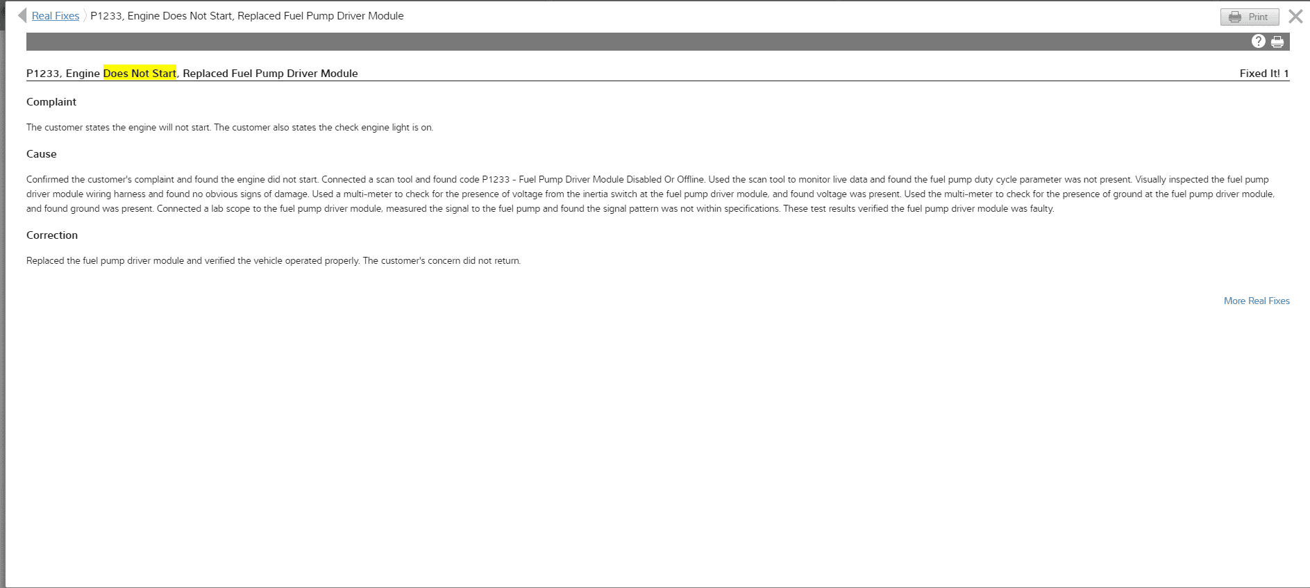

Also maybe take a look at this
That is absolutely my fear. Electronic module failure. That or wiring I can't see because I can't squeeze under the car to look. Time is running out - one week until my appointment. Innova 6100P OBDII scanner being droned in presently. Ordered the controller module (FR3A9D370AA, $25, ebay) as a hedge.
