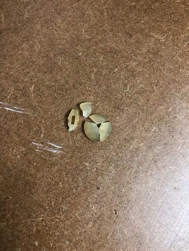

Had an issue where my 2015 EB Premium seemed to be in limp mode, but no icon on the dash. Car would only accelerate to 40-50mph and wouldn't throw any codes.

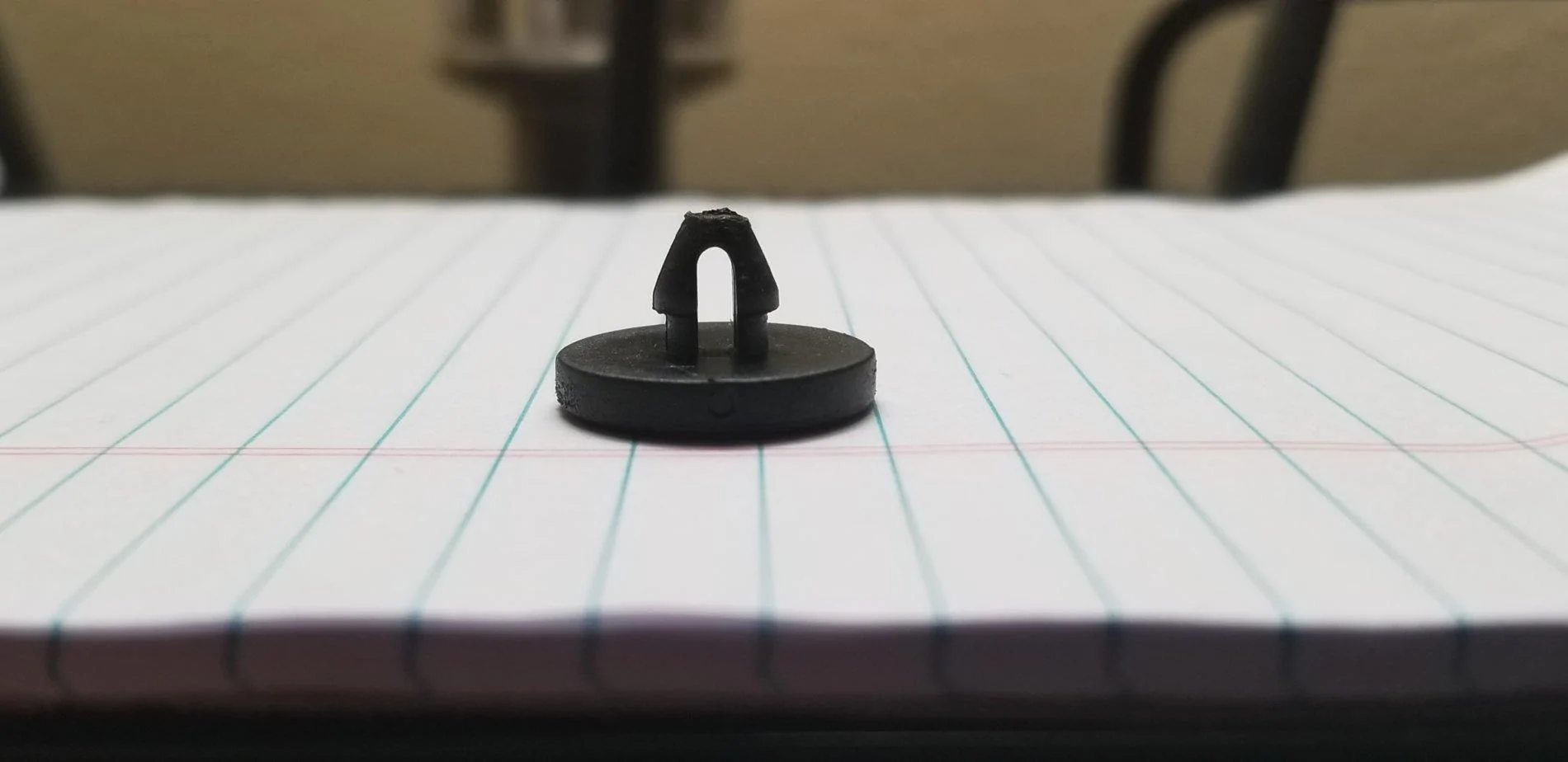

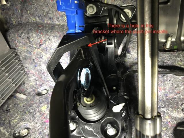

Saw some other threads in regards to the stop light switch, but there are 2 pieces to the stop light switch. There is the switch (Blue/White/Gray) with a black plunger that installs into the brake pedal housing. There is a 2nd part that is a translucent/clear plastic disc that has a push pin on one side. This installs in front of the black plunger of the brake light switch.
I was thinking this was a speed sensor or ABS issue, but when I got the car home I noticed pieces of that disc on the floor mat eliminating the other issues.
Here is a picture of the white disc:
Here is a picture where it installs:
Does anybody have the part number for that white push pin/pad, or is it part of the brake light switch assembly/kit?

So the stop light switch has a plunger on it and it installs into the plastic bracket that encases the entire brake pedal assembly.
On the brake pedal arm itself there is an L shaped bracket that a plastic circular disk that has a 1/4 shank that clips into to. This provides a contact patch for stop light switch plunger to hit.
I threaded an outdoor rated nylon tie through the hole and secured it down. Without it the stop light plunger goes through the bracket not making contact with stop light plunger.
I tried to get a pic but it’s near impossible with the tight quarters.
This is not a permanent fix but the car is drivable.

It would work and actually considered it. However, the original pad was very brittle from the FL heat. Those pads would glue on or peel and stick.
I was worried about it the adhesive failing while I was driving and being in the same boat.
What I need is a 3D printer and copy the original...
Most frustrating thing is Ford probably has 17 boxes of 1000 in a warehouse somewhere lol

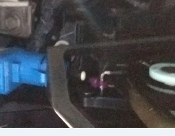

In the same situation as well here. I had to rotate the zip tie so the nub was facing the switch plunger. A thicker zip tie may work better so as not to have to do that.
i did find something similar on Amazon, but hard to tell if it is the right size.
https://www.amazon.com/CUSHION-CLUT...GC5C616NYEN&psc=1&refRID=WVKVAGP6JGC5C616NYEN

I used an outdoor rated one and the band is a bit thicker filling the hole (giggity) so the plunger doesn’t go through.

So I ordered the part from the link in my previous post and it just arrived from Thailand. It looks like it is the right size and is going to work.
The only problem I have is that my car is at the collision center getting repaired, and the broken pieces are in the glove box.
I had previously put the broken pieces back together to get a better idea of what I was looking for. So I am pretty confident this is it, but I won’t really know until I get her back, probably a few weeks out.
