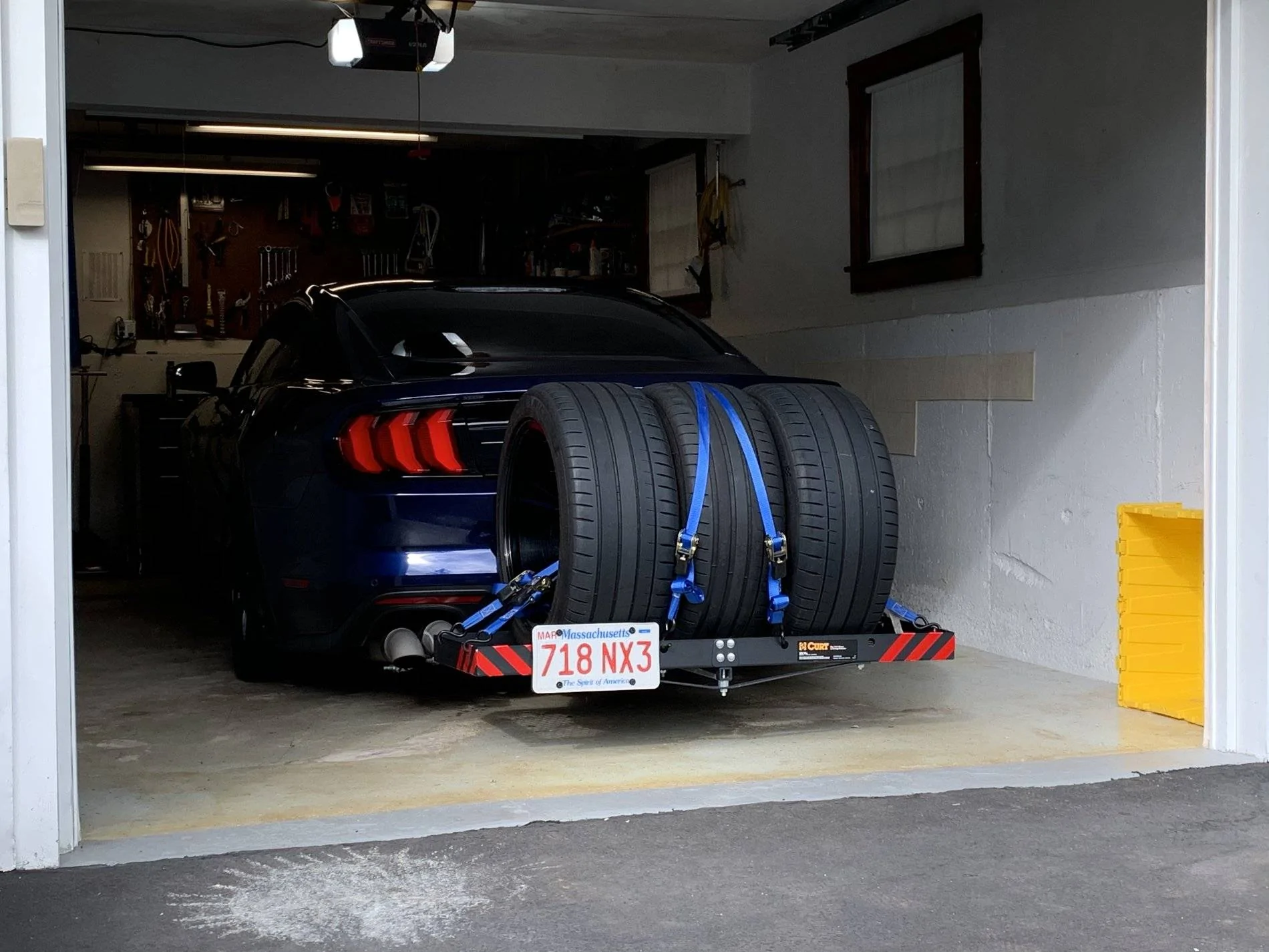

Hey Brian, how bad is the jigsaw puzzle of carrying a set of tires? Or was that just a rumor they'd fit?

BTW, all the arms are back with the SuperPro poly bushings now, so I need to rehang the suspension, align the car & pack so my crap up for Saturday morning.
They do fit. There's an easy way and less easy way, and it depends on how tall you are if it's an issue. Easiest way is 1 in the trunk, two in the back seat, one on the passenger seat. Less easy way is 3 in the back seat. Can be done, but you'll have to move the seat up a good bit (not good for long trips if 6'0 or taller).

They fit easily - I've been hauling 11 inch wheels with 305/30s around the entire country this year. With tools, cooler, jack & jackstands, tire sprayer and who knows what else (scooter for example - super useful in large sites). One in the trunk in the space for spare wheel, rear backseat down and all three in the back. Cooler in the front seat so I have access to cold drinks ;-)
With narrower tires (275/285s in FS sizes), two fit in the trunk...
*Jurassic Park clever girl*
I didn't think one would even come close to fitting in the spare well. Do you take the trunk liner out?
