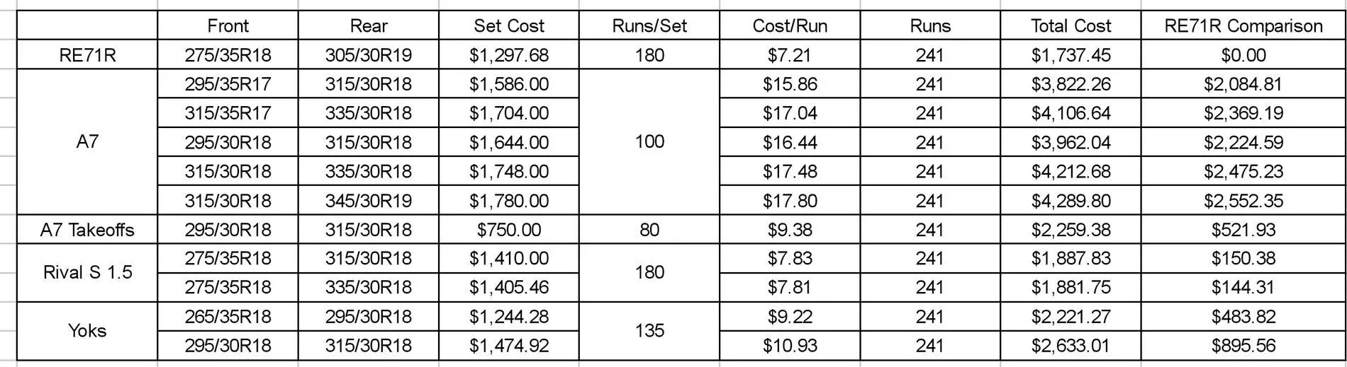

Friend of mine, and recent pro solo winner made this table for A street Vette.
too bad it’s missing the goodyear S3. My buddy with a grand sport C7 shows they wear like iron and are likely less than $5/run.

Interesting that in Corvette sizes BFGs are more expensive...
They're likely my next choice. Only thing I am not sure about is cool weather and wet performance. Seems like the Bridgestone will still be ahead for that. Yoks aren't an option for me at the moment.

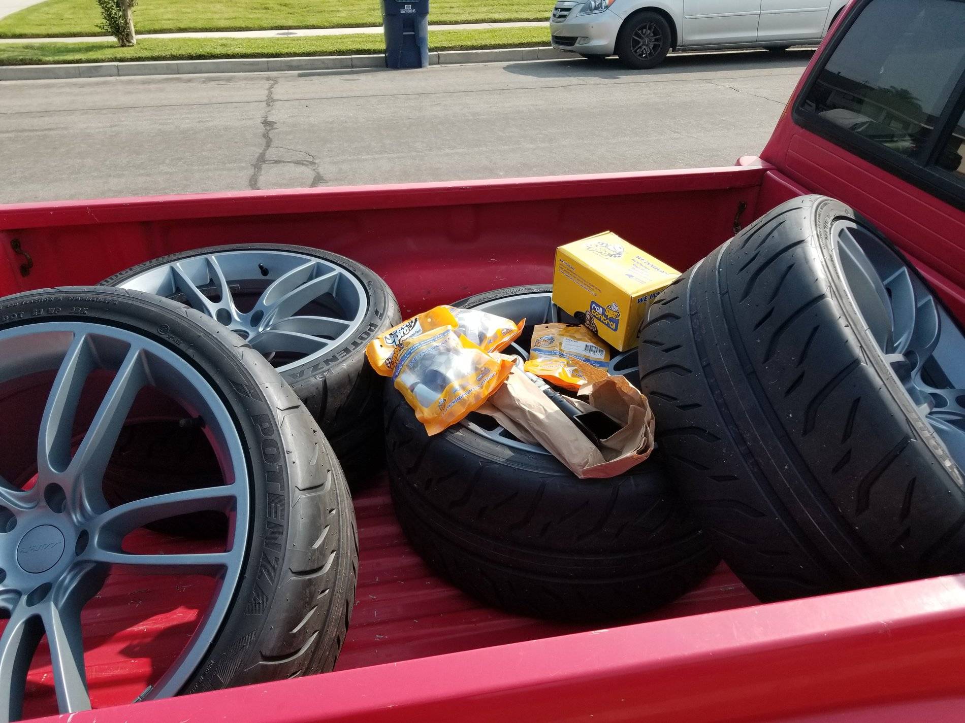

At the very least, I don't have to sit around wondering what will be pissing me off this weekend.
Truck bed full of happy right there...
