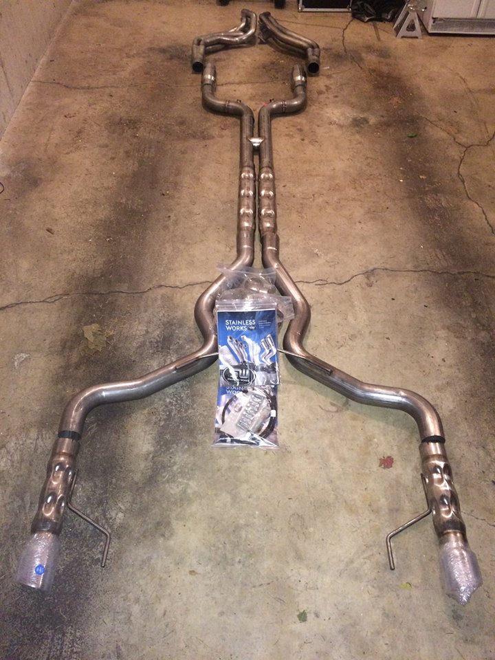

Headers - Stainless Works
- Beat ARH to the punch late last year; what a PITA to install, but fit was perfect and no issues since.
- edit: PITA knocking due to A/C bolt. reversed, no longer an issue. but seriously, gave up a lot of power last season for a gdamn bolt. guess that's what you come to expect when you adopt early. frustrating :(
Exhaust - Custom w/ High Flow Cats
- Tried SW and Corsa, way too much drone and volume. Put my stock exhaust back on; cut out the resonator and put an H-Pipe in it's place. Will probably flange after the pipe and get some lightweight bullet mufflers with turndowns for competition - the piping and mufflers after H-Pipe is 58lbs (!)
- edit: v-bands everywhere. straight pipes, mufflers, whatever it takes to make sound at sites, i've got it now
