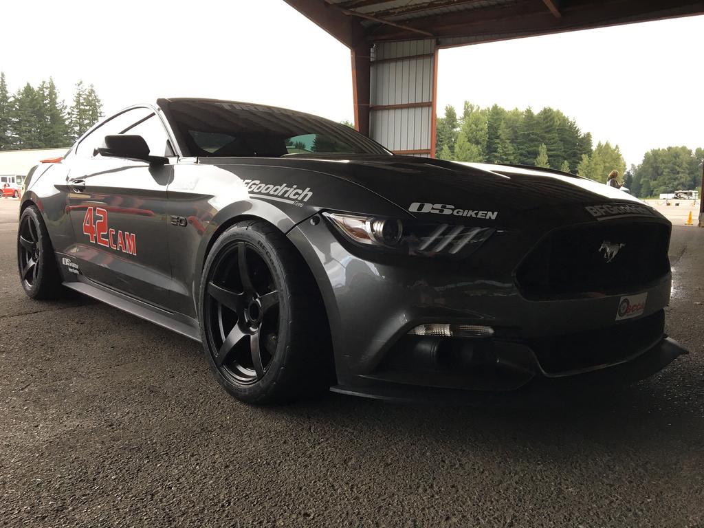

only action shot i could find - i've got some pics on my phone showing my car with the 335/12 setup at rest, will get those up soon.
edit: found another one

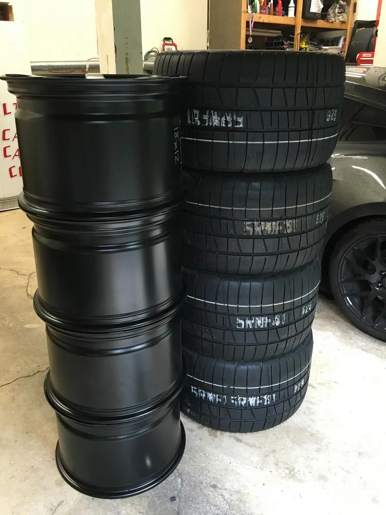

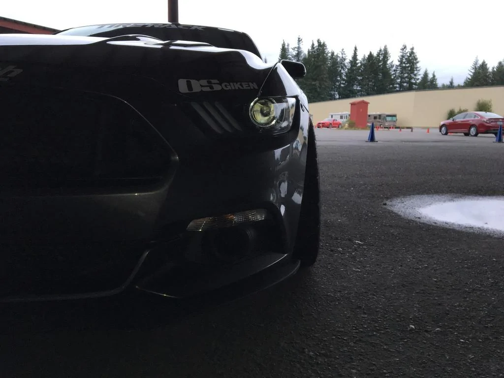

profile shots of the (slight) wheel/tire poke up front - "slight" being a relative term of course, and my definition is probably not the same as most! :)
edit2: another pic showing how much wider the 335s are unmounted compared to the 18x12s - lending credence to the idea of going to 18x13 next season:

What mods do you have on the front that prevents rubbing those giant tires on the fender when you go round corners?
properly offset wheels and about 1" of fender spacing/pulling. although i just picked up some offset struts, so i'll be getting ~10mm/corner inboard back.
