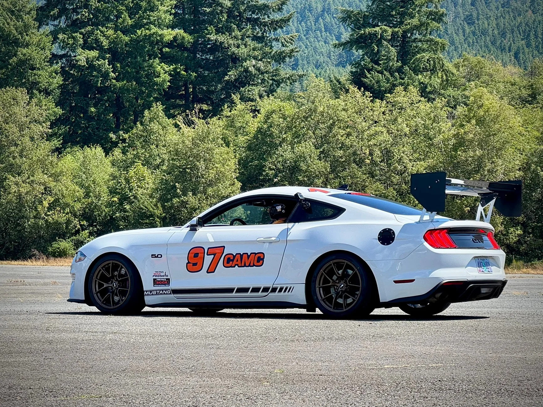

Packwood tour was a struggles and victories. Brought in Ryan Otis formerly of our region but transplanted to Texas and had him help with setup since my butt is tuned to a different drivetrain.
If you dont know Ryan, he's the guy that you love/hate to have as a local competitor. Constantly Top Pax. Typically seen now in a ZLE with just shocks, front springs, and wheels/tires. Hes better than good.
The struggles:
Since the SC was added, we have had horrible delay with throttle response in both direction. Wengerd pretty much couldn't help. Basically, there's a ~2/10th delay when you roll into throttle before power builds and a 2/10s delay in power reduction after a lift. And then when it does lift, its a soft lift.
So you try to get a little throttle in slalom? Feels like turbo lag. Lift off throttle? Car pushes an extra 2/10s. At 40mph that's 5ft.
The worst part is the lack of weight transfer. You basically cant lift rotate. Which SUUUUCCCKKS. It takes at least a second to get full engine braking at which point its too soft and too late.
Also, the throttle was basically 10%-40% was 10-90% of the power. 50-100% is almost no change.
Why? When you give the car 30% throttle, it shoots to 80-90% throttle body position to achieve its torque target. Above 50% throttle, its asking for torque that's unavailable (thanks drag racing tuners...)
The victories:
Not the times... those were off the mark.
I researched and compared Procharger and Whipple base tunes via PCMTec and found the Whipple "driver requested torque" map (auF62990) asks for less torque for a given throttle in the mid range. So I copied over a few maps from that tune and logged each run.
The result was so dramatic that on sunday the handling and driveability were massively improved. Lift rotation was not only a go, but a guarantee. EEK! All the time we spent trying to get rotation without weight transfer meant now we get all of it with weight transfer.
TLDR: Saturday we scrubbed new RE71rz, and tried to drive around the suck. Sunday tires felt way better, throttle massively improved, now back was very loose off throttle.
The conservative composite times possible would have been about 11th pax by Ryan. Cause he's a legend and can drive a bad car fast.
To-do for next weekends ProSolo:
We'll stiffen front bar one step, and move wing up one step. I'll re-check alignment and likely dial in another 32nd of rear toe-in.
Also going to do some logs to verify which maps are active to control torque and part throttle. Then work on softening the low and mid range so power is more linear and using 20-80% throttle.
Weight Update:
Down to 3660 @ 1/4 tank.
Weight to lose of what I'll actually do next: -85lbs
Weight I could lose but likely wont do cause street car: -187lbs (over the -85 above)
Possible to get car to sub 3400lbs with SC and Wing, but minus AC and Stereo and running CF doors. Weight dist with that setup would be 52/48

You're getting a balanced feel with no front splitter?
Yeah, its all about using rebound and spring for low speed rotation and the wing to stabilize the car as speeds increase. Not a net aero gain.

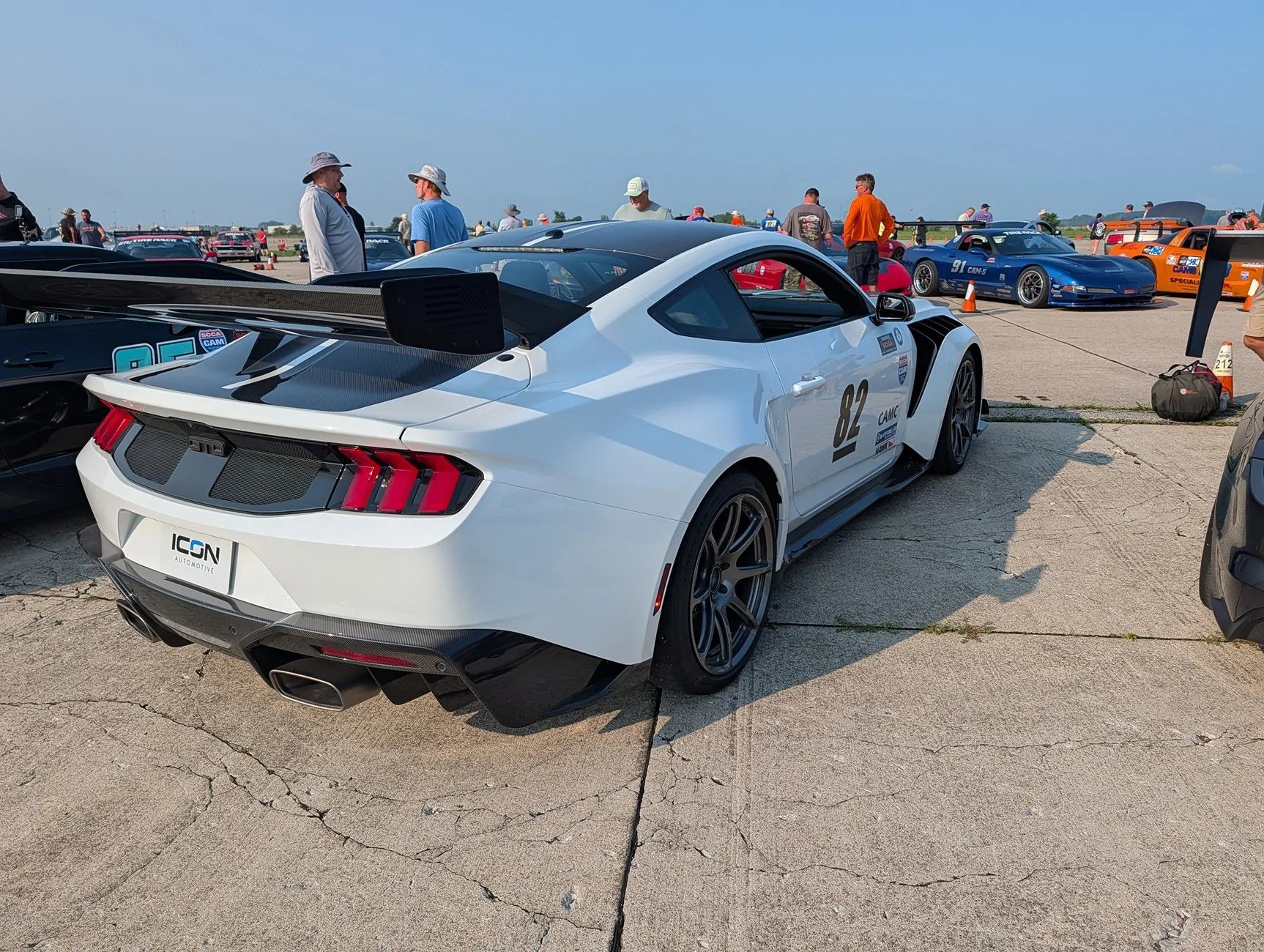

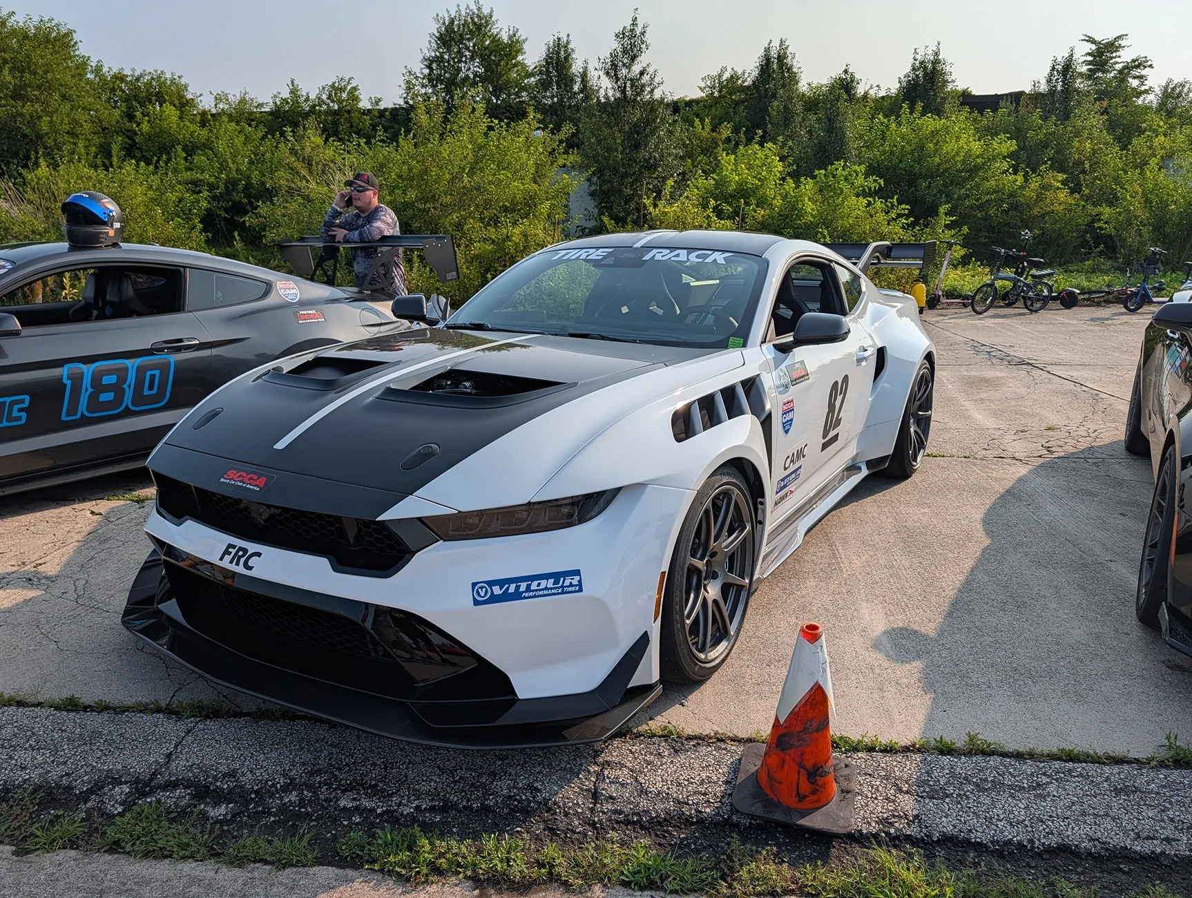

I’d sure hate to hit a cone in that.
I mean, I would, but I’d feel bad about it.

It looked really pretty, wish shiny carbon parts and really good looking paing - It had a bunch of ppf in places.
Owners also brought it to Toledo local previous weekend (I know them pretty well, they typically run 28 so we're always neighbors in the grid) so they're not shy about running it in autocross which is awesome as 99% of these will sit in the garages for most of their lives and go to car shows every 6 weeks. With driver it weighed ~4,350 if I remember correctly.
Also this car in the current state of the world is literally a decent investment which sounds weird for a car.

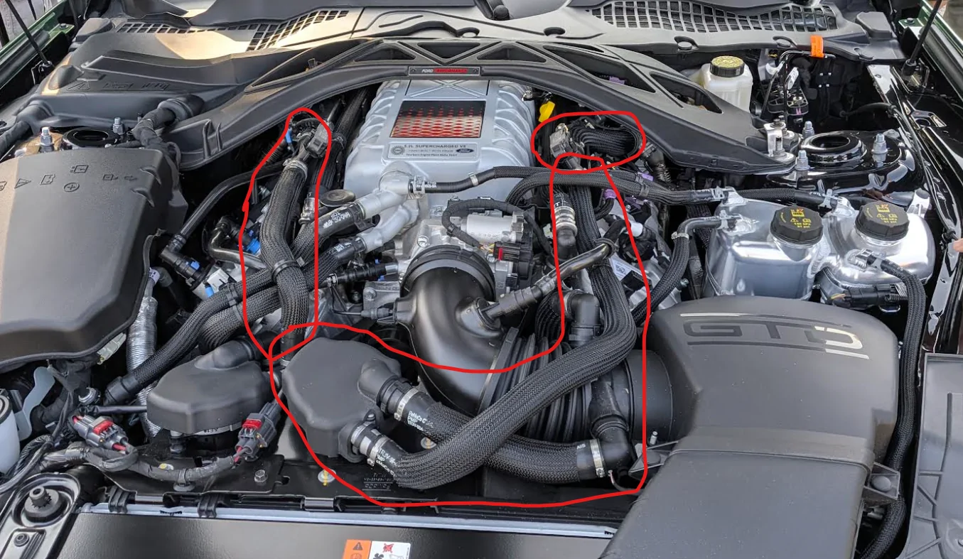

A friend took delivery of his and I got to watch it. The Ford engineer got real squirrelly when I started asking about weight, and where they found weight savings.
I was just trying to steal some ideas of what they did on the GTD, but getting a straight answer is rough.
1 spot on saw on that car was the emissions evap system, there's probably 15 lbs, if not more, of stuff under the hood recirculating exhaust into the intake to get the cats fired up faster.

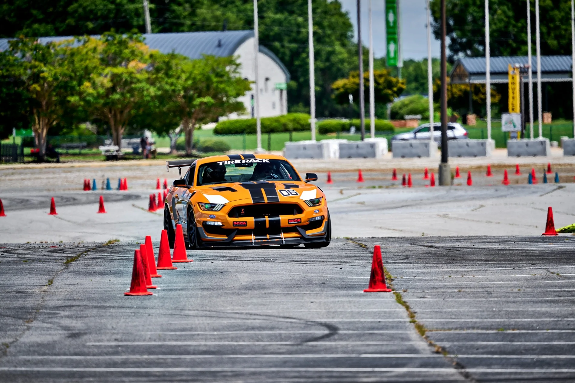

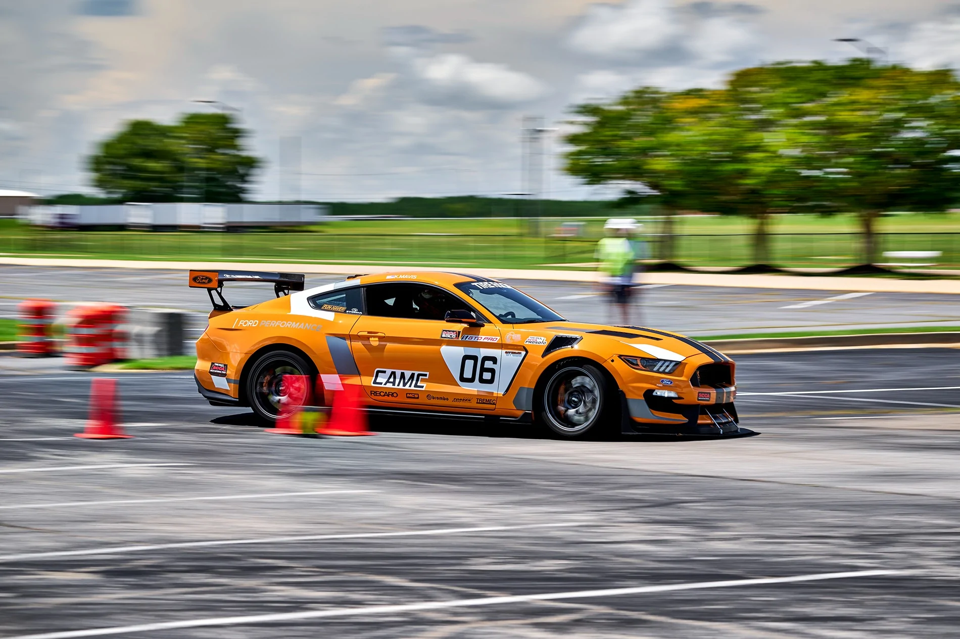

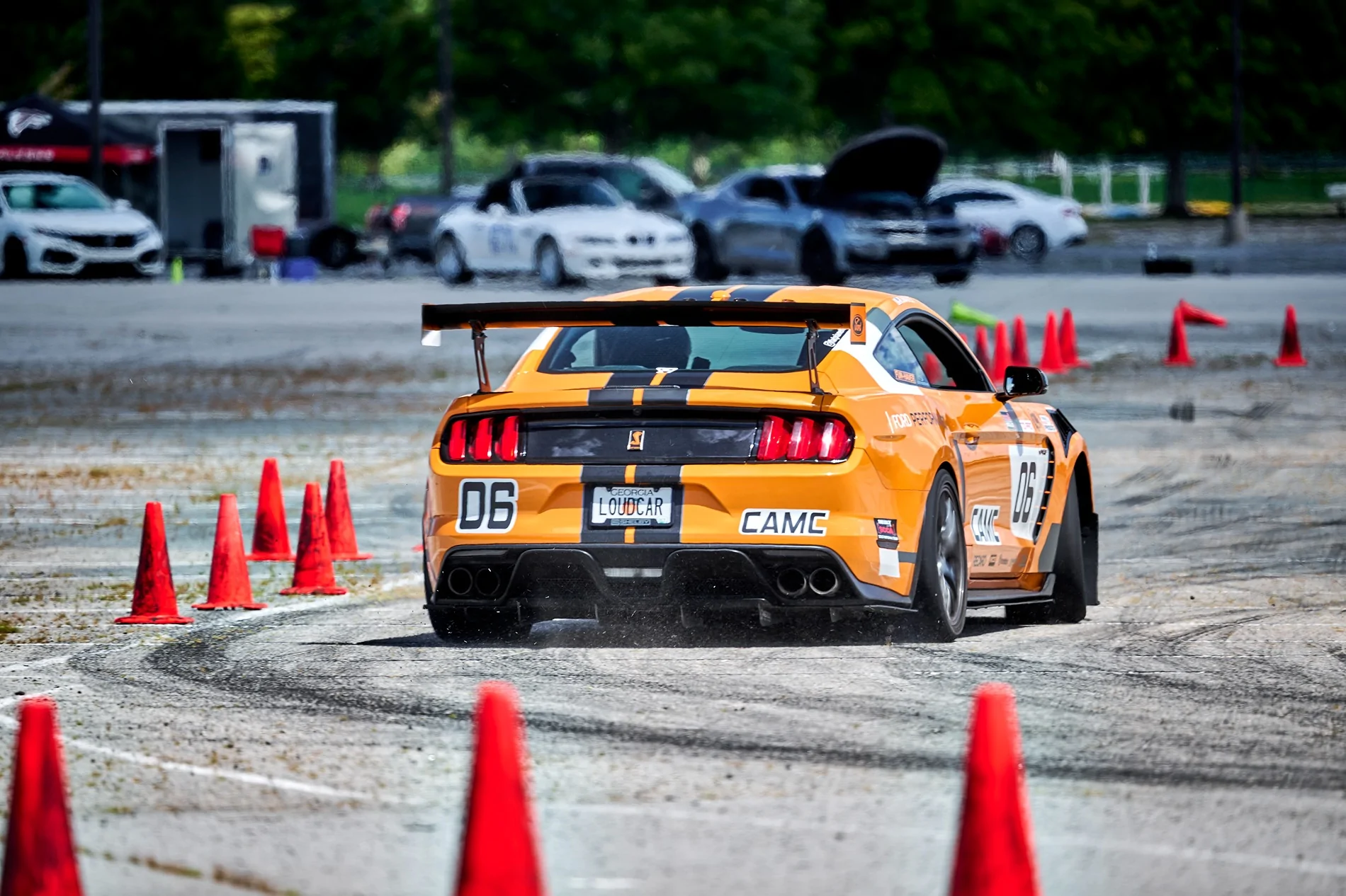

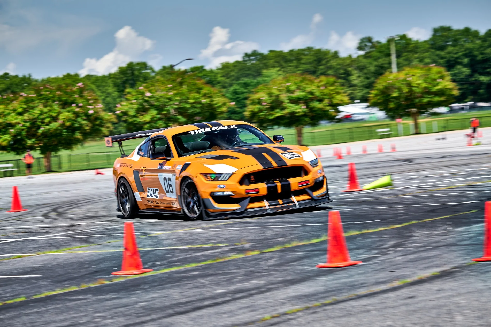

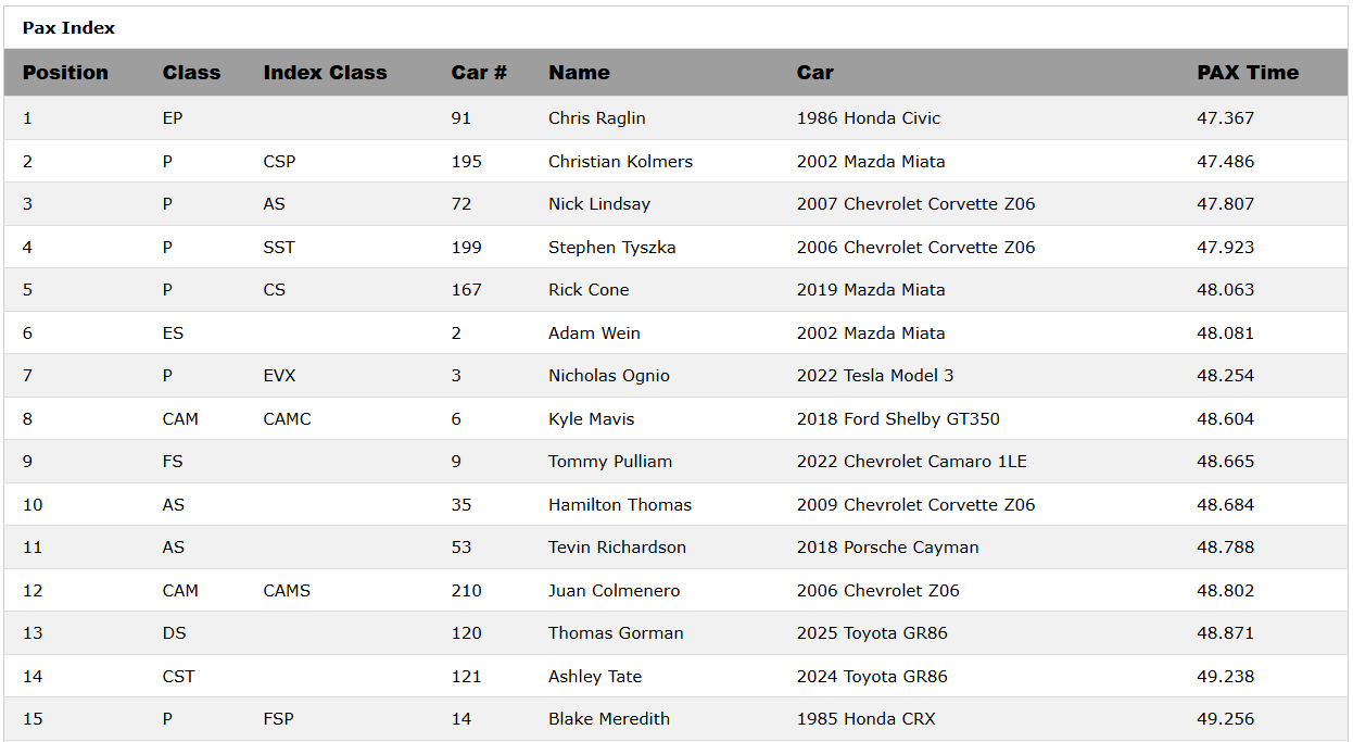

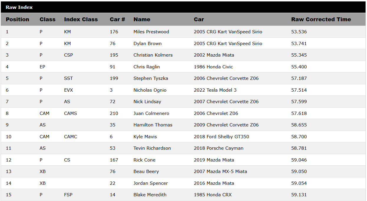

Tough course and event this weekend. Made some changes to damping to try and chase some more corner exit grip. Seemed to have found it, but that cost me some of my lift throttle rotation. Course also got nuclear hot by the end of the day with temps well into the 90's. Was spraying the tires with ice water to try and keep everything cool.
Still managed a class win and 8th overall on PAX and 8th fastest raw for vehicles with doors, but got beaten by a couple of the AS corvettes who ran before the course got nuclear hot.
