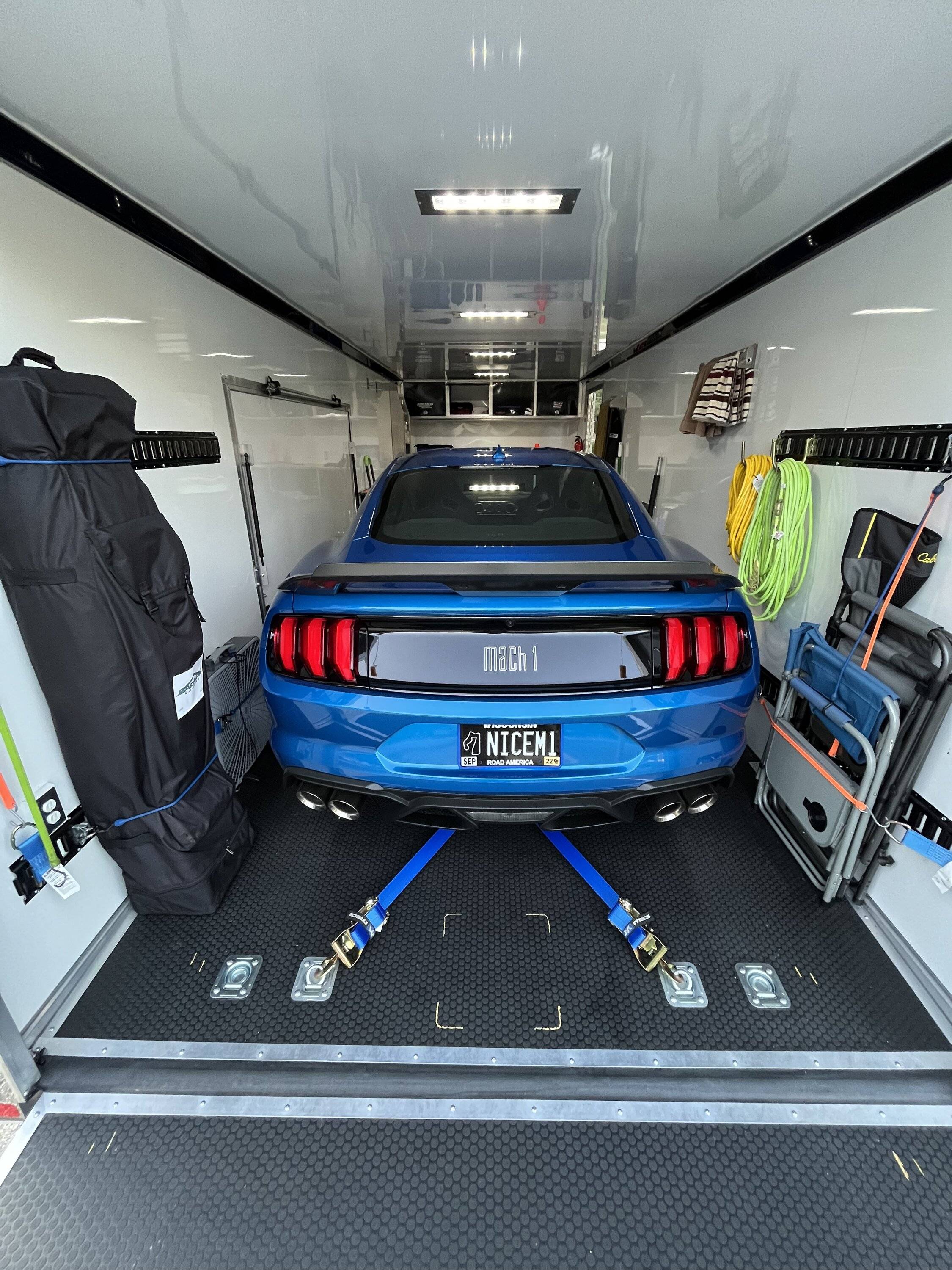

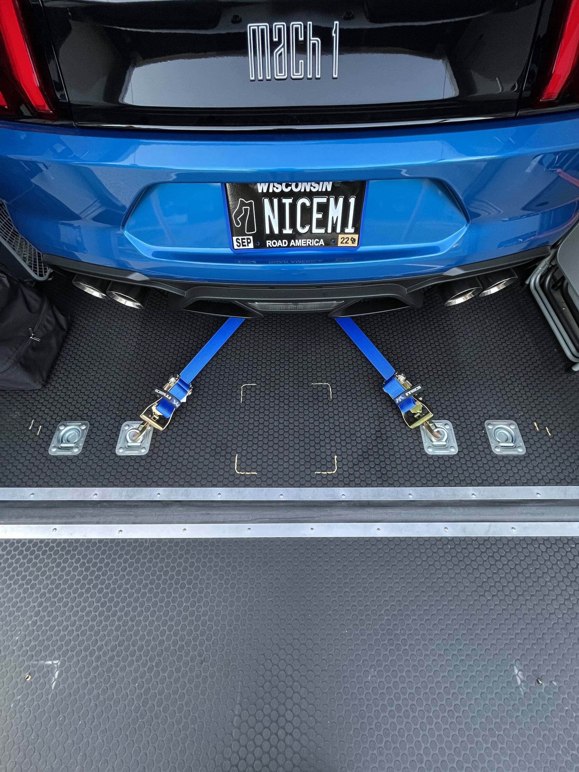

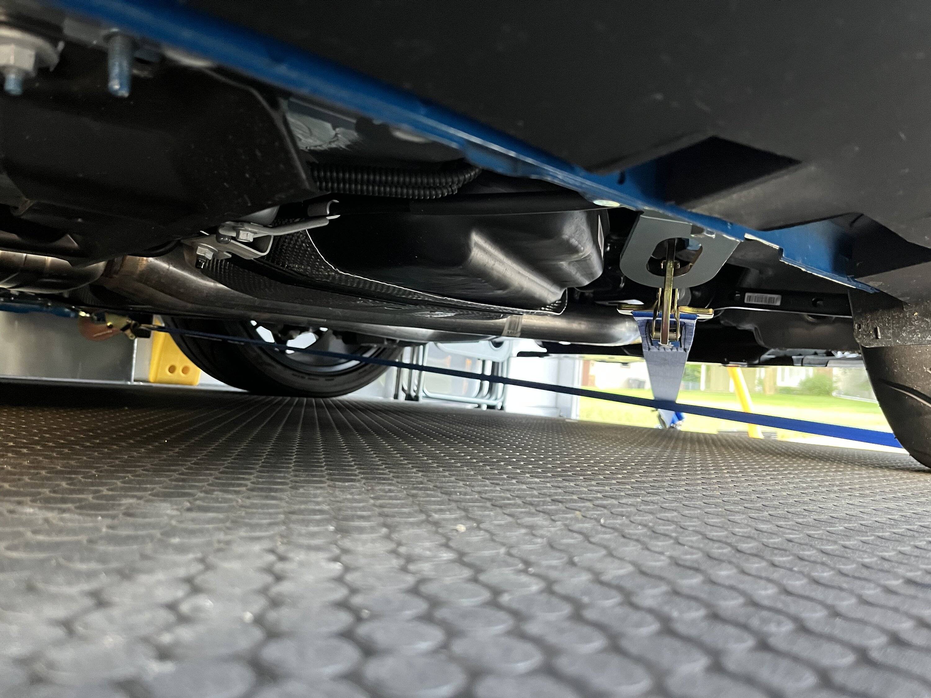

I use a in floor winch to pull the car in and then with the Etrack in the floor strap over the rear wheels to strap it in. This is a picture from when I was building the inside of my trailer.

I drive my GT into the trailer. I just cheat over to the right a bit…with the window down and the door cracked open I’m able to slide my skinny ass in and out. A bigger person might have a more difficult time. The 4’x4’ escape hatch doesn’t allow you to open the door fully, it just gives you more “room” to squeeze in and out. I paid $23,500 1 year ago for this all aluminum frame. I’d suggest a aluminum frame because a steel trailer will be much heavier. Plenty of nice used stuff on the market and if your budget is 30K, you can have a very nice set-up!

Do not, I repeat do NOT load your car backwards on the the trailer. If you load the trailer with more weight behind the axles than in front of them you will get a crazy amount of sway, and at highways speeds this can cause you to lose control of your tow vehicle. End result will be a very bad, no good, terrible, horrible, day.
Only cars that should be backed on to a trailer are mid and rear engine cars like the C8 Corvette and 911 Porsche.

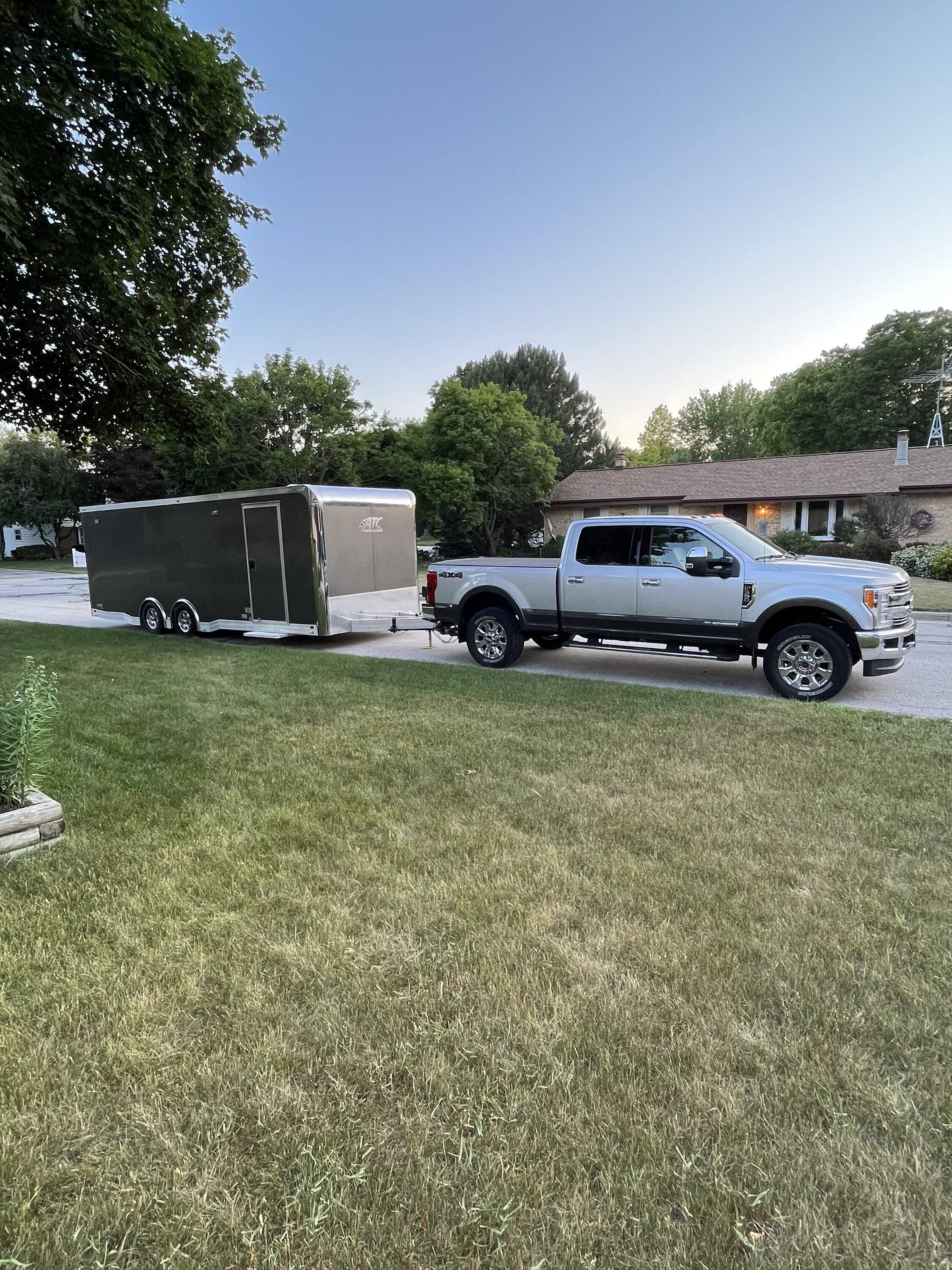

DRAGOON
Oct 10, 2021
341
1,055
Wisconsin
Mark
21 Mach1 HP VB
The way it seems to me is that the F-150 is always going to be at the max end of power, GVRW, payload, always on the top end. That’s a lot to ask. Close to beating the crap out of it. I would suggest a 250/2500 series at a minimum for an aluminum trailer, a Mustang and gear. Get a weight distribution hitch. This towing your car to the track is a slippery slope which I have traveled. Over do everything, pay a little more and then nothing to fret about. We have a F350 SRW, 24’ ATC with the Eaz-Lift Trekker 1200 WDH.

Dragoon, that's a super setup you have. I agree with you, using a F250 (or similar), plus a really nice light weight 24+ foot all aluminum trailer would be best, but that setup is going to cost $100,000 minimum, and may not be an option for OP.
A F150 towing a light weight all aluminum trailer with dual axle brakes, brake controller, and a weight distribution hitch would work fine. Total cost less than $30,000.

I tried to show what I have so I feel safe and comfortable without being too smug or a prick with money which is not the case. I was fortunate to procure my set up 5 years ago before everything went frinkin’ nuts. The car just a year ago. So yeah, it maybe not for all pocketbooks but what is possible with well spent money.
