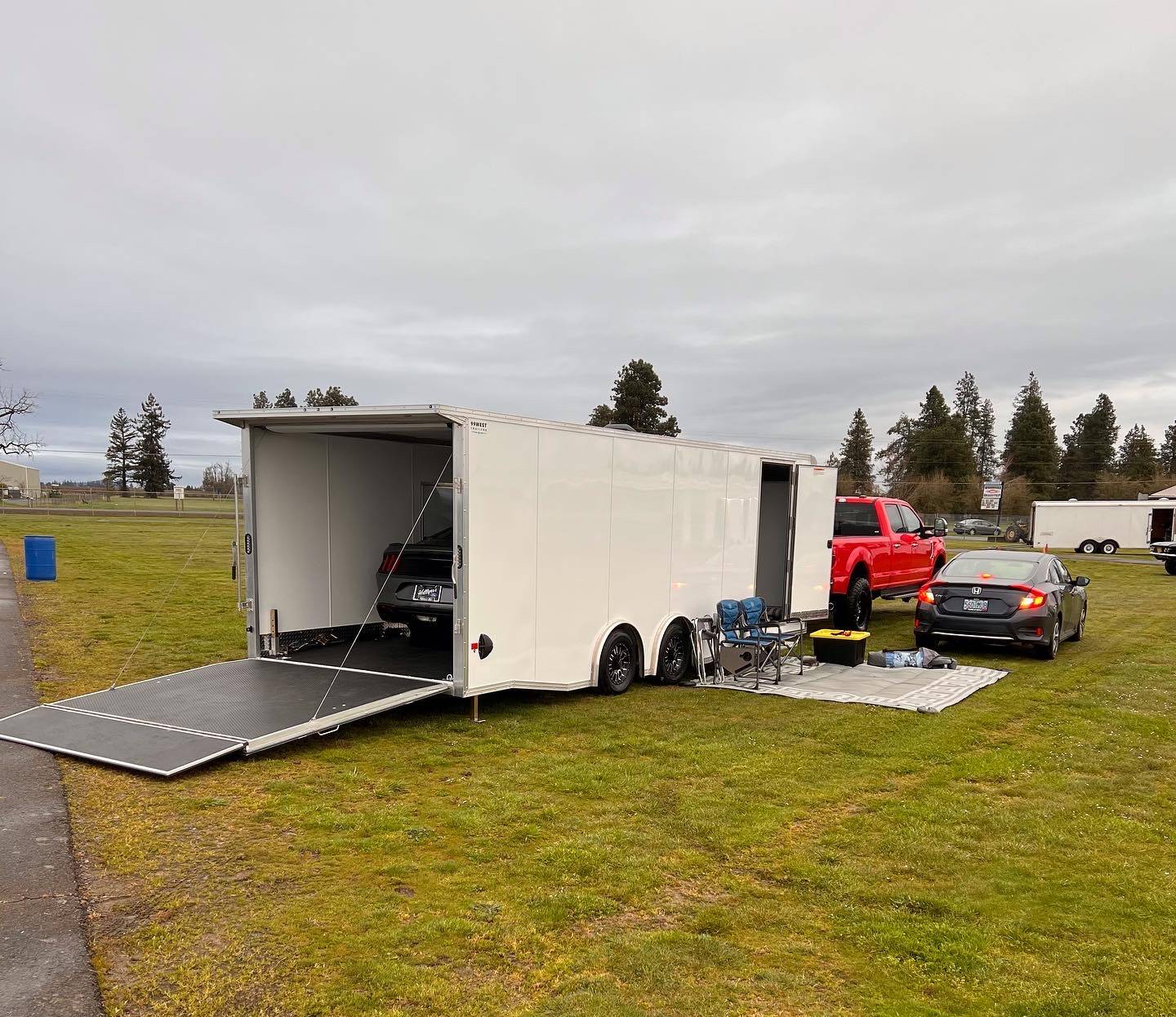

If you buy a 20’, you’ll wish you had 24’. If you buy a 24’, you’ll wish you had 28’.
I have a 24x8.5 and love it, the extra room is always a good thing……but I still wish I had 28😂

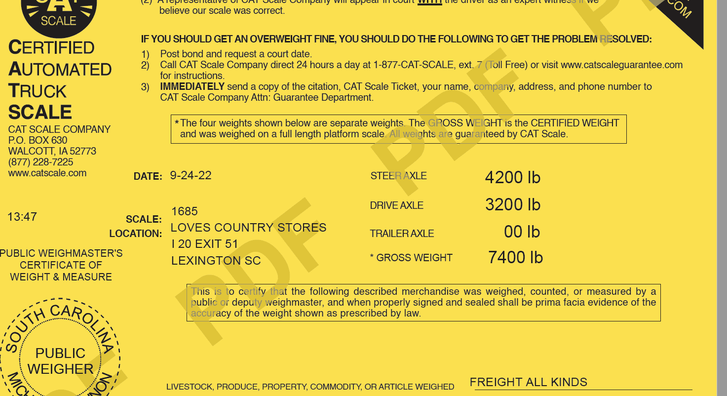

I think you can get a lot more trailer than you think under the weight of your F150. The weight tickets below are from truck (f250) ready to go to the track (tools spare wheels etc) and then the ticket with trailer and car in it. I have a steel 28' trailer with 12" extra height, with bathroom, generator, bed, water heater, AC unit and with load distributing hitch only at only , 1500 lbs tongue weight and 10160 lbs total trailer with car. I don't know for sure what all the extra stuff on my trailer weighs but the generator, is on the tongue with a 5 gal fuel tank. There is a water tank, bed, battery, water heater, and cabinet with a microwave in the 1st 30" of the trailer. So I would think a 24' trailer especially if you got a aluminum one would be no problem for your truck.

That is a nice rig you have there! And thank you for the information. Do you drive the Mustang onto the trailer or do you have a wench? Any other tips or do's and don't for buying a trailer?
Buy new or used? What do you think my budget should be to get something nice?

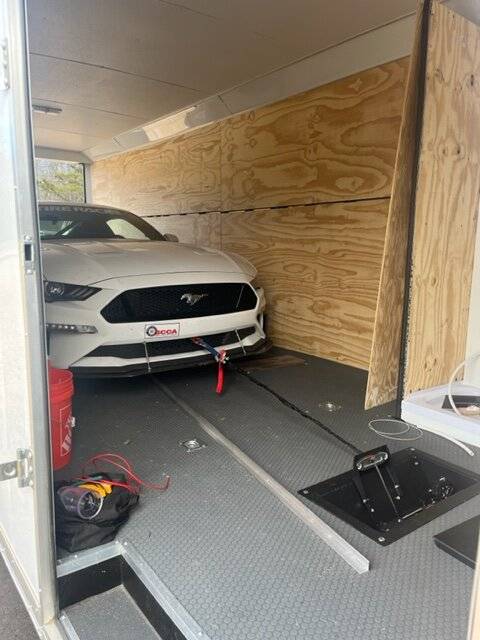

I use a in floor winch to pull the car in and then with the Etrack in the floor strap over the rear wheels to strap it in. This is a picture from when I was building the inside of my trailer.
For your cost, it seams the top of the market is past us, and pricing is getting more reasonable. I have seen a lot of trailers for sale on FB 24' ish in the 7 - 14 range for plain plywood interior to 35k for a full race package with AC, cabinets, generator cabinet. I bought mine for right under 20K before the market went crazy and built it out to suit my needs.

Do you wench the car into your trailer or drive it in?
