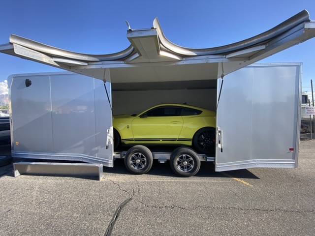

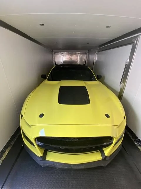

I went through this same decision earlier in the year. For me it was a balance of weight, options and size. Everyone says get as big of a trailer that you can afford.....but how big is too big.
For me I ended up getting a 24' aluminum trailer with an oversized escape hatch.
I do not need a golf cart at the track and it holds the extra stuff I may need to bring. Other then wanting to add a couple things, it fits my needs perfectly.
I do pull it using a WDH with my F-250.....tho I have pulled it behind my 19' Raptor once (was not a fan).

Thanks for the info and photos! If you were buying a new 24’ trailer today, what options would you look for? Airline tracks?, wall ties, upper cabinets, lower cabinets, extended ramp, etc?

Mine has upper and lower front cabinet (not L shaped) and I like them but it does take a way 2 feet of floor space. I also upgraded the tires from Chinese branded to Good years and immediately noticed a difference while towing (way better road manners).

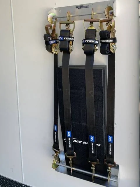

I did not know how I wanted to setup my trailer so I did not get it with e-track/airline tracks installed as I will configure those later. I added some Pit posse items (door cabinet, strap brackets, etc.) and those have been handy.
I added a battery and winch (with synthetic line) mounted behind the lower cabinets for just encase reasons.
I also have a set of race ramps to help extend the loading ramp. I opted for these vs longer ramps attached to the trailer for versatility.
I do wish I had a d-ring closer to the car vs all the way in the front so I will fix that in the future.
I may add carpet on the lower part of the walls to keep things looking nice and figure a out spot to mount my spare tires to where I can get to the with a car loaded in the trailer.

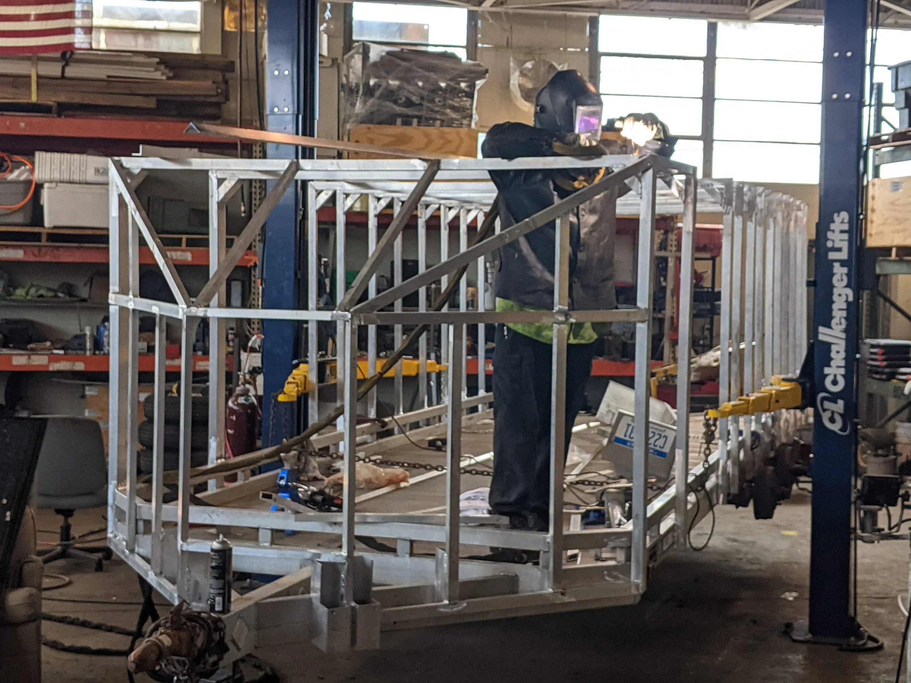

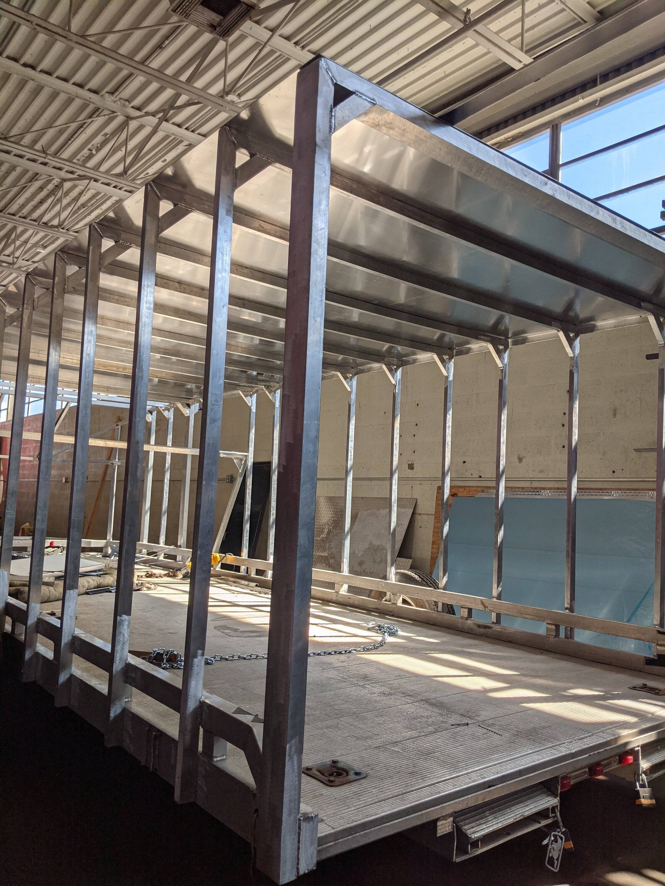

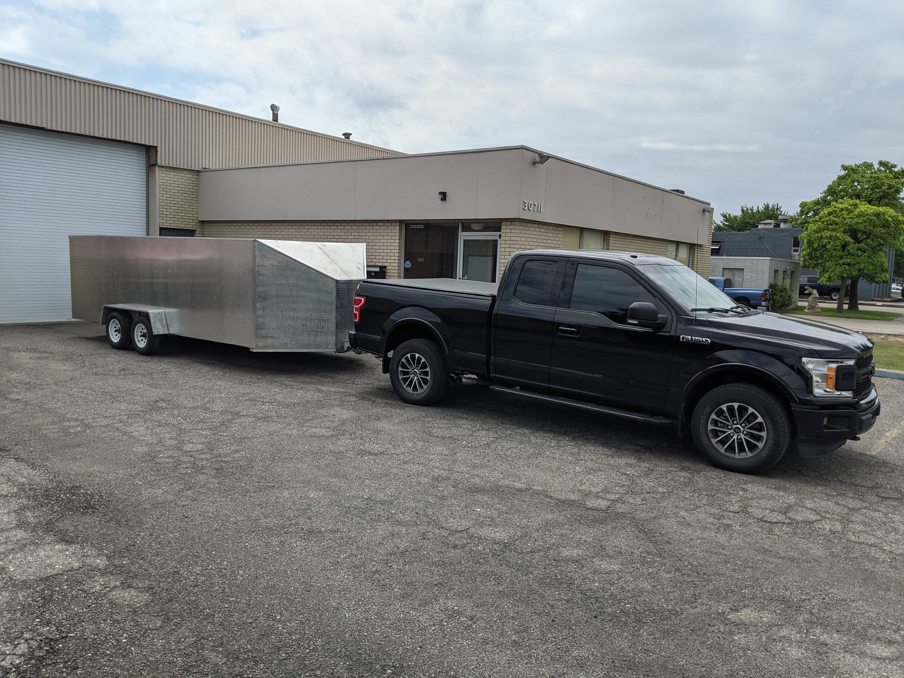

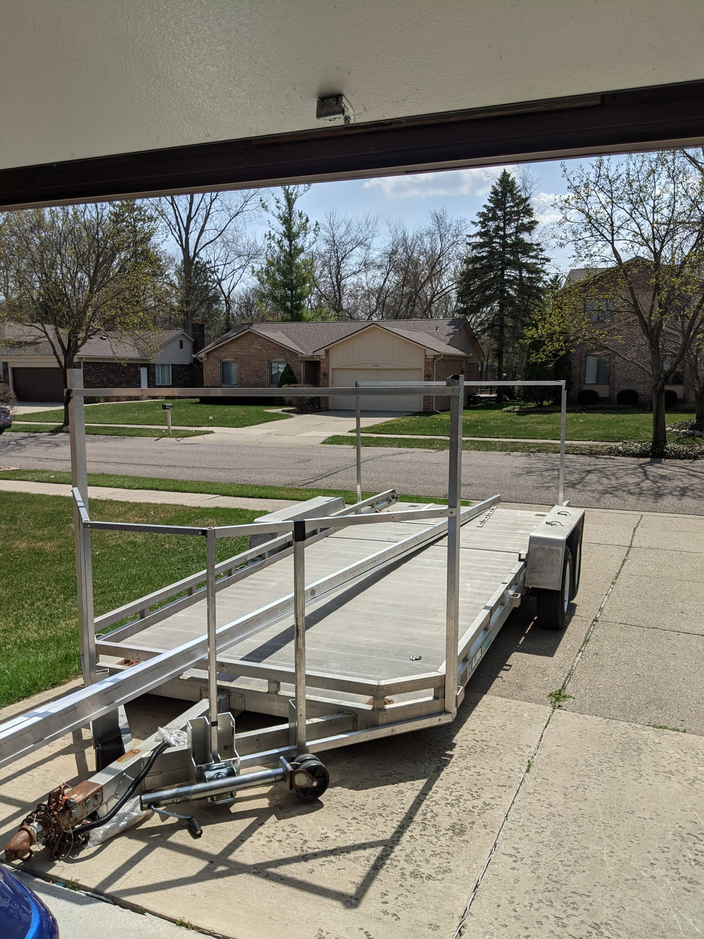

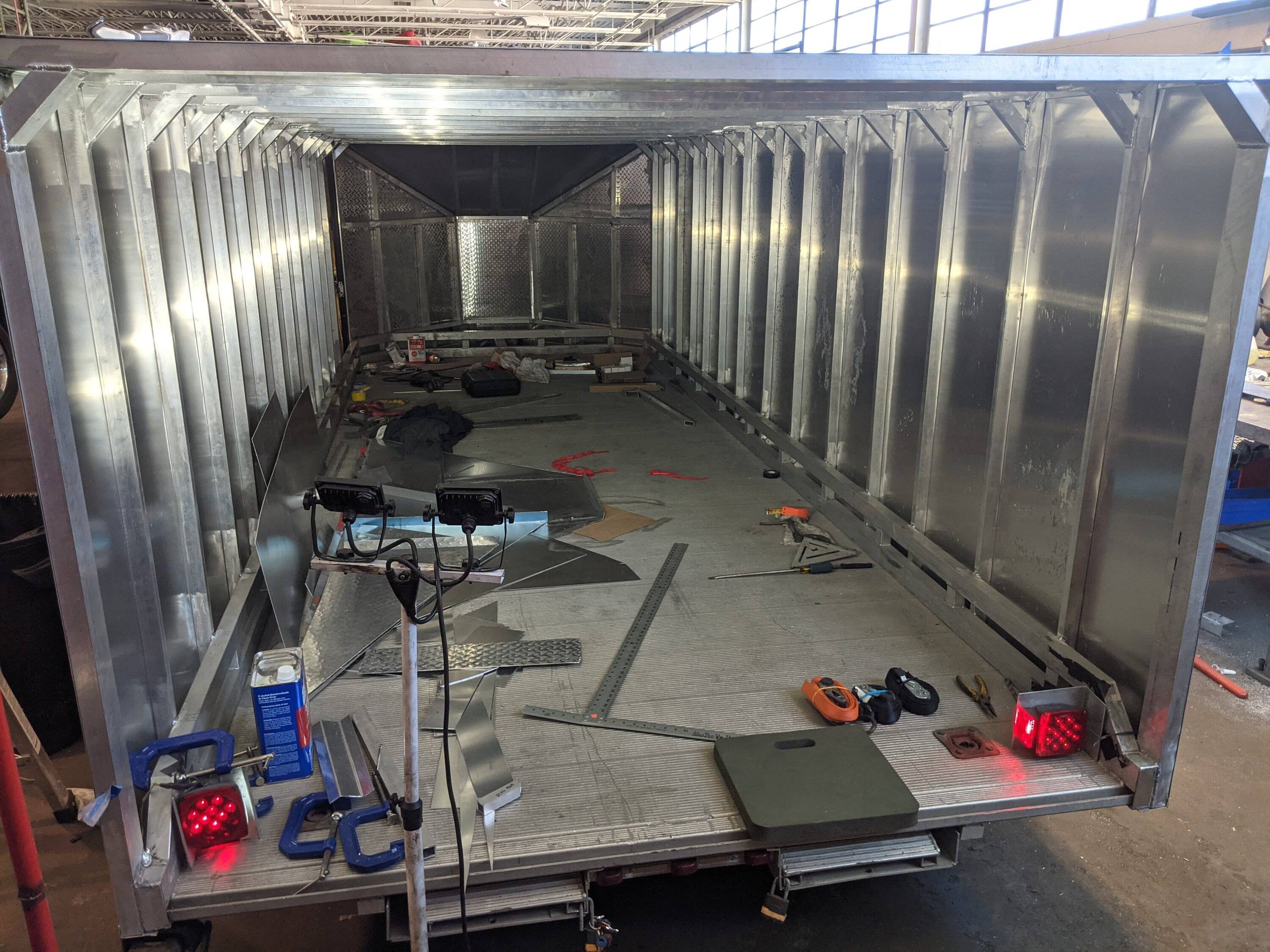

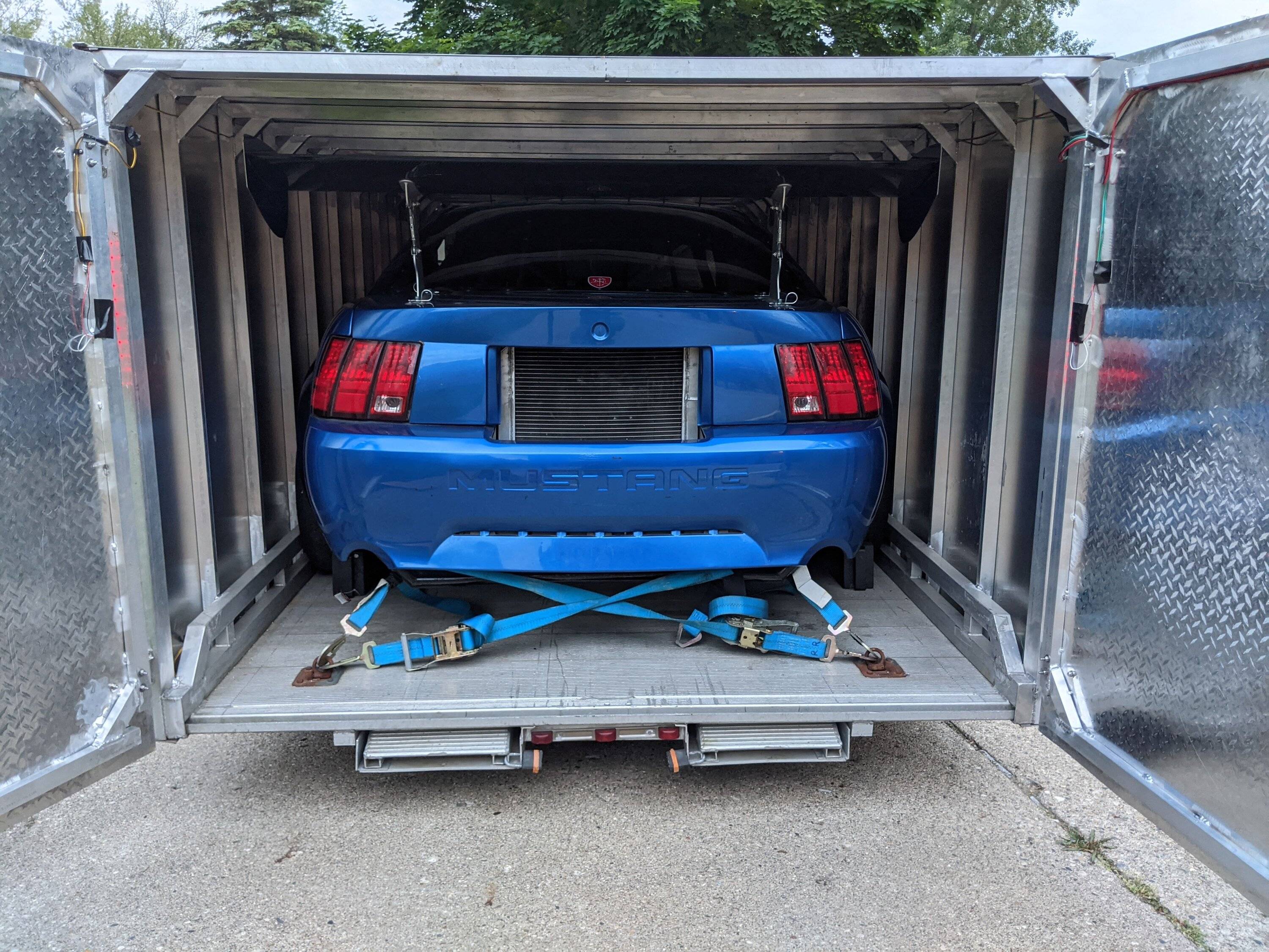

I had a open trailer, that I finally converted to enclosed. Did all the work myself. Ended up with 2,000# all aluminum trailer, with custom aerodynamics. Yeah, you have to winch it in/out, and you cannot stand and walk in there. I know, but once at the track I unload and never enter inside again anyways - that is my story.

Wow. Quite a skill set you have there!
