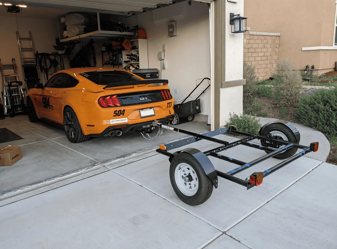

For those who want to bring track tires to the track but either don't want to stick them in the back seat or who have a roll bar installed, there is always the tire trailer route.
Curt 1-1/4" receiver
Curt 5" riser
1-7/8" ball
Leroy Engineering Paddock 335 Tire Trailer

That's cool! I bet one of those little Harbor Freight trailers would work too. (For people on a budget.)

Absolutely. It'd be pretty easy to make your own as well

What tow hitch do you have with that and how much weight does it add? Or do you remove it before the event and put it back on at the end?

The equipment is listed in the first post.
I didn't weigh it before install (bathroom scale was dead at the time) but I think it's around 35-50 lbs. The receiver is on the car tight; no way you could remove it before and reinstall.
I agree, the added weight is gross but other than buying a truck and trailer, this is my only option to be self sufficient. Can no longer fit my track tires in the back with the roll bar in.

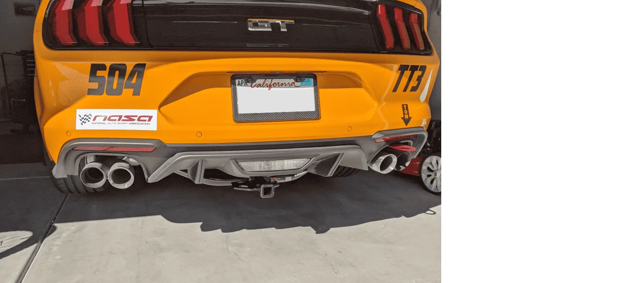

How much drilling or cutting is required for installation? Do you have any pictures of the back of the car without trailer? Wonder how discrete it is. Thank you!

Do you have a catback exhaust installed with the hitch and is there interference between the two?
I'd like to install the same hitch on my car but I also want to install an aftermarket catback exhaust. On my old 1995 GT, the trailer hitch and Magnaflow mufflers would rattle against each other and I really want to avoid that.

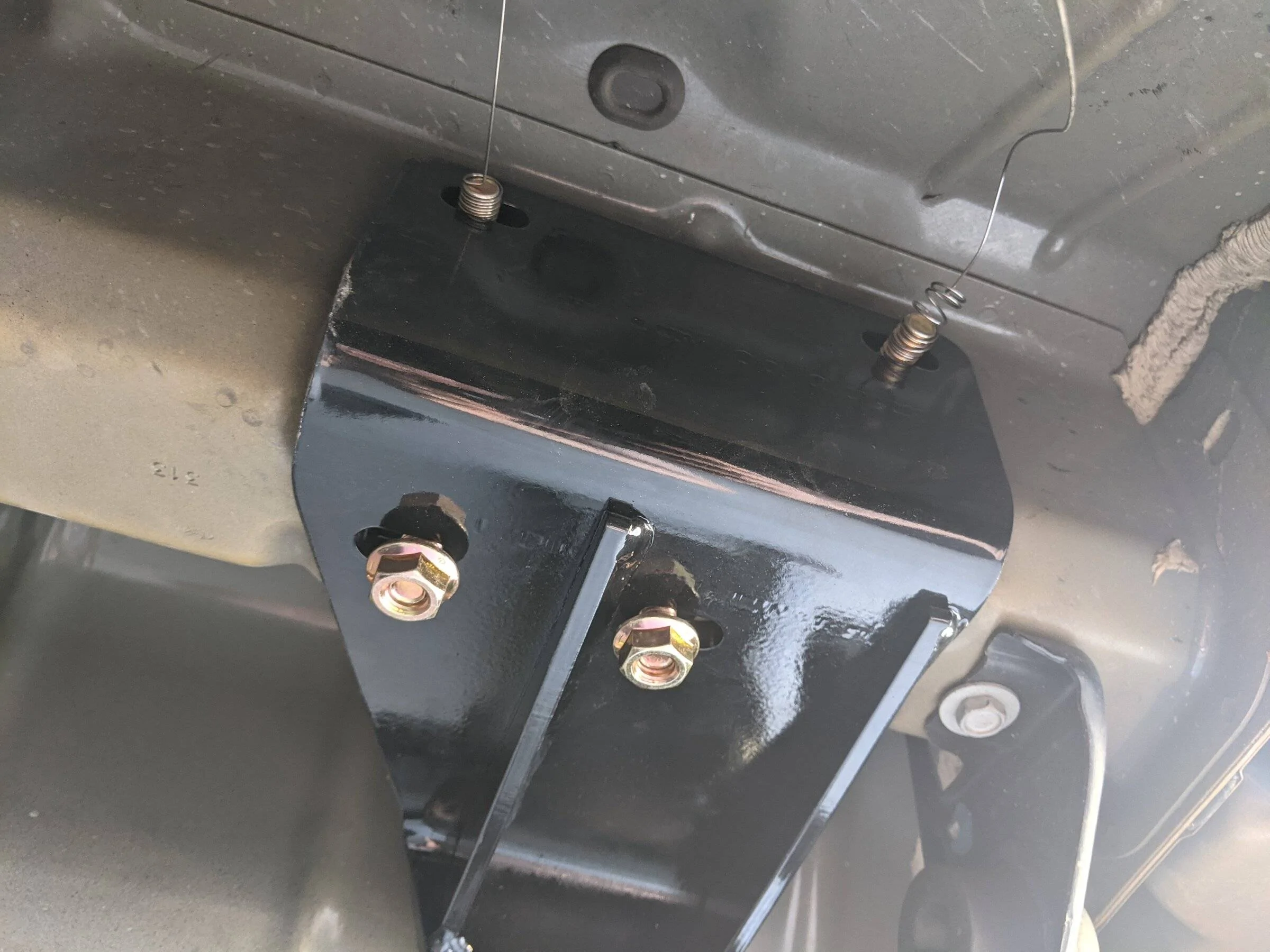

Zero cutting or drilling required to install the hitch. Completely reversible. It uses existing holes.
I will say it's a total pain to install though, very tight fit and the way they have you install bolts is smart, but very difficult and time consuming.

I have axle back installed and there are no clearance issues. It sits between the mufflers and doesn't sit very far forward

Thanks for the information and pictures. It helps.

That's awesome, thanks for sharing. I might do the same install.
