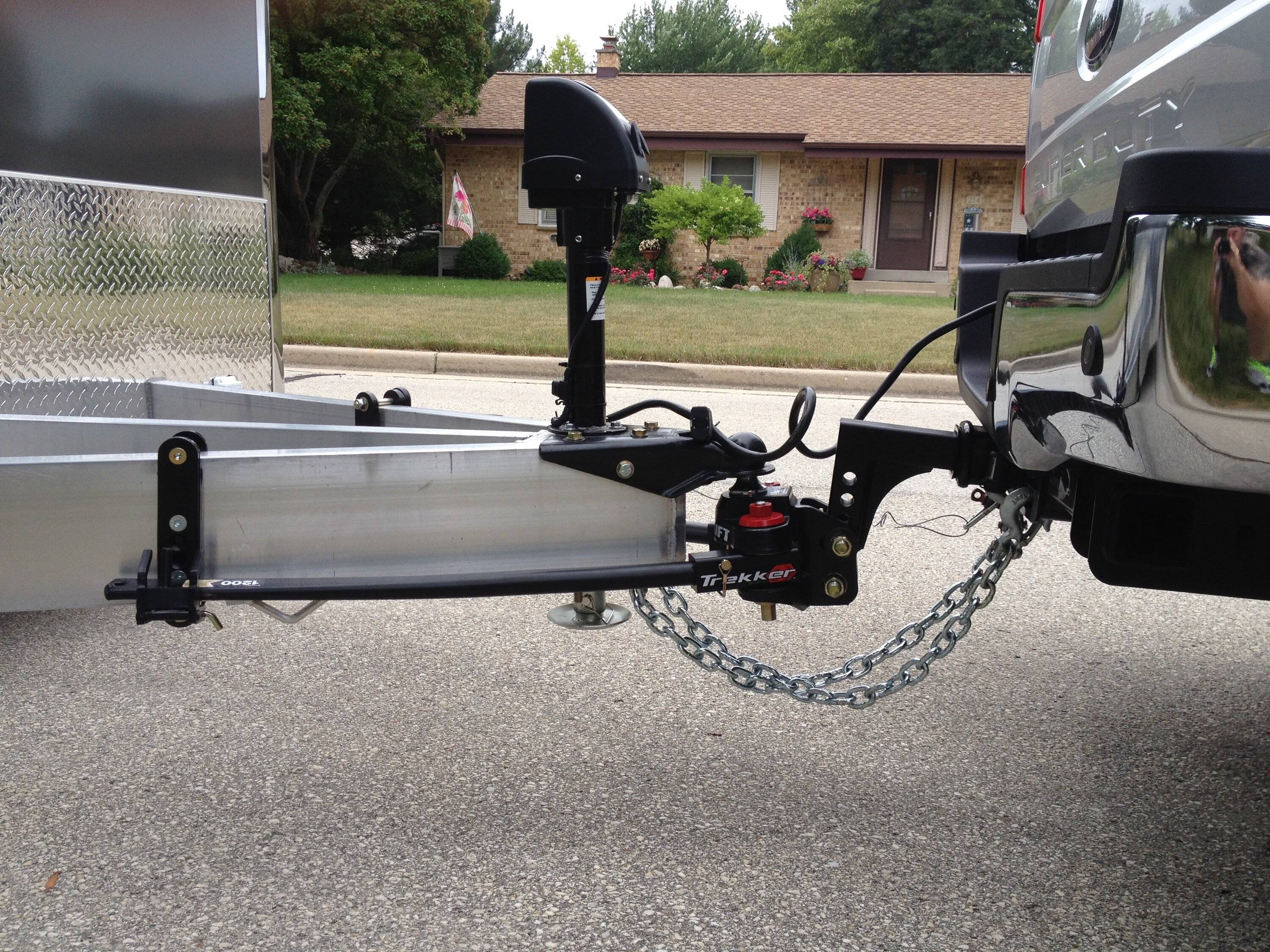

Great that you added that here in this thread, I think the WDH can be advised to use not enough. They’re a wonderful tool.
I use the Camco Eaz-Lift Trekker 1200 WDH with sway control.

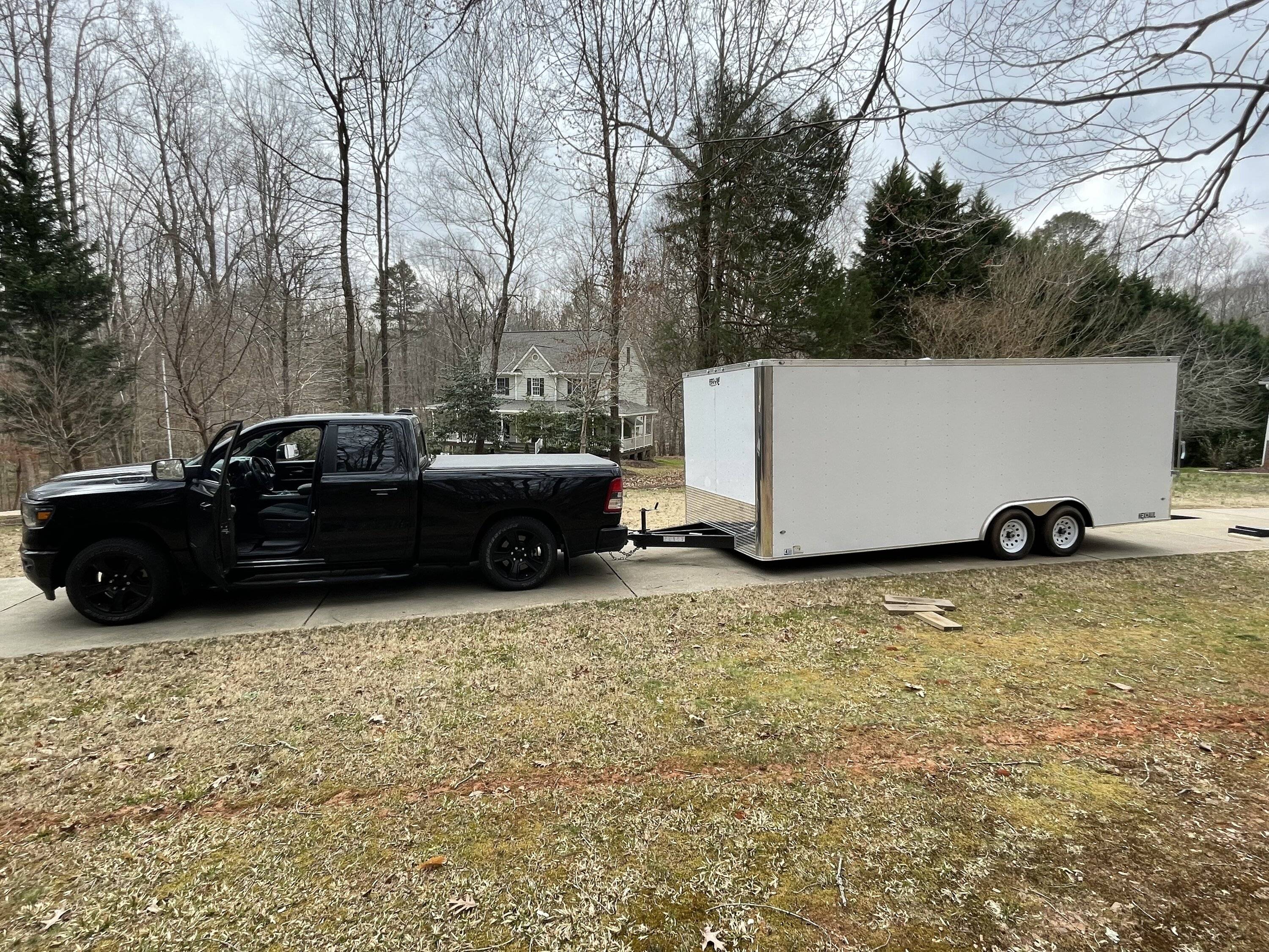

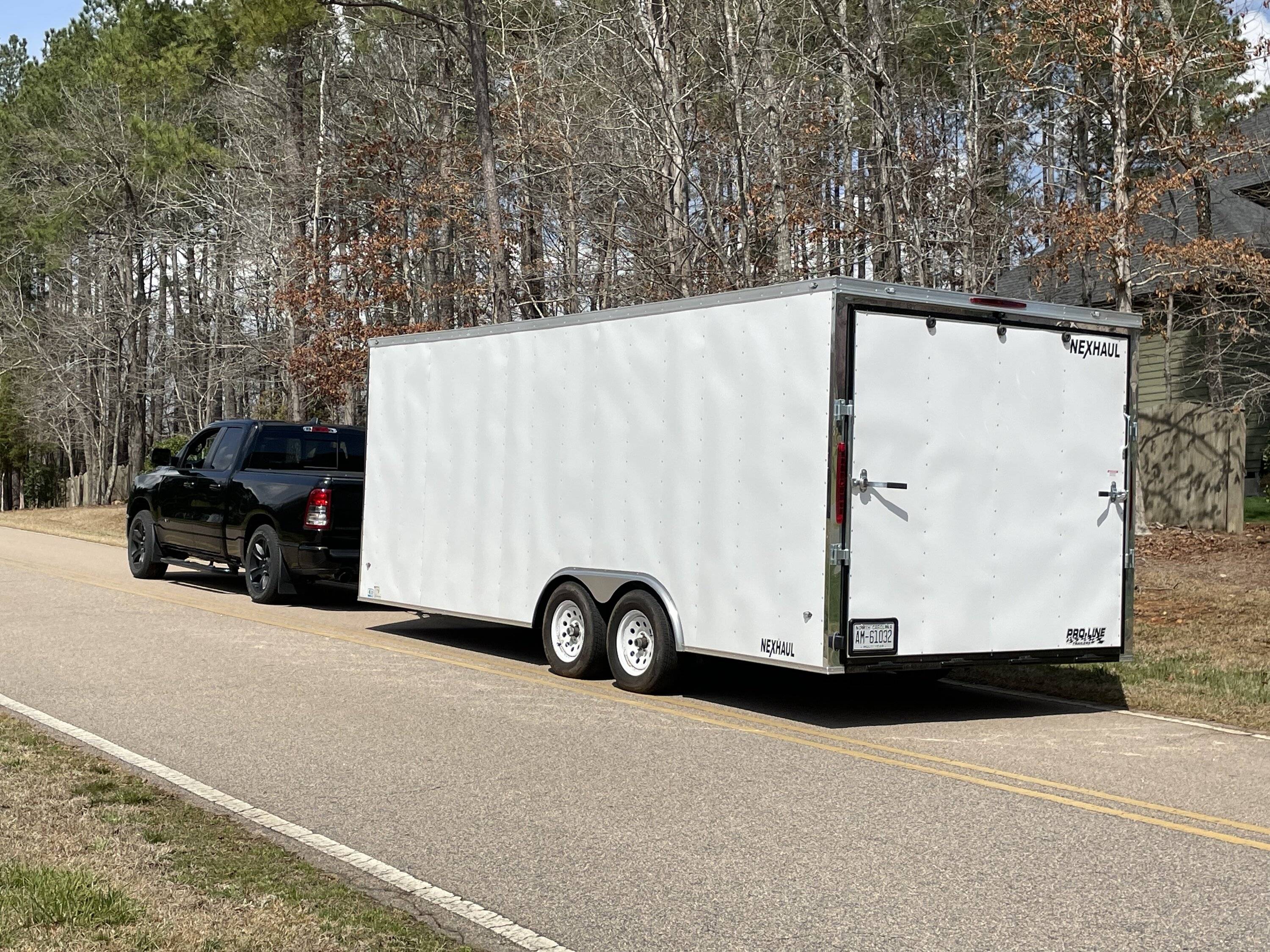

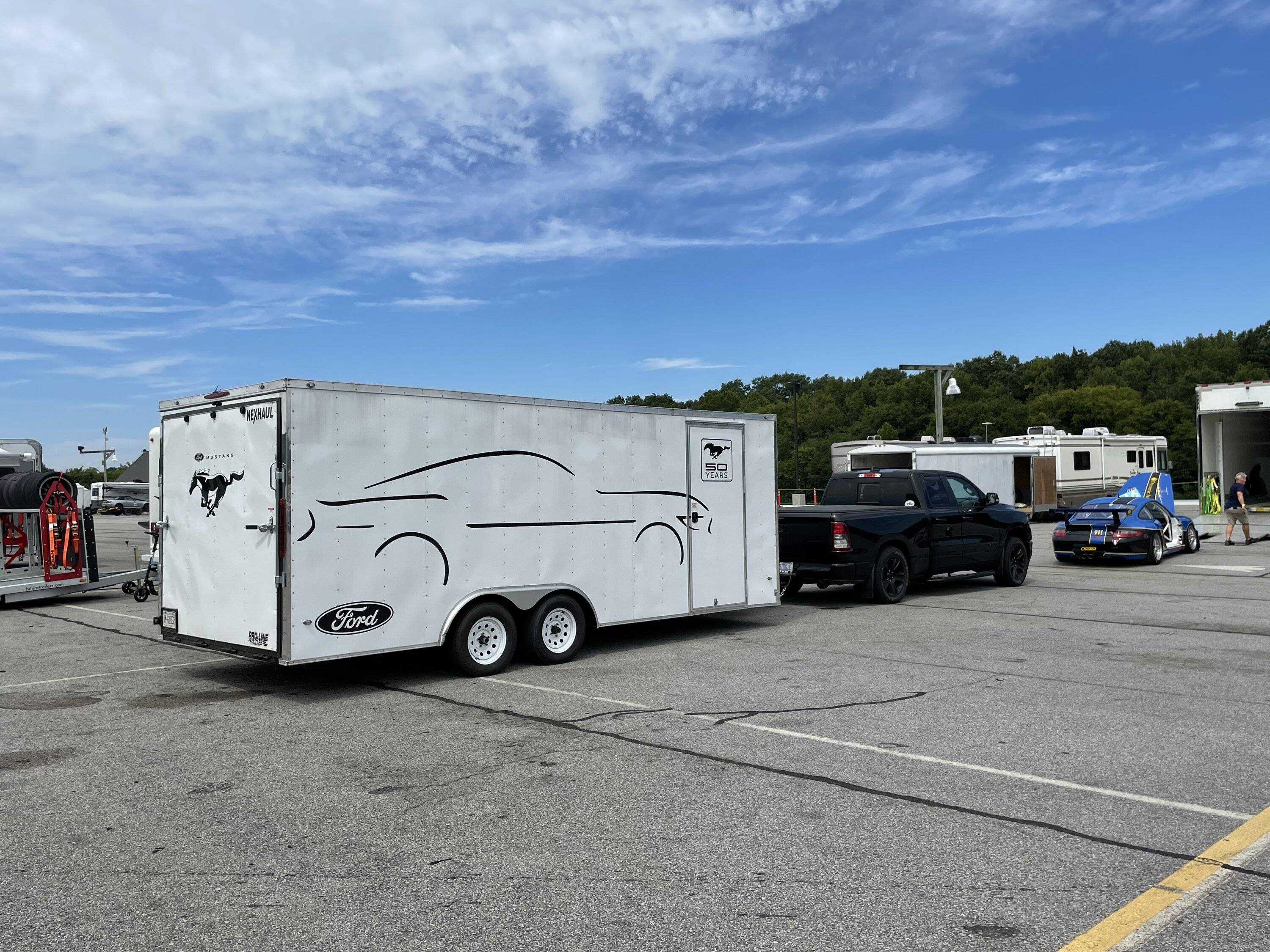

I tried to show what I have so I feel safe and comfortable without being too smug or a prick with money which is not the case. I was fortunate to procure my set up 5 years ago before everything went frinkin’ nuts. The car just a year ago. So yeah, it maybe not for all pocketbooks but what is possible with well spent money.
Very cool rig! Your post was very helpful. Thank you! Love the M1!

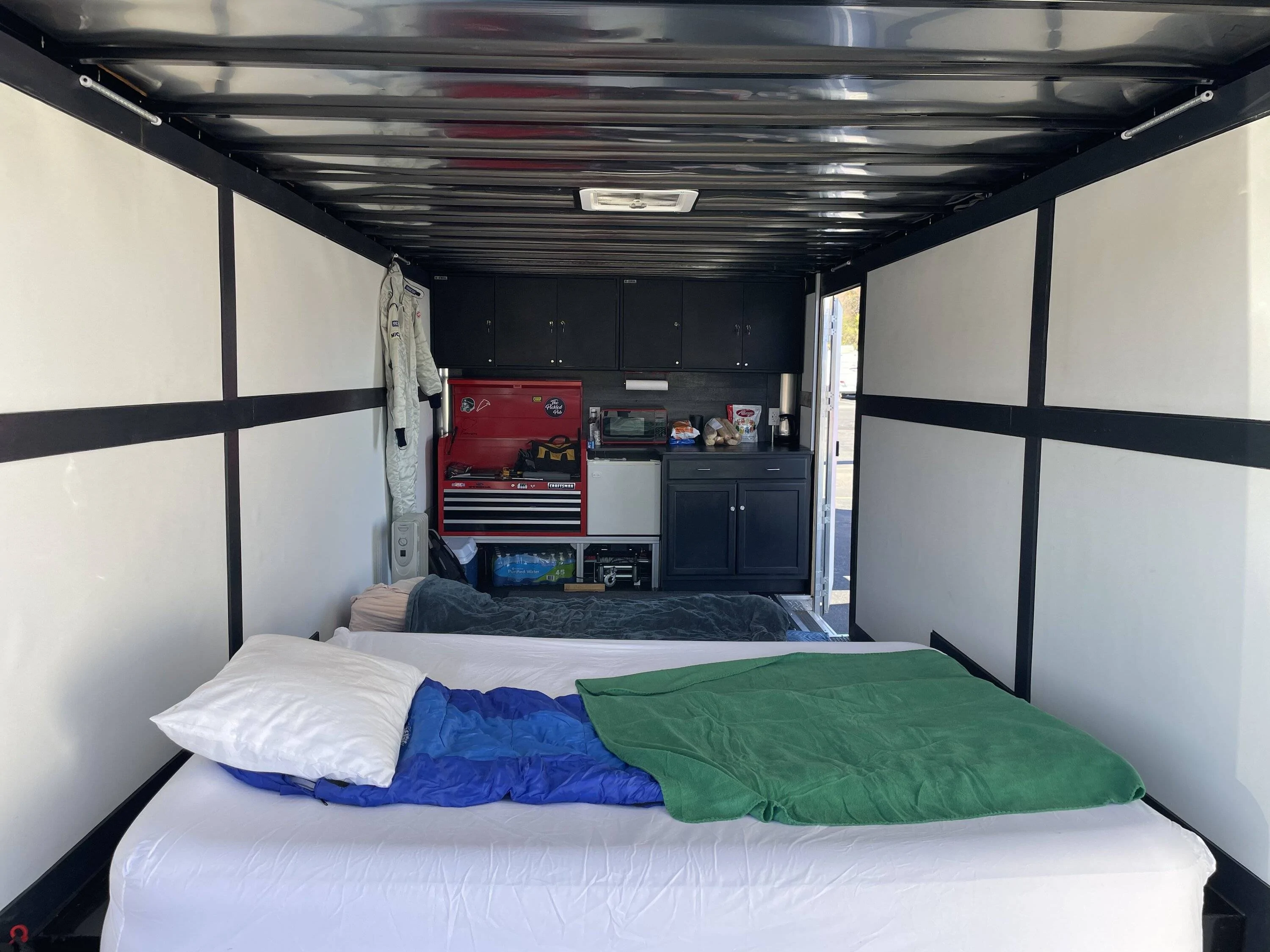

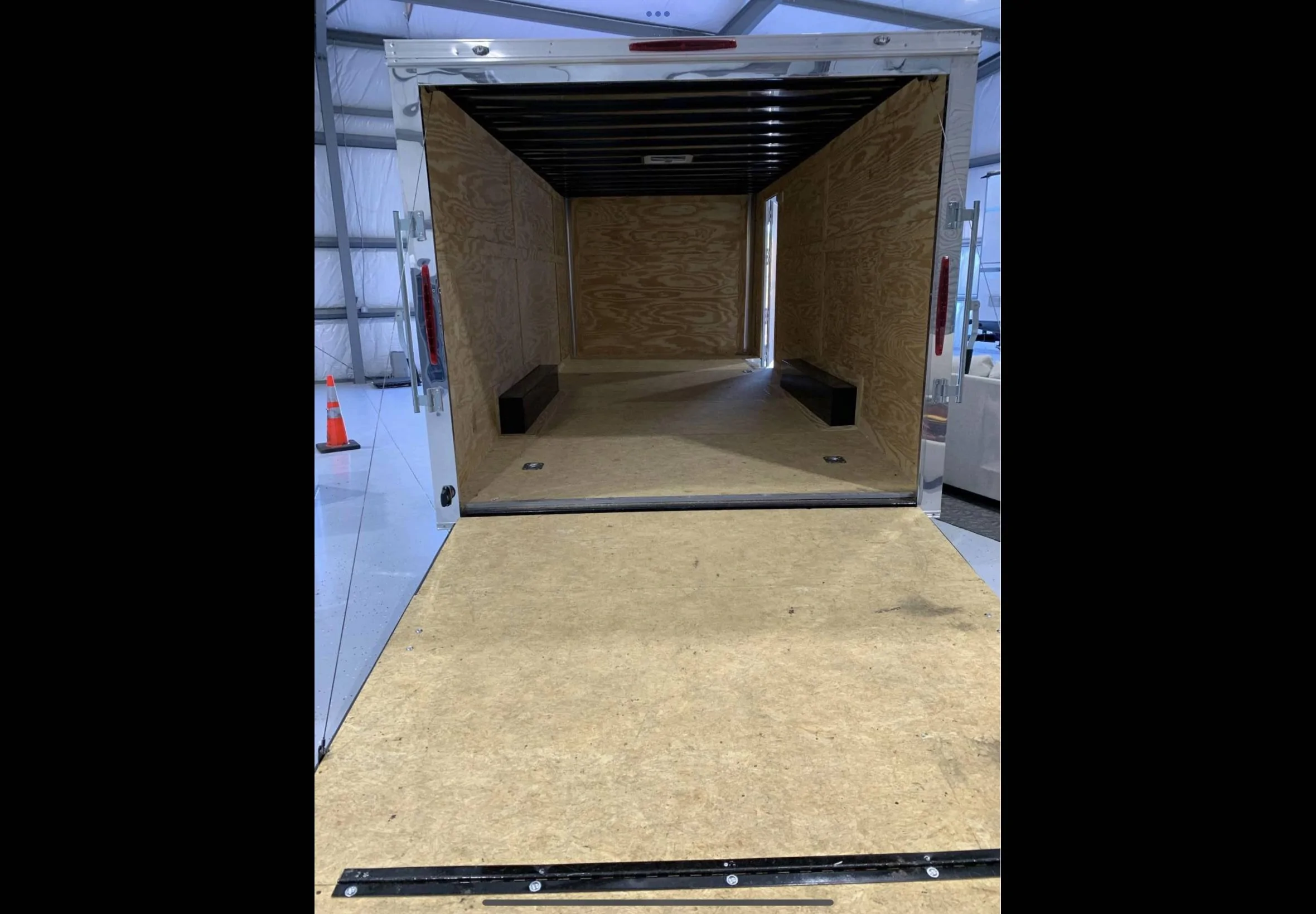

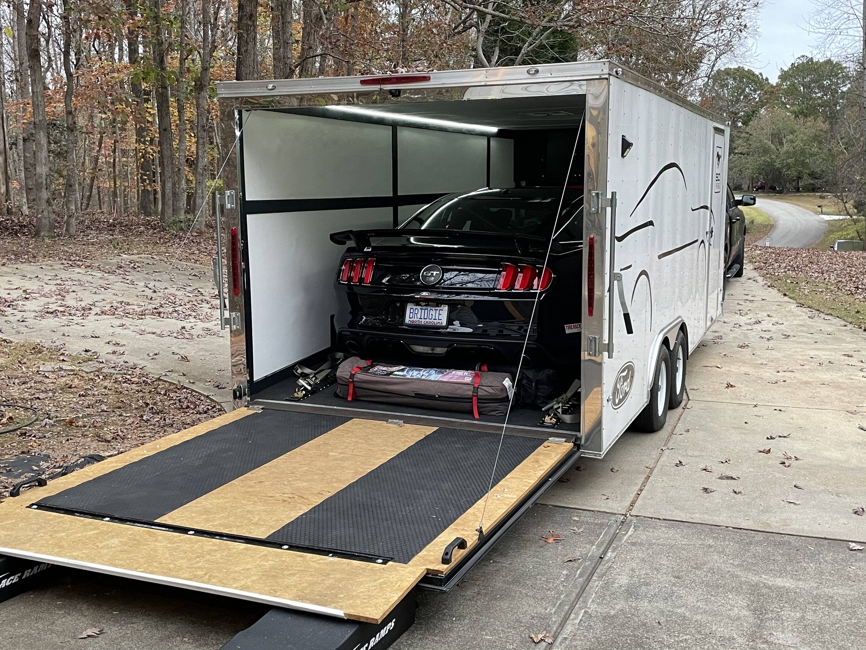

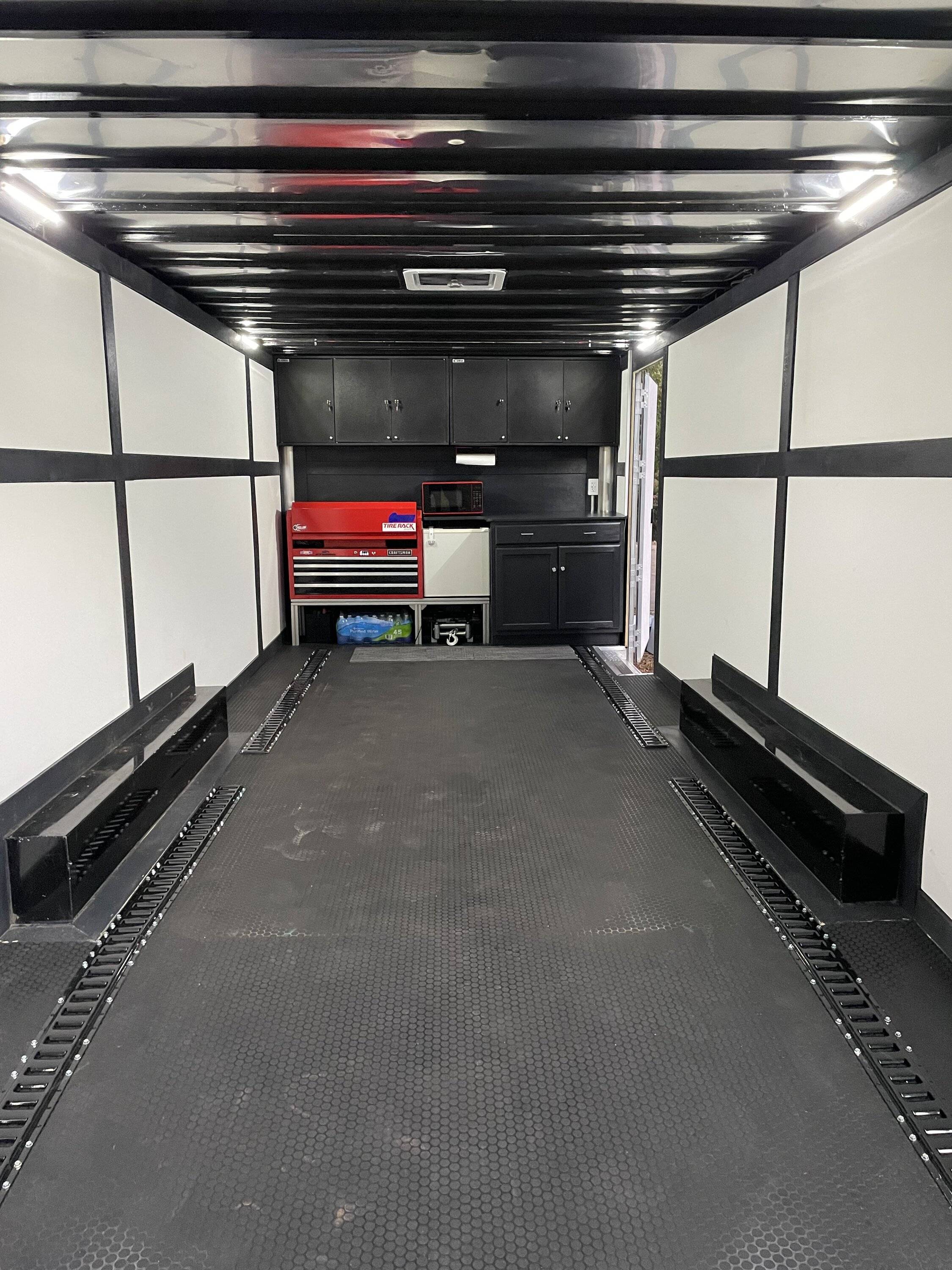

I bought a stock, lightly used 20 x 8.5 enclosed earlier this year. I have a Ram 1500, which tows OK, but with the fat ass Mustang, it gets up there in weight..

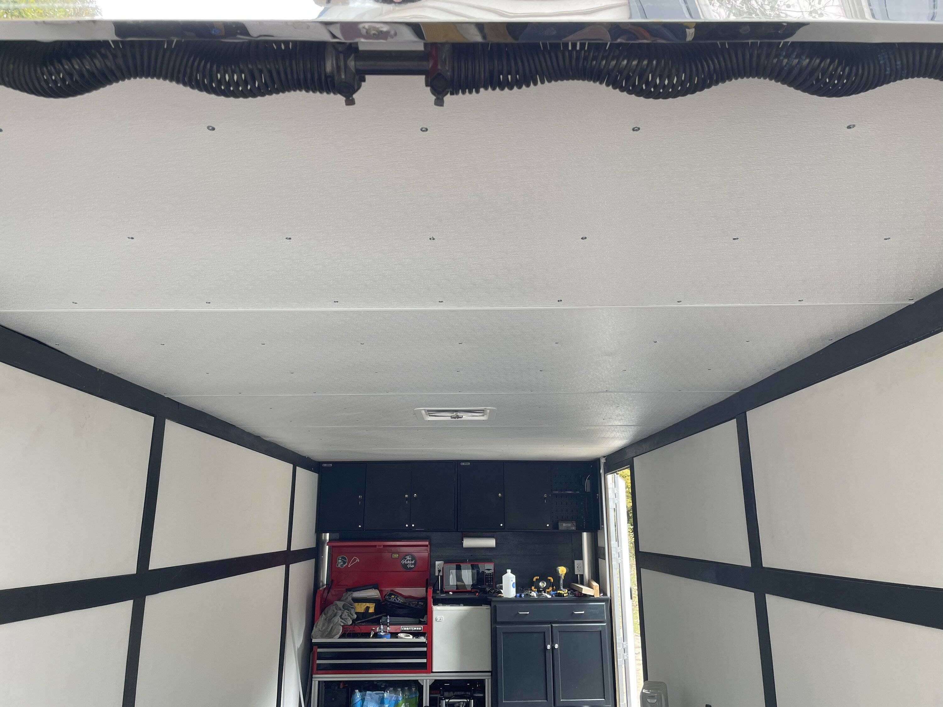

I have added flooring, wall FRP panel, insulated and paneled roof, installed Shore power, cabinets and permanent tool chest, LED lighting and EZ Track.
I now stay in the trailer for weekends, Queen blowup bed, microwave, Fridge etc.. no more paying $150+ for hotels that I spend 8 hours per day in..
Let me know if you have my questions.?
