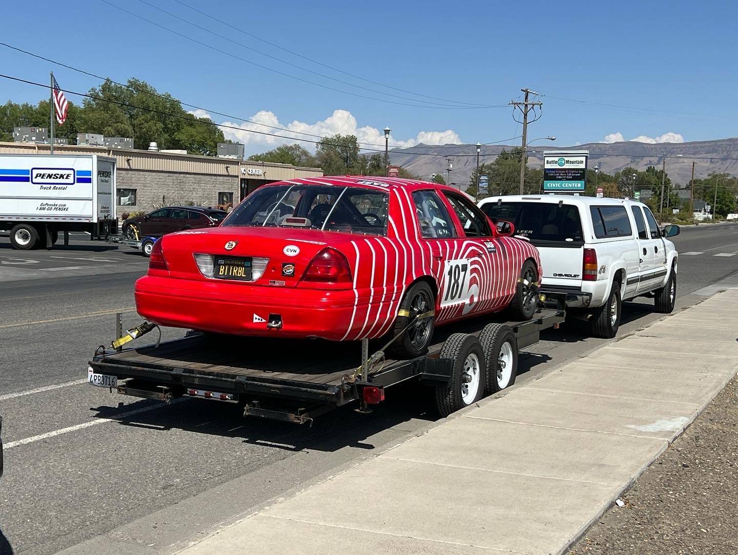

Obviously cost is always a consideration, but in my opinion it’s all about approach angle and features. My buddies and I have been searching for a trailer for a little while. We currently tow our “race” car with a borrowed trailer from a friend. The approach angle is too steep, and loading and unloading is a horrendous pain in the ass.
We’ve used wood cut offs, ramps, etc to help, but we have to be careful not to hook the exhaust flanges when the car is half way on/off.
Again, just my opinion, but lower is better, as it helps keep the approach angle more gradual.
This is my CV which is 2” lower than stock, and still sits probably 1/2-1” higher than my Mach 1. We barely get this thing on and off the trailer (have to put 2x4 under the front tires to clear the exhaust, and we usually catch the front bumper cover on the ramps.) No way a Mustang Is getting on and off without damage.

I think that a tilt trailer will have a better approach angle than most trailers with ramps. Length will help with this equation also. The longer you go it should make the angle better.

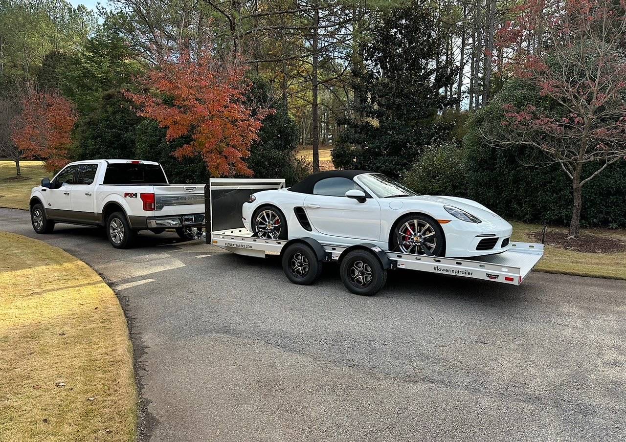

Bought a Futura SuperSport 16.5’. Towing with my F-150 with Max Load Package. So far have done 200 miles back from the dealer (empty). Since the Mustang is in the shop, once back at home, I loaded the Boxster to test the tie-downs and see how the weight was distributed. As she is sitting in the photo, trailer and car are about 4,400 to 4,600 lbs. My hitch has a scale and I positioned the car so there was 500 lbs of Tongue Weight. Before hitting the road I checked the tire pressure and found it to be 33lbs all the way around instead of the 55 lbs recommended. Filled all tires up to 55 lbs and the Tongue weight dropped to just over 400 lbs. There is plenty of room to move the car forward, but I didn’t want to redo all the tie-downs. Drove about 20 miles just to see how it handled. Very stable, good visibility. So far I like it ALOT. I know the Mustang will likely be 700-900 lbs more. Then based on the 10% recommended tongue weight, I’ll be slightly over the 500lbs limit Ford sets before needing a weight distribution hitch. Will only be slightly over the limit. So, not sure if a WDH will really be needed. Will probably go ahead and get a WDH. Comments? Let me know if there are any questions I can answer on the trailer. It’s very cool. Thanks!

When I first saw the photo I thought, wait it’s loaded backwards, that’s too much weight on the rear. Then I remembered the Boxster is mid-engine. :crackup:
Nice set up, really like the trailer.
